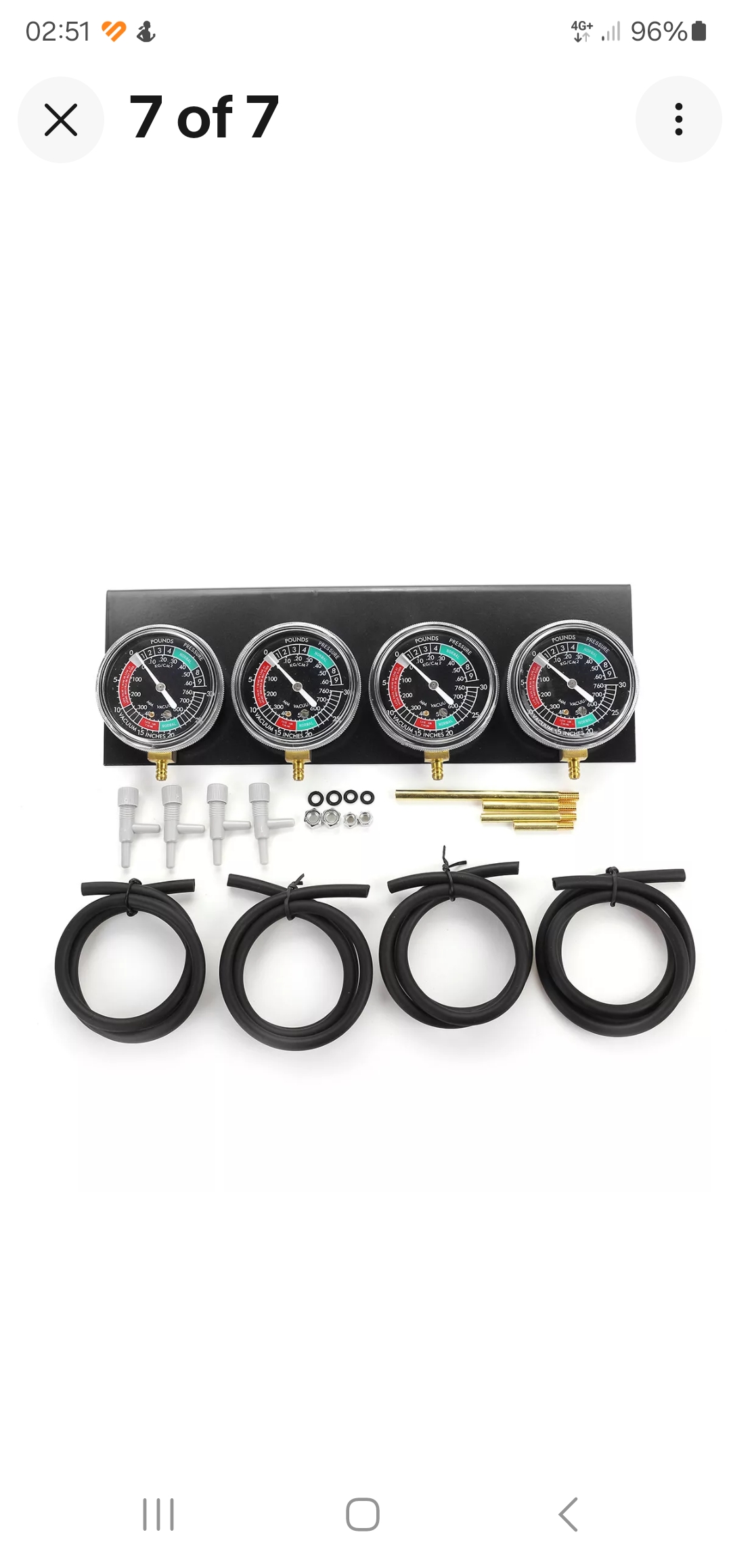

Hi Pete, thanks for reply, balanced slides on the bench seem very similar openings, however i bought a set of 4 gauges, unfortunately they are useless, so much flickering their effectively unuseable even with the adjusters almost closed, basically a waste of money.
Was hoping to get bike running reasonable then take it somewhere to get it done properly using a dealer with quality gauges rather then trying to guess whats good and whats not. I know carb ballancing makes a big difference to how it pulls and max power getting all 4 cylinders syncronised. But hoped the bike would at least run reasonable as is, alas it doesnt.
However judging by the many posts relating to bad running it seems to be a lot more common, or perhaps like me a lot of the owners struggle to get them running properly, due to lack of said knowledge?
What ive learnt on the journey so far is that 40 year old machinery, needs bottomless pockets and expert knowledge in vast quantities to allow that setting up to get any type of enjoyment from it.
Im sure other owners struggling probably feel the same, when all you want to do is ride it, instead your spending every minute in the garage just trying to get it running, in the hope you may actually get to ride it!
Re: Bike Z900 A4 not running correctly (Still)
What exact type/make of vacuum gauge did you buy ?
When you say the vacuum gauges were flickering, are there not adjusters on each gauge to dampen the needles ?
Usually there would be a knurled ring at the bottom of each gauge, where the vacuum pipe connects to, you would just turn this one way or the other until the needle on that gauge is steady.
Hi, Sorry no idea who manufacturer is, but advertised as suitable for all 4 clinder motorcycles. Appeared ideal and looked good too.
Came as a kit with 4 gauges on a steel bracket, and 4 lengths of hose, 4 adjustment valves and 8 brass ext nozzles.
When they arrived all were at def atmospheric pressures, so not great, but perspex covers were removed and all 4 set identical, using brass zero screw, Next cut small length of hose and fitted the valves then remainder of hose. Conbected each to take off on carbs, hung from garage roof over tank.
Started bike and adjusted valves, no matter how much i closed or opened the plastic valve, gauge swings was so erratic completely unreadable on all 4. So couldnt even use 1 on each carb at a time.
Gave up in the end. Clearly £39.99 igets you rubbish quality, but how are you supposed to know that,vive seen them at as low as £19.99 and up to over £100, i just assumed a mid price would work, correctly but perhaps not be as accurate, which as long as all read the same didnt matter, but not totally unreadable. Im talking 1/2 the scale deflections at tick over and above.
- Posts: 2152
- Joined: 3rd Apr 2009
- Location: leverington UK
Sadly those gauges are crap at that price, I have Morgan carb tune I bought in the early nineties, from what I've read on this whole thread your problem is your dyna and set up. You would also be better off investing in a morgan carb tune, old adage buy cheap buy twice.
