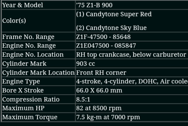

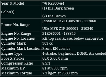

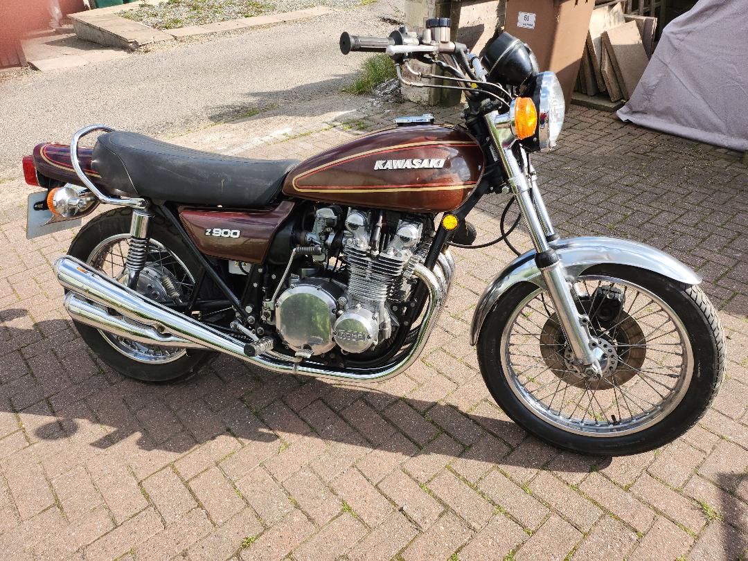

Can someone confirm what ive actually bought ? impulse buy but complete with only 17k on the clocks but the numbers dont match up its either a Z1b with a A4 engine or am i missing something?
Frame no Z1F504928
Eng Z1E097400

US A4.

Thanks thats put my mind at rest ,Phew thought id bought a bitsa.
