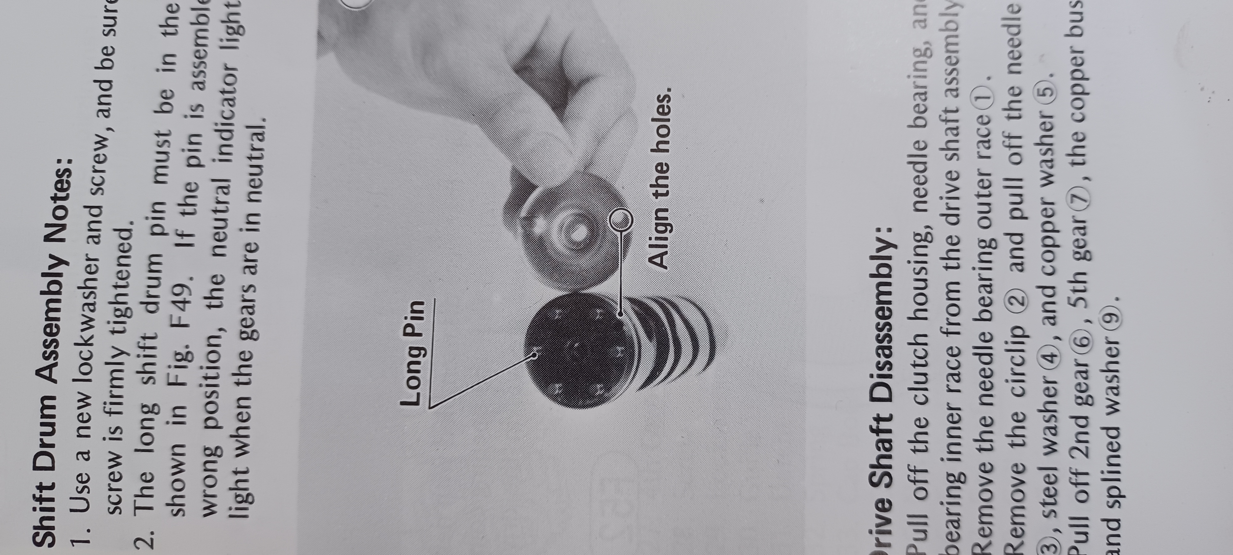

Reading through the kawasaki manual and refitting the drum selector ,
I noticed it mentions the neutral finder plate and that the longer pin
obviously sits in the neutral recess on the plate.
However it also says that the second hole in the plate should line up with the hole in the main drum itself.
My plate does not have said hole, and I can't really see what the two holes actually do anyway :) are they just to ensure correct alignment
I found a photo online of another A1 drum selector, and it's plate was the same as mine. No hole.
Apologies for the poor punctuation, doing this on my phone and it's not that easy :)
Thoughts appreciated!
