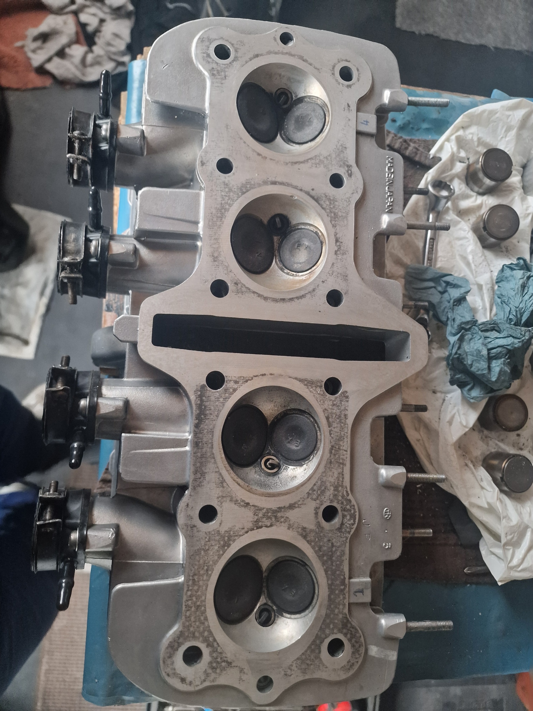

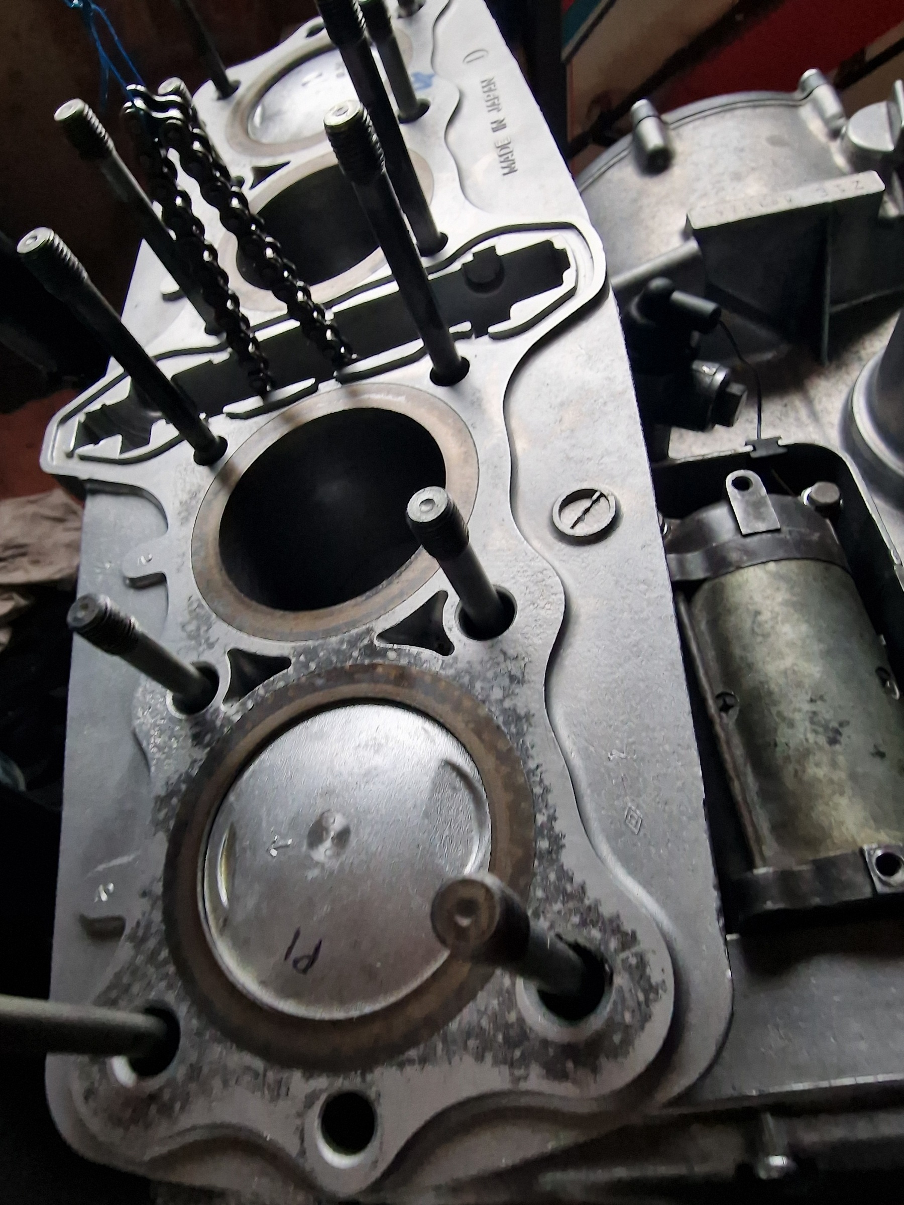

However heres a couple of photos of new pistons/head in place
