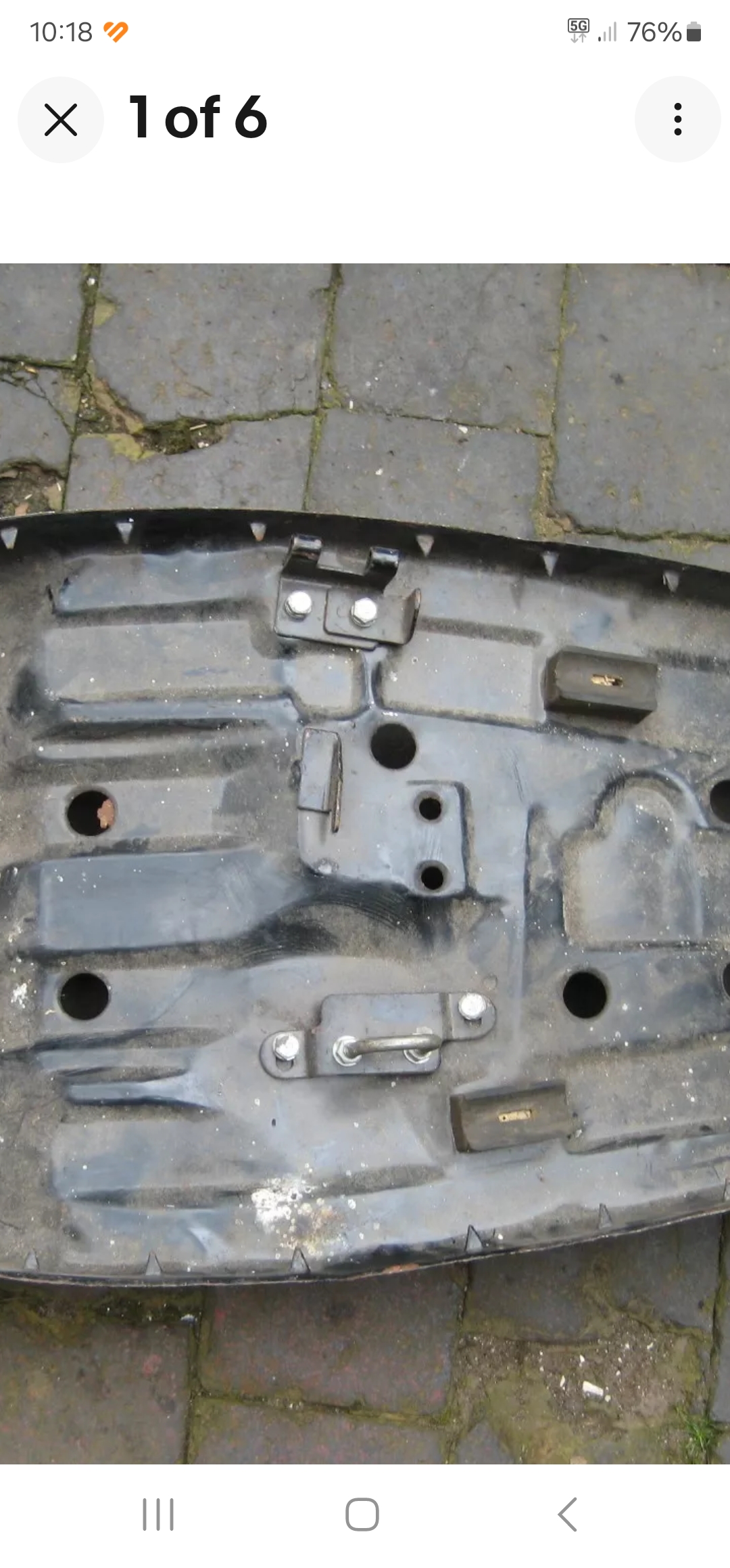

When i did my resto on Z900 A4 the seat was stripped down and blasted then powder coated, when i came to refit, it didnt have a lock or catch just a bracket with a long bolt and wing nut arangement so knew I'd need the proper assembly, which sounds the same as yours.
I bought the full lock kit and the correct plate which comes as stated with elongated holes and a u bracket with lengthy 6mm ends so it can be adjusted up down and in and out to suit using a double nut arangement. I had to fit the lock then temp fit the seat mark up the holes then drill them m6( nuts or 3mm if using tappers) then either use captive m6 nuts or self tappers to fix plate, re fit the cover and adjust as needed.
As yours is already built its up to you if you want to risk drilling base without going too far and damaging the cover or strip it, that way its more work but wont matter if drill goes too far. Suppose it depends how good you are with a drill and how long bit is? I tend to find you can be pressing on drill to drill hole then all of a sudden it goes through which can catch you out.

Thanks all for getting back to me - The base unfortunately doesn't have predrilled holes to fit an alternative arrangement so I'll have to work out the position of the catch and get some holes drilled.

Here is photo i used as guide when fitting bracket it helped to confirm its position, it may help you too.
