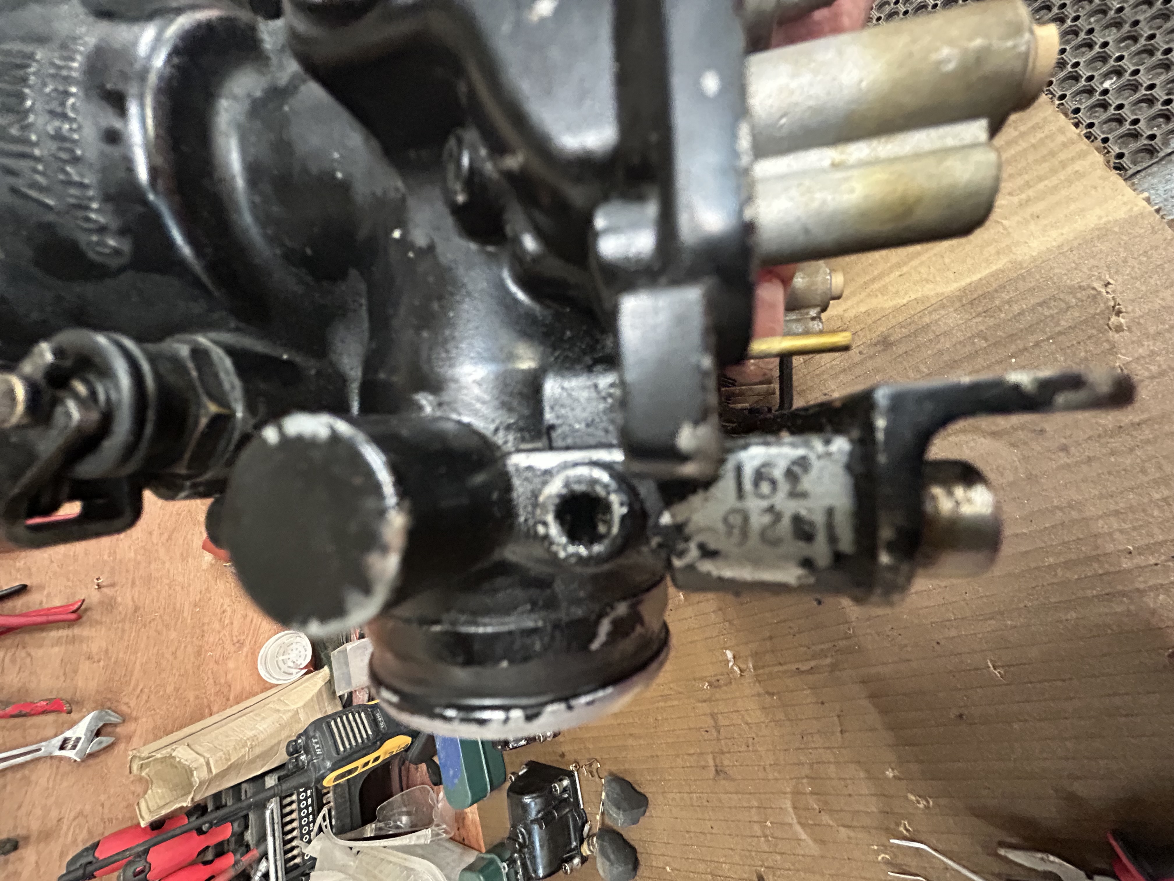

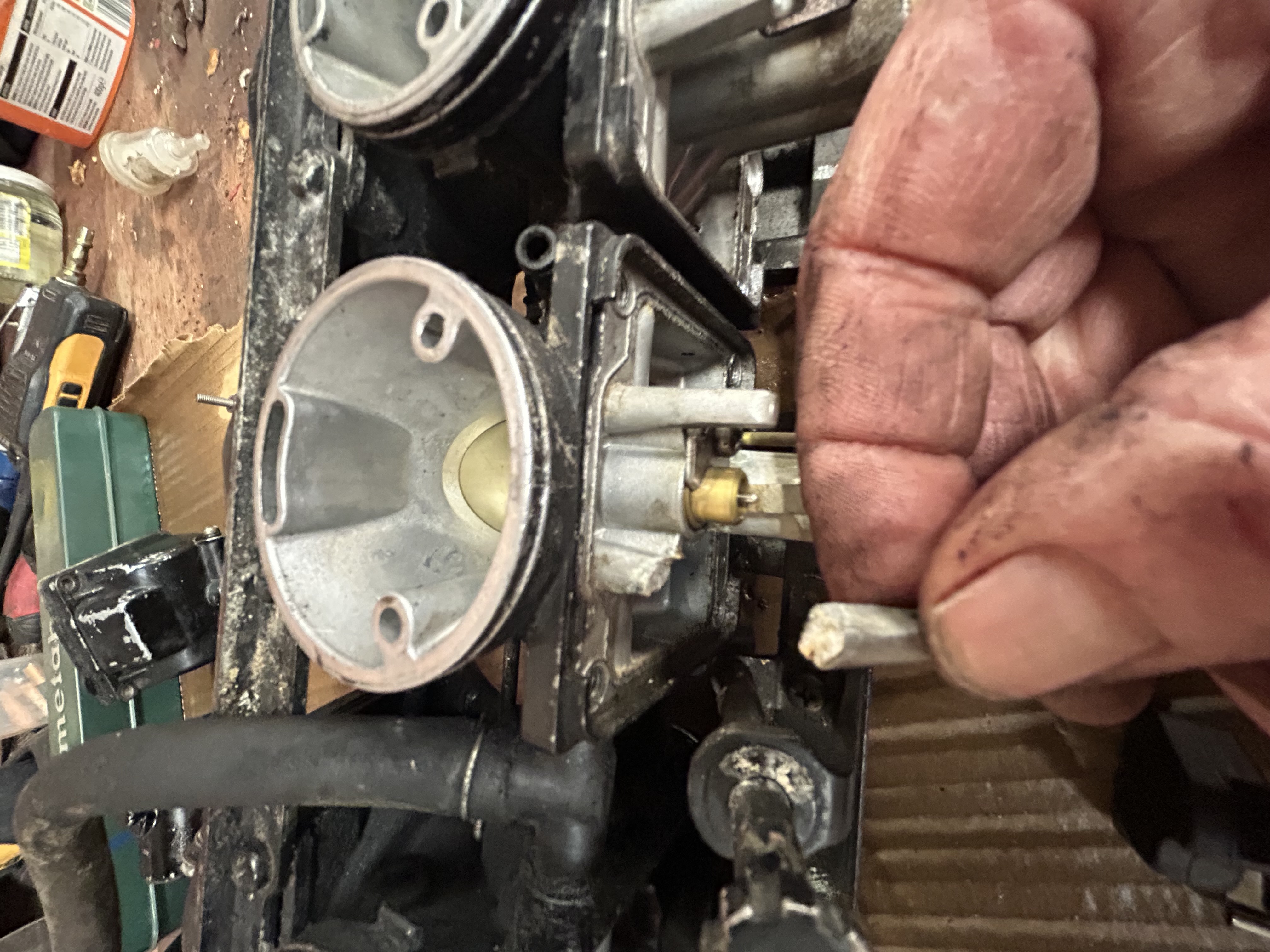

I finally got to strip the carbs on a 1100R It bought recently. No.3 was leaking intermittently. I presumed it was a float valve issue. When I took them off and opened the bowl it turns out someone broke the leg that holds the bowl in place and stuck it with glue!
So, what are the options? I presume a repair is out. Does any one have a body for no. 3 ( I don't think they are interchangable.) or will I need to get a whole bank?

You cold use liquid metal like epoxy resin thats supposed to be petrol proof and there is also some repair putty for petrol tanks on scumbay plus others, could build up quite a thick layer/blob around post, wont look too good though should do the job.
I would glue it with float bowl rod fitted to make sure it aligns ok when curing.

Thanks Zed 9, I’ll try get a carb, but no harm playing around with it in the mean time. Not like I can make it much worst!

I don't think any type of adhesive will remain stable in that environment. I think that drilling it and inserting an interference pin to secure the post might work but accuracy would be key to success.

Thanks Baff, I agree. I think I might have sourced a damaged bank with a good no.3. I don’t fancy Percision engineering/watch making at this stage in life!

I managed to get a bank of carbs for reasonable money. They are all pretty rough but no 3 body, which is what I want is ok. However on stripping and cleaning it appears some one stripped the slot head on the pilot jet. I don’t fancy drilling it and have had extractors break off before. So, I will try it as is. I sprayed break cleaner in to it and it does pass out the little vent on the air box side intake. Are these pilots generally the same size or do they vary. The main jets the original cards are 132, the mains on the donor are 122, so planed to swop all the internals. Is it viable just leave the pilot is place?

In the factory manual the pilots for Z1000J and Z1000R are both listed as 37.5. The Z1100R1 supplement in the later Unitrak manual says they are 37.5 also so you should be good to go. You could confirm the size by taking the other ones out of the replacement carb set and see what you have. Are the 'spare parts set' of carbs from an Z1100R1? Or are they a set from a J model. J model ones may have the large triangular (round with three screws) plate screwed to the sides with the coasting enrichener pump diaphragm under it!!!!! If ithey are they will also have four intake drillings in the atmospheric side (airbox) side of the bodies.
As to whether youre going to get away with not taking it out to clean it ~ is anyones guess but if you do have to eventually ultra-sonically clean them then that process is magic for loosening stuck stuff.
If you are spraying brake cleaner or compressed air through the pilot jet you need to confirm that it is coming out of the microscopic drilling in the engine side of the carb venturi. The hole is invisible until you see it working. You will also need to then take out the fuel mixture screw on the side and confirm that liquid or air comes out of that doing the same process with brake cleaner or compressed air! You may need to temporarily block off the air intake 'port' in the airbox side of the body as it is larger and will bleed from there rather than the tiny bleed hole where the butterfly valve touches down.

Great advice as usual. I forgot about the tiny hole. Unfortunately I put the carb body in the UScleaner and gave it a good run and it was nice and hot. That was before I tried take out the jet.. the damage was already done. The slot is gone. I was tempted to grind a small screw driver into a tapered square and try take it out but I would get 1 chance and 1 chance only so I think I will try it as is for now. They don’t have the three screw plate that are on the j’s( and R1’s Ithink)
