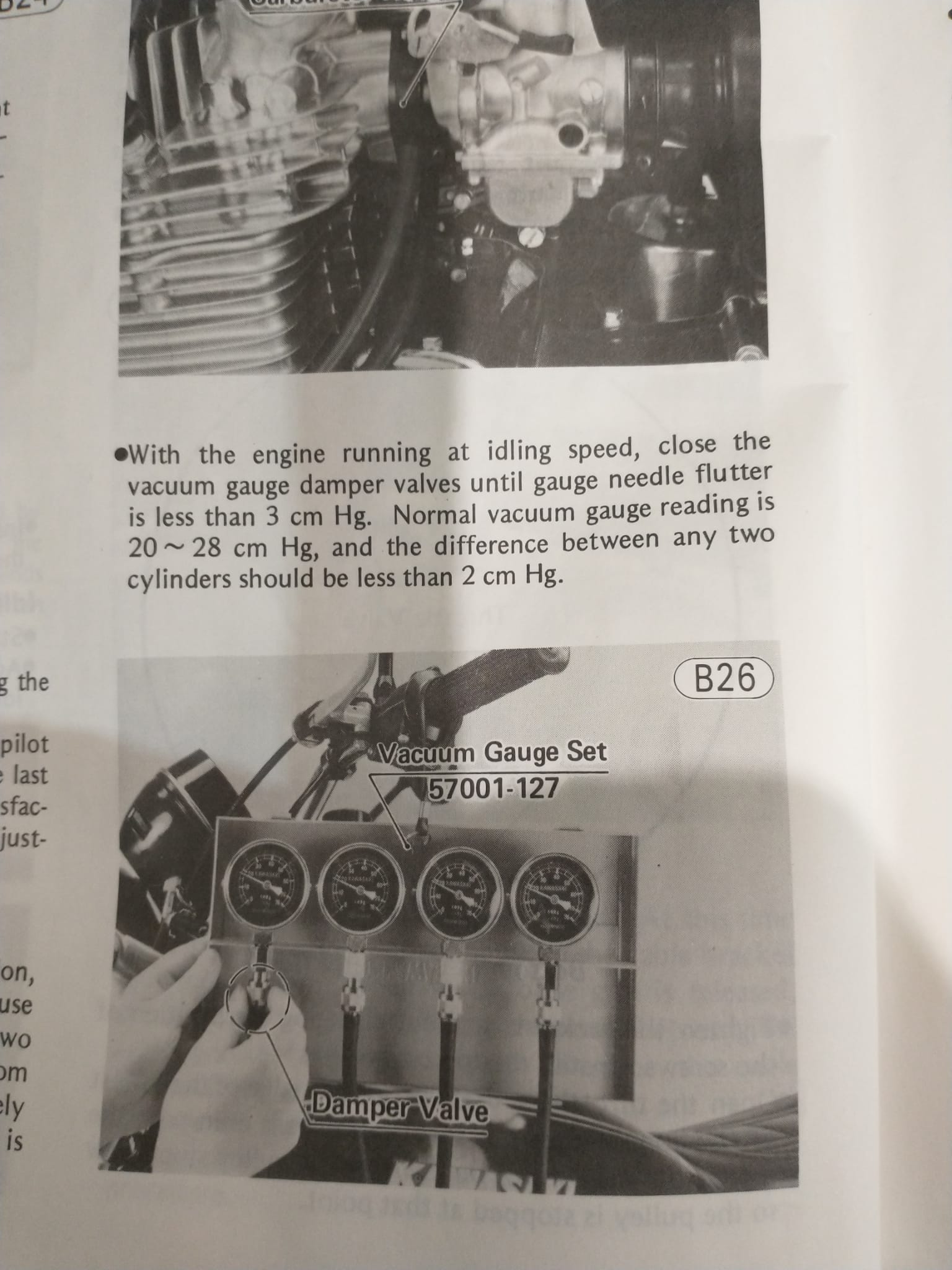

Hi Graham;
Re. your problem with flickering needles on your gauges - did your set come with a set of damper valves? They look like T-pieces but have a small wheel on them. They fit in-line on each of the lines between the carb and your gauges (you will have to cut the lines at a suitable point to fit them in). If you look on Amazon for 'motorcycle carb synchroniser' it'll pop up loads of examples with pics for a better idea. They basically restrict the airflow through the lines (by winding the wheel in or out) and reduce the flutter to a readable level.
If you haven't got them with your set, you can achieve the same result by using small clamps - even clothes pegs can work, although they are a bit awkward to get the right amount of 'squeeze' on the line. Hope you get something sorted for them.

Re: Z900 A4 fuel leak any ideas please?
Hello Graham, as Grog has stated you have to use the gauge valves to restrict airflow, i.e damp the needle movement. It is important though that the needles still flicker a little to get an accurate response/reading - don't overdo the airflow restriction. Ideally the readings should be within approx 2cm Hg of each other. Make sure the engine is up to temperature and blip the throttle between adjustments

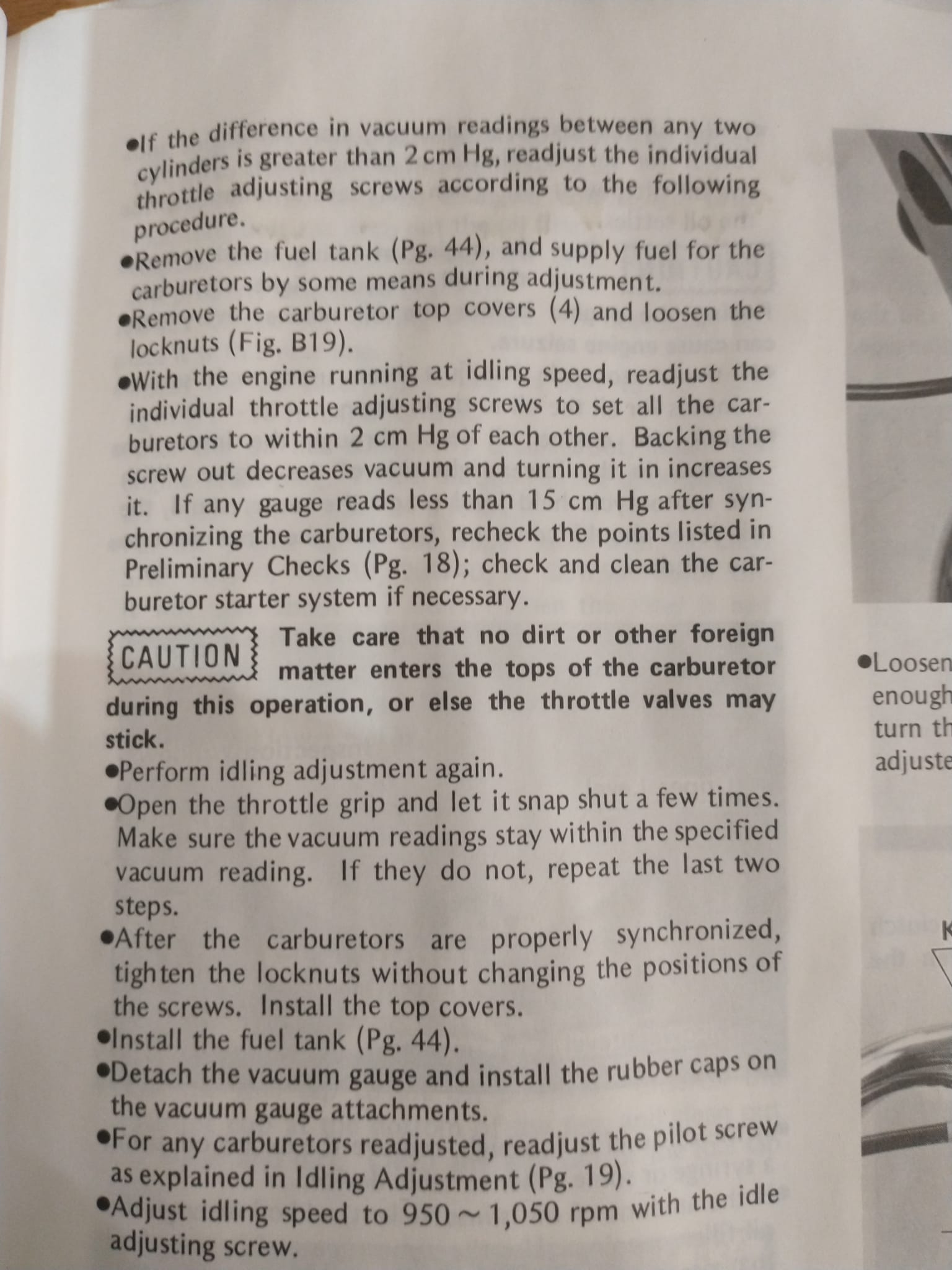

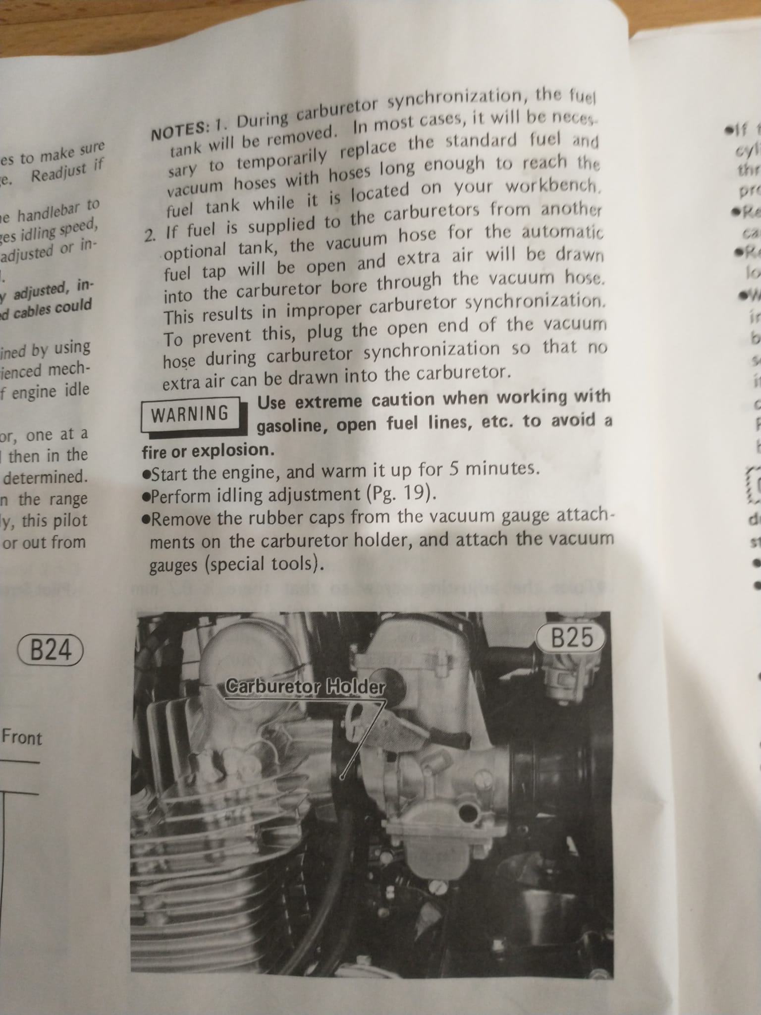

Graham;
Attached are pics of the relevant section from the workshop manual for carb syncing. The pics also show you where the damper valves go. Ignore the brass pipes that came with the kit, you don't need them. Cut the rubber pipes that you have a shortish distance from one end. Attach the short bit - one end on the gauges, the other on the damper valve. Then the long pieces you have left attach from the dampers to the carbs. You'll be good to go then. As sean said, you need a bit of needle flutter (see instructions from the pics) but the dampers will make it manageable.

Graham, we spoke about the needle dampers when you called me yesterday
