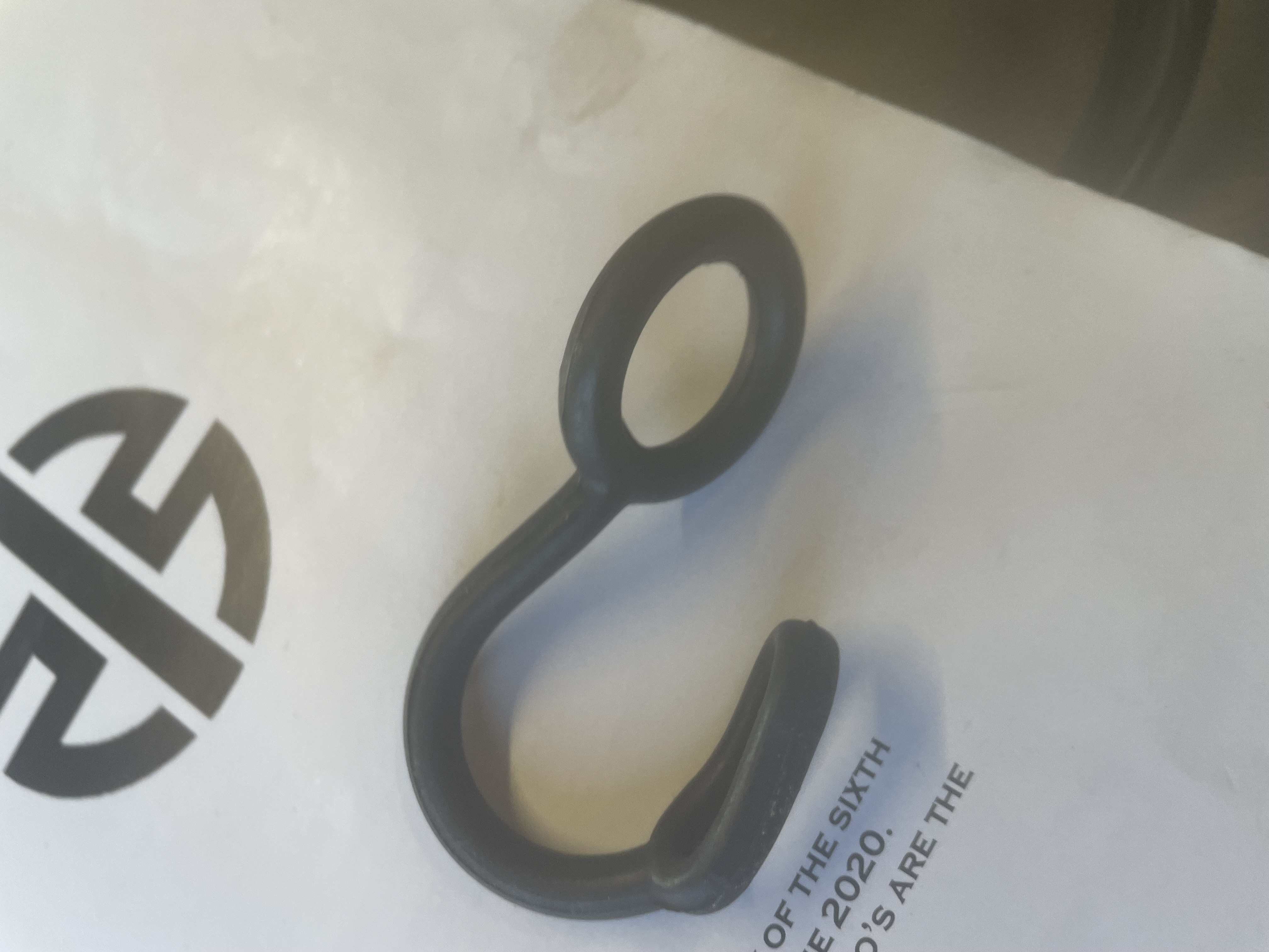

Can anyone tell me please how and where this fits on a z it’s for the 4 carb overflow lines

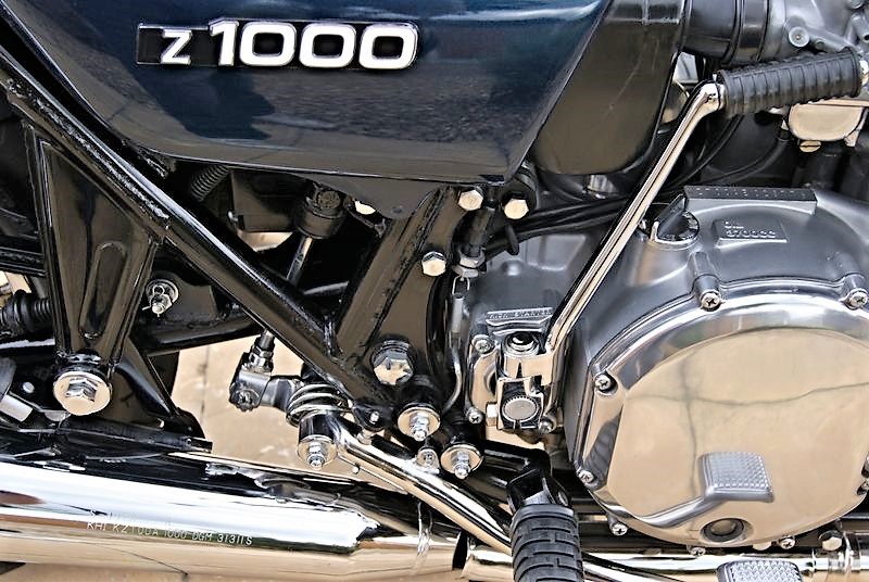

From memory (if it's the same as the Thou), the rubber fits on the top engine mount and the 4 overflows go through the other end of the rubber and down behind the block...
You can just see it above the kick start to the right of the brake switch nuts on my old 1000...

It loops around the right hand engine mounting bolt collar. The 4 overflow pipes go through the round ring and are guided to the back of the engine. Hope that helps !

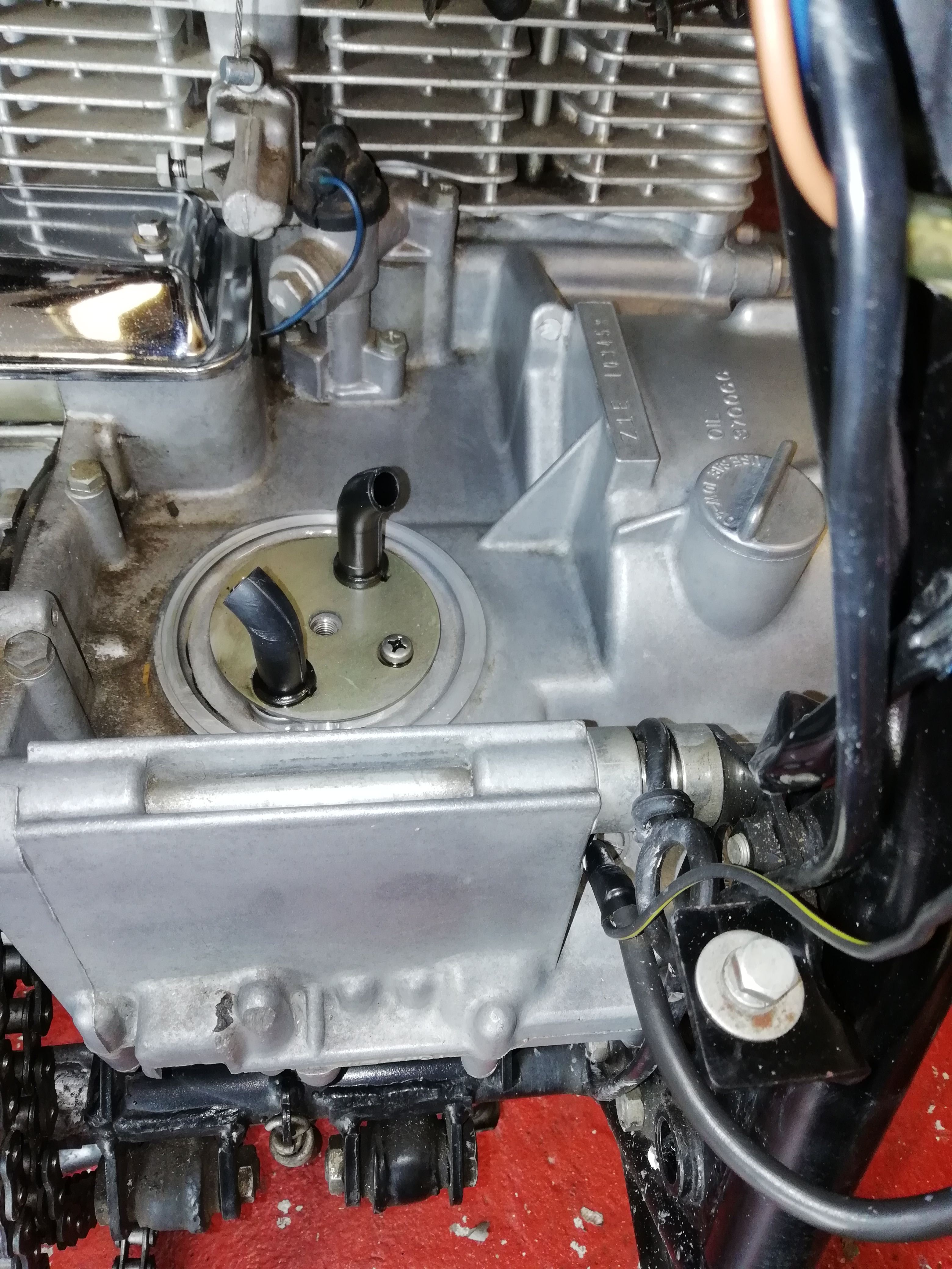

#4 PostAuthor: Ultim8pc » Tue Jan 09, 2024 2:13 pm
Here you go:
