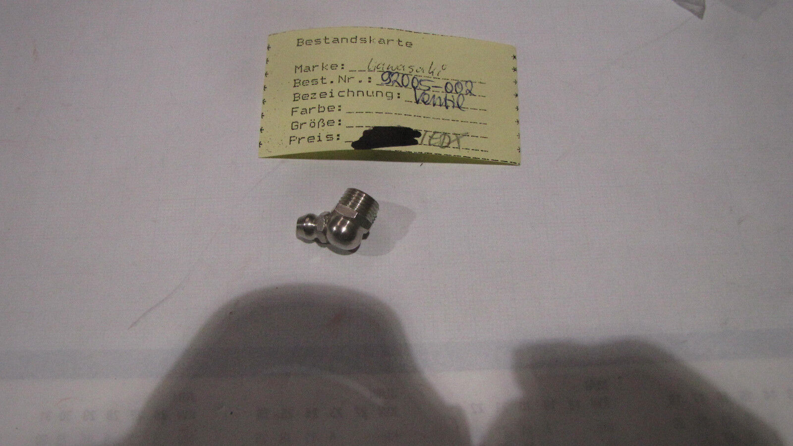

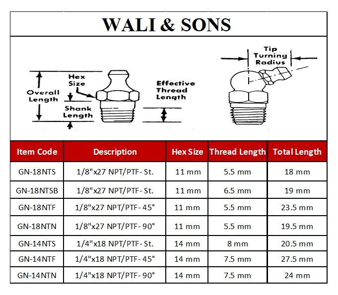

The Grease nipple on my Z1B is M10 ?
How do you know that the grease nipple comes from WALI & sons.
Found this on ebay

Think only b s p threads are tapered

Dealt alot with lubing nipples and tapered pipe fittings in my aviation experience. British BSP and American NTP are tapered and taps are readily available for both. Not seen a tapered metric threaded grease nipple as yet.
