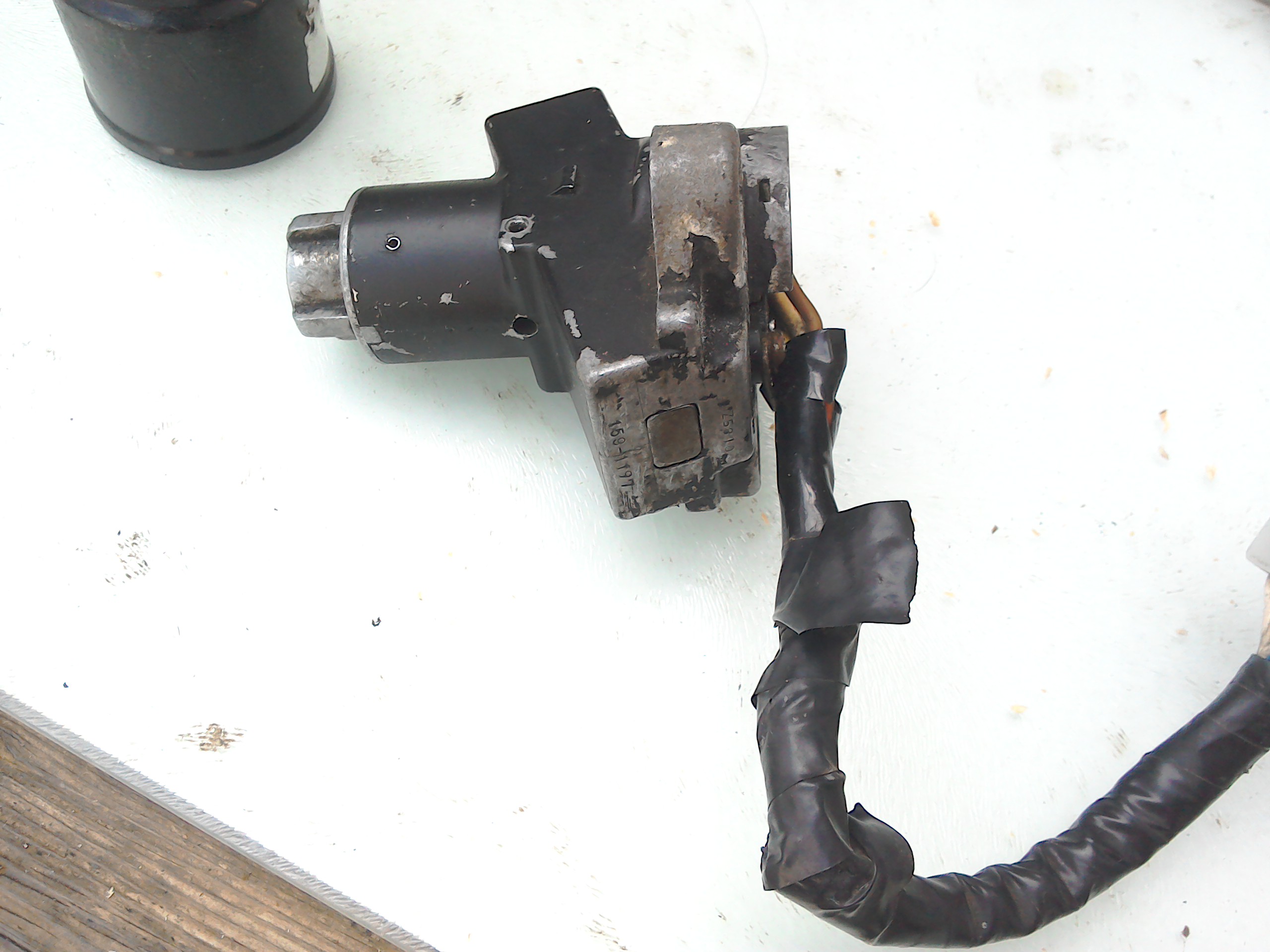

I need a replacement ignition switch as the barrel is very badly worn this is the 6 pin and I bullet type the only numbers I can see on mine are the key number and 159-1f97 seen 27005-5047 as a replacement but contradictory information if it fits or not can someone confirm or give a part number?.

If you could have a look this is what my old one looks like

That looks suspiciously similar to an 81/82 1000 j1/2.
If it is then they are unobtainium. Lots of places list it but the stock they have doesn't fit as its an 83 model and totally different shape.
I spent a couple years trying to find one but never did. Closest I got was a Vulcan one but ended up taking the tumblers out of it and putting them in the J body.
Good luck trying to find one.

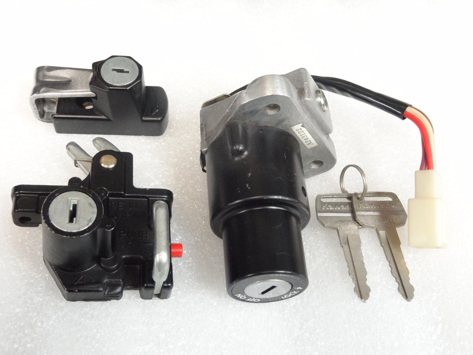

The IGNITION SWITCH ASSEMBLY is down as 27005-5009 but if you do a google on it there seems to be quite a few dodgy supposed replacements but..
The OEM full lock set is listed as 27004-5033 but with a heafty price at US $299.99 ebay link below but doesn't look the same.
https://www.ebay.ca/itm/231819359124?ep ... SwKtlWk-WQ
You might be lucky and one of the lads might have one knocking about.

Unfortunately that list isn't right. Trust me, I spent a loooong time trying to find the correct switch. J3, Some J2, ELR and the majority on that list, possibly all, are the ones that WON'T fit.
Thats the one I had to pillage the parts from to fit my J2 body.
The difference is subtle but enough to render it useless.
This is assuming your St and my J2 switches are the same of course.

It was a few years ago that I did mine and if I recall correctly it was all down to the way the steering lock deployed.
Kawasaki parts diagram shows two different types of ignition lock for a j2, the original on mine was a cross between the two.
After much research and trawling the kz and J forums I did track mine down to being the same as used in a Vulcan but I couldn't find one using that as a search either.
Rather annoyingly the khi parts diagrams don't show the ignition for a ST
