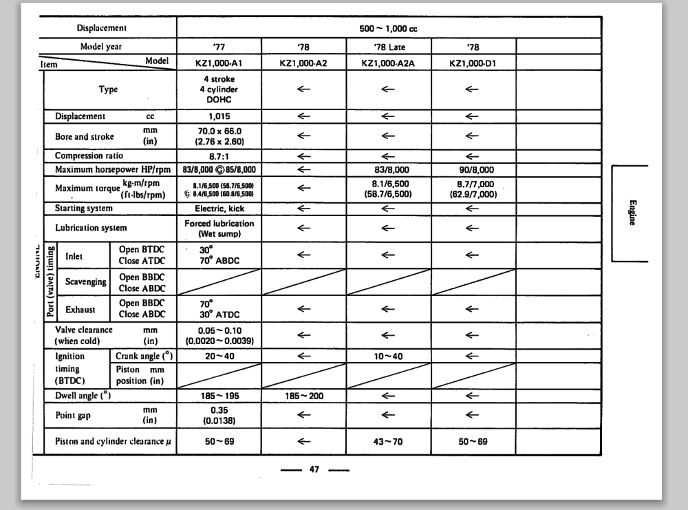

Can anyone tell me please the points gap and correct timing mark for a 1978 Z1R D1 engine please

From the Kawasaki spec manual, but others may advise for the better.

Yes great for points gap but do I use the firing mark F for static timing

Yes
