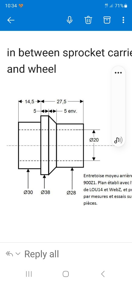

I have had my own issues with rear axle and spacers on my Z900 A4 heres a photo Zpower sent me of spacer, also if you read post on axle issues theres a few more dimensions posted
Hope that helps
