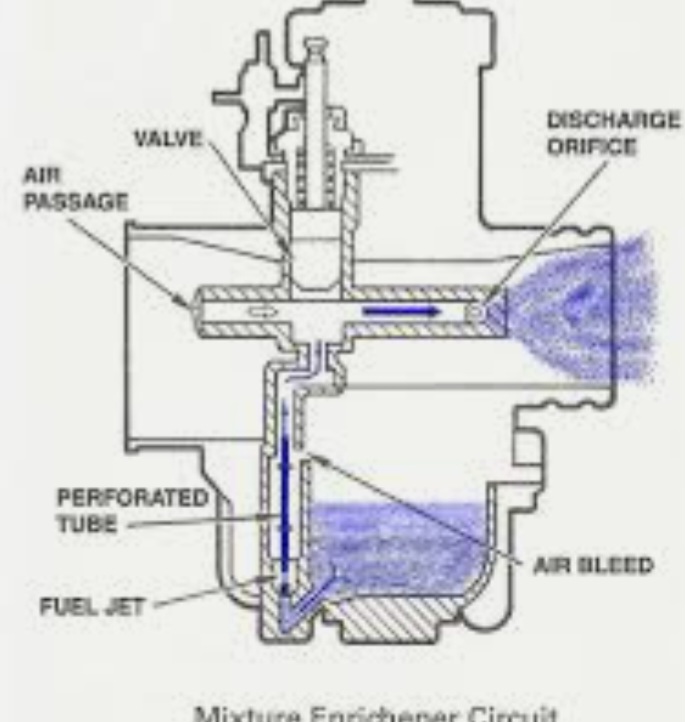

Just out of interest guys, aren't the choke plunger seals controlling air? If so then wouldnt leaking seals make for leaner running?

:D If you find that twiddling the air or fuel screw does not have much effect on the mixture strength showing up on the colourtune, it could be that the idle circuit is being overwhelmed by the choke plunger seals leaking. 3/4 of a turn on mine which are fuel screws, takes it from one extreme to the other.

Stagman wrote:Just out of interest guys, aren't the choke plunger seals controlling air? If so then wouldnt leaking seals make for leaner running?
No! The choke plungers provide a rich mixture for cold starting.
The seals shut off the fuel supply when the choke is closed.
When the seals are worn and leaking ( which they all are if original ) they cause rich running , sooty plugs, low mpg etc etc.
Screenshot_20230704_094444_Samsung Internet.jpg (83.24 KiB) Viewed 2507 times
