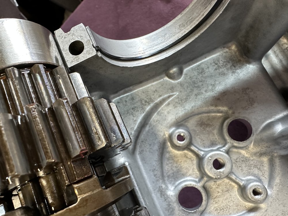

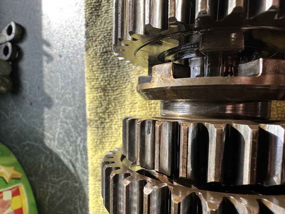

So I started the engine re-build today and while checking the gearbox clusters I see damage on the teeth of both 5th gear cogs, first question, is this a common issue? second question am I likely to find a decent pair of gears? anybody on here got some by chance?? I'm kicking myself because when I stripped the bike I found the gearbox main shaft bearing broken up and should have checked the clusters then :roll: Pictures attached to show the extent of the problem.
I am not confident doing the strip of the clusters myself so ideally need somebody to do the rebuild of the clusters and fit the new bearings too. Anybody able to help please.

#4 PostAuthor: zed1015 » Fri Mar 17, 2023 10:26 pm
PhilMill63 wrote:So is this something the 900 is known for?
No!
It's just high mileage or infrequent oil changes , hard use etc etc..
