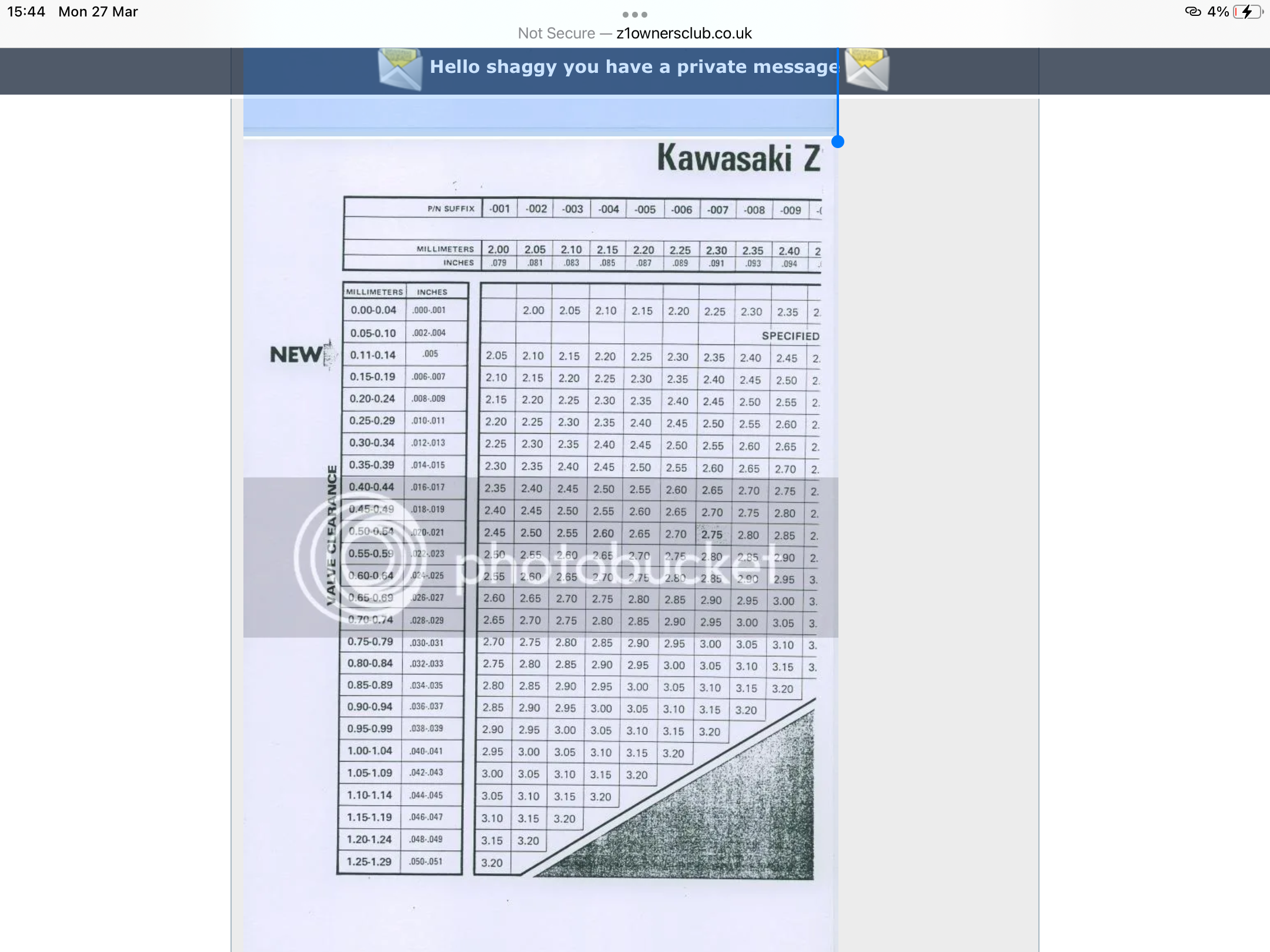

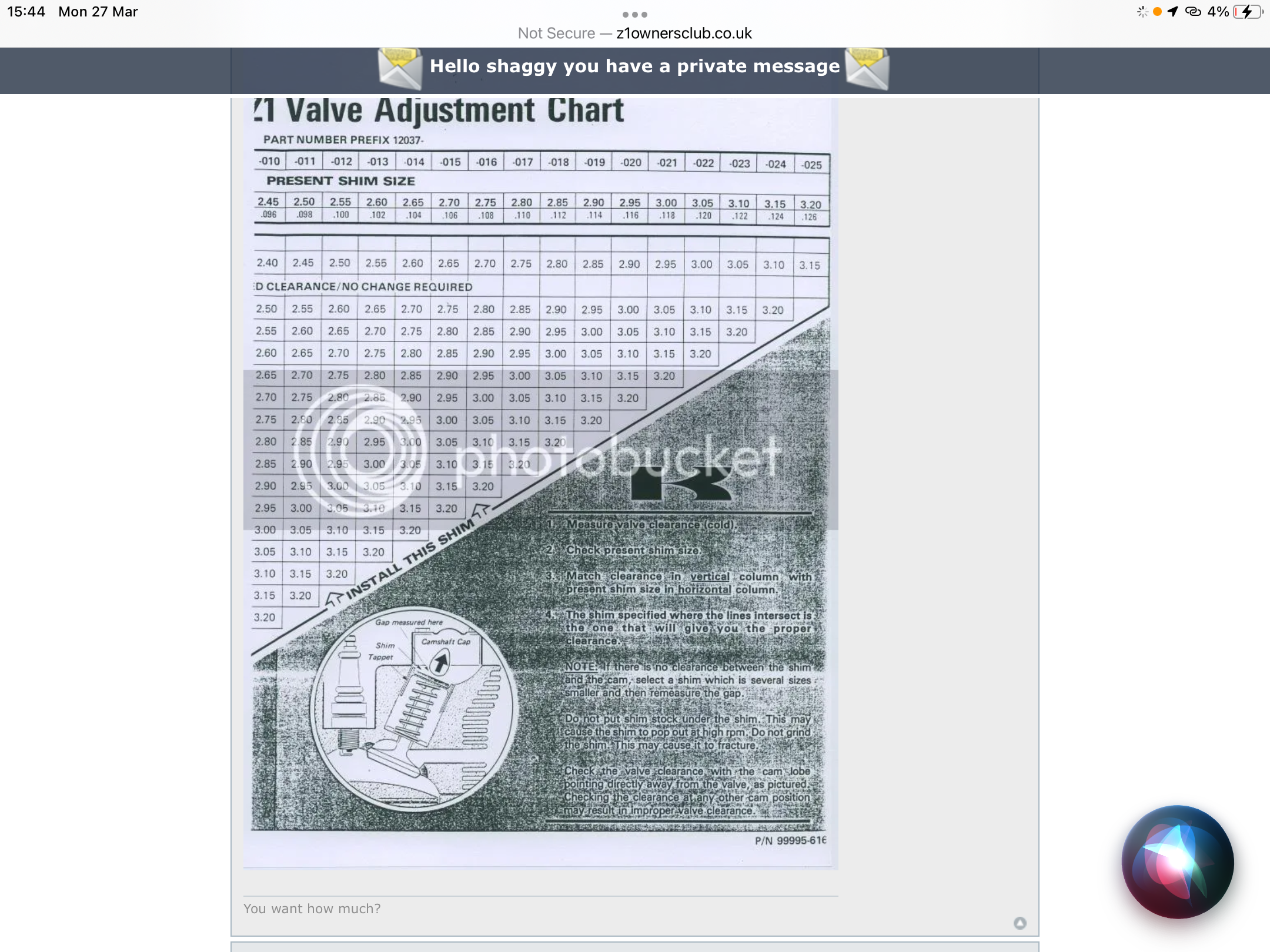

#3 PostAuthor: shaggy » Mon Mar 27, 2023 2:46 pm
Bit confused as went by this chart which is on this site
Posts: 4036
Re: Camshaft shims
#4 PostAuthor: zed1015 » Mon Mar 27, 2023 3:55 pm
The clearance on the early Z1's was first specified at 0.05mm to 0.10mm but was quickly amended due to instances of valve burning, especially on the exhausts.
The amended figures are 0.10mm to 0.15mm and should be kept as close to the high end as possible when re-shimming.
If you have clearance of 0.11mm - 0.12mm it's best to go with the next thinner shim and a clearance of 0.16mm to 0.17mm etc .
Either that or re-check and re shim after the bikes been run a few miles as the valve train will settle and the clearances will close up especially when the seats and valves etc have been re-cut.
