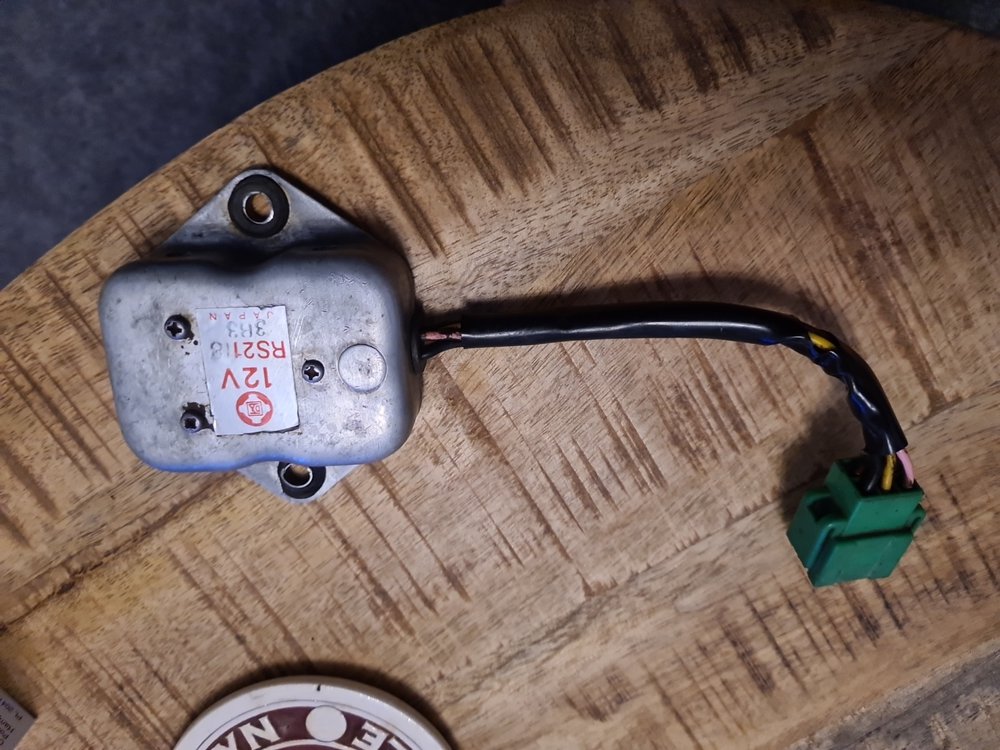

Mine also still has the original, voltage regulator and rectifier although arguably not in as good condition as your photos show, have tested it all on the bench using multimeter, however until its installed in the bike and got engine running its impossible to say how the components will perform. I'm all for originality where possible but where reliability is compromised i will replace with a combi unit. To keep it looking correct i will utilise the existing connector and mounting place. I know from previous posts the rectifier and voltage regulator were problematic, unusual for japanese made components as their usually ultra reliable, obv not in this case.

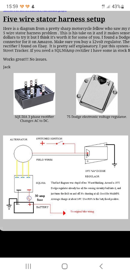

That site has some good info on it, the only thing im not sure of according to the wiring schematic the voltage reg senses the voltage and turns the field coils on and off to the Alternator thereby turning them on and off rapidly to maintain the desired voltage. Not sure if the Kawasaki alternator field coils are voltage excited or self excited if the latter then that arange
Screenshot_20230325-155917_Samsung Internet.jpg (93.57 KiB) Viewed 2641 times
ment wouldnt work, you would need a diff method to interrupt the self excitation to turn coils on amd off to create regulator.
That rectifier does 50A way more then the original, although it wouldnt look anything like it so purists may not be impressed.
