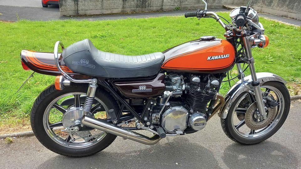

BTW does anyone recognise this bike , the current owner has no idea of the history but someone has done a nice job on it.

Thanks for the meaningful reply Chris, I'm glad you knew what I was trying to get at. It would appear that the 1000 Ltd and Z1/900 have very similar rear droppers (wider angle wise) as I've previously tried looking at different model diagrams etc but nothings clear and I wasn't sure if mine had been chopped and modded. I'm pretty confident that if I spend £460 on the exhaust, then it's going to fit now. By the way that seat looks well, I've tried and tried to get a decent twofour/ guilari but to no avail. I got a ELR from zed power but it's not the late 1970s same.

To be honest the Giuliari is one of the things on that bike I don’t like, I think a slightly cut down standard seat looks better. The bloke is actually talking about changing it for something like that.
