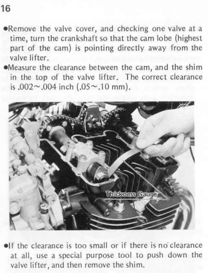

Hi Guys
Got my Z1 head back from the guys at head work Warrington. I told them to set the clearance to 0.002 as it shows int the Haynes manual. But after all the work done and running for a while the bike starts with plenty of power from cold but when she warms up it drops to 3 cyls and really lacks power. I've balanced the carbs, new plugs etc great spark etc.
Im wondering if there might be a typo in the Haynes manual. What thou or mm should they be please

Re: Shim tolerance
Haynes make an error, surley not
From the khi manual but even that was corrected after the first edition to 0.08 to 0.18. I would rather be 0.2 than 0.15
You can download a kawasaki workshop manual from Z power foc.
[attachment=0]Screenshot_20230713_181329_Samsung Notes.jpg[/attachment]

Re: Shim tolerance
Mikekilbride wrote:Hi Guys
That 2 thou is too tight.
They need to be set at 6 thou ( 0.15mm ) from the start.
4 thou ( 0.10mm) is MINIMUM clearance and should never be set at that.
2 to 4 thou ( .05mm to .10mm ) are the old figures which were quickily revised due to instances of valve seat burning..
Once set on a fresh valve job the valves will settle in their seats and the shims will need re checking after a few miles .
You will need to re shim the head with shims at least two sizes down from what is currently installed.

Re: Shim tolerance
warren3200gt wrote:Haynes make an error, surley not![]()
Thanks for this Mike
This old GIT keeping the old "kawi's" rolling 5 x Z1's. 3 x 72' H2's. 2 x 73' H2's. 2 x 74 H1's. 1 x 71 H1. 1 x W1 and finally 2 x 69' A7SS
Re: Shim tolerance
Mikekilbride wrote:warren3200gt wrote:Haynes make an error, surley not![]()
That 0.18mm was for the later GPZ1100 unitrack which has higher lift cams and sportier engine spec which consequentially produces more heat that results in a greater expansion of the valve gear.
It's a little on the wide side for stock cams in the lower spec 903/1015 engines.
It won't really do any harm but it will be noisier.
The revison for the 903cc/1015cc engines was 0.10mm to 0.15mm.
