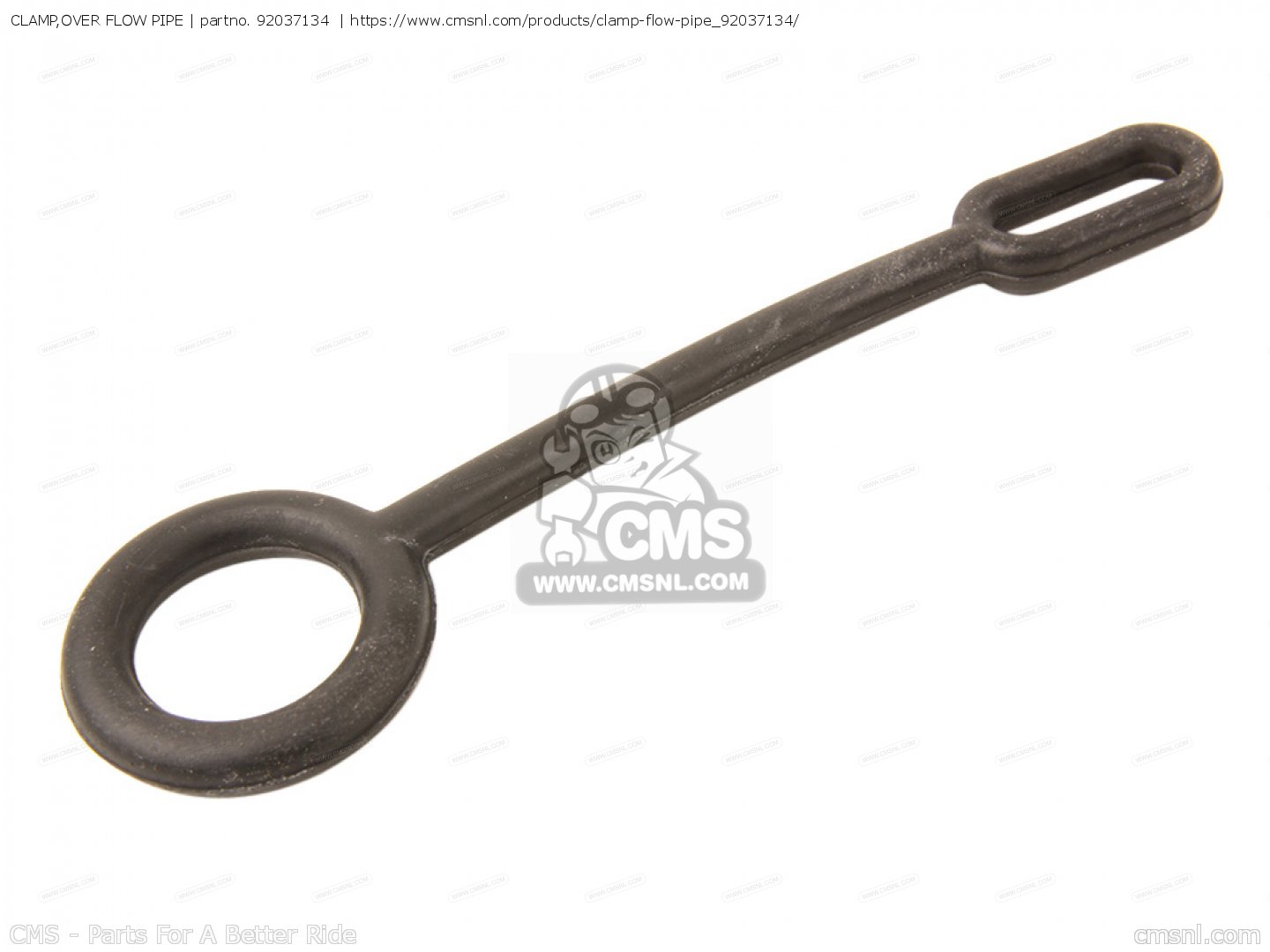

Can anyone tell me where the brake light failure relay mounts on a 77 Z1000
And where does the overflow pipe clamp gos. Photos would be a great help.
Re: Z1000 brake light failure relay
#2 PostAuthor: Ultim8pc » Thu Feb 23, 2023 10:44 am
The brake failure dongle fit onto a small, flat bracket which bolts onto on of the rear ignition coil mounting bolts.
See this image for the overflow pipe location. (top right of image). It wraps around the top rear engine mount spacer on the RH side.

#3 PostAuthor: bigdjag » Thu Feb 23, 2023 2:36 pm
Thanks Ultim8pc I always wondered where that rubber band went :D
