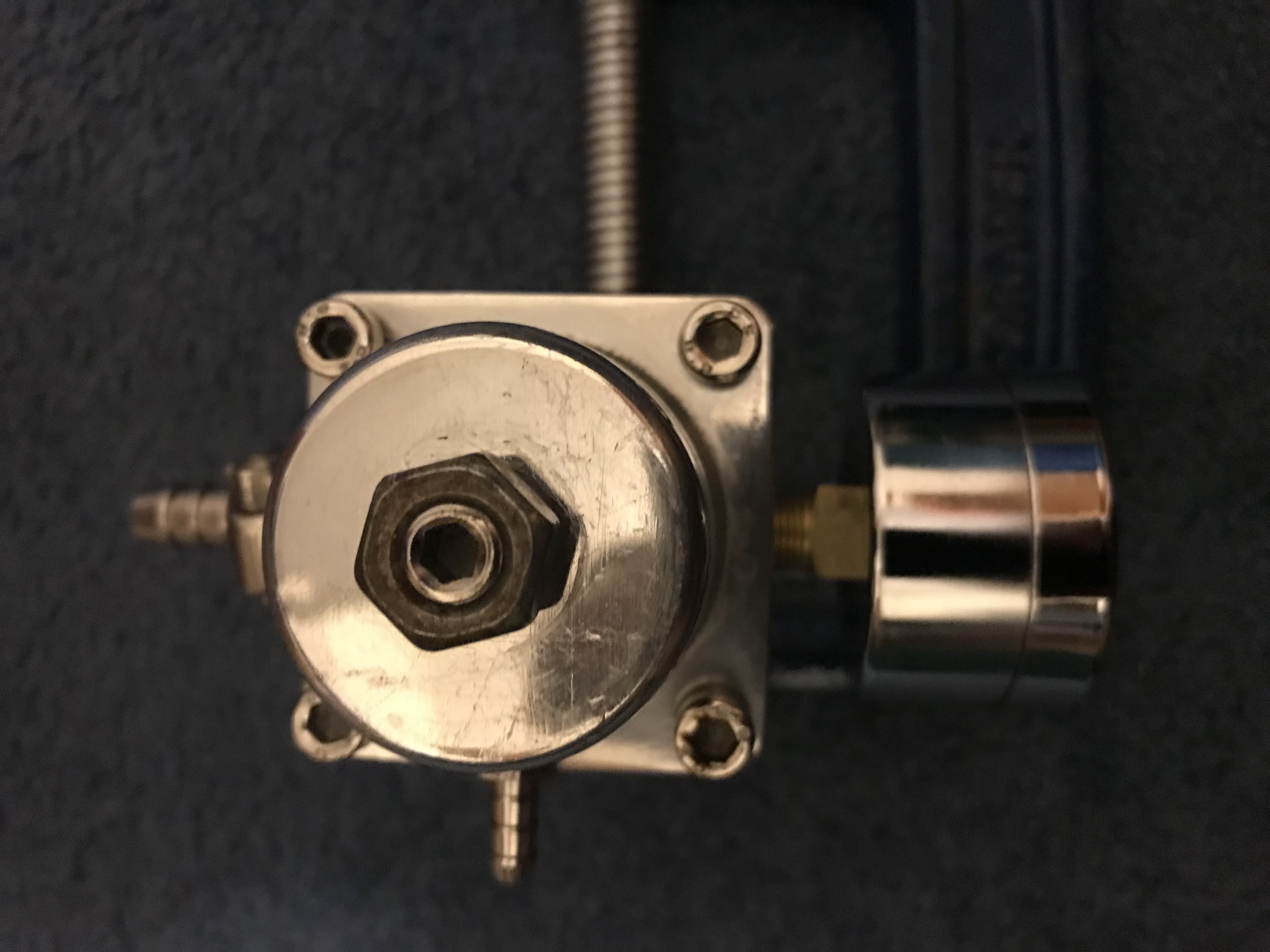

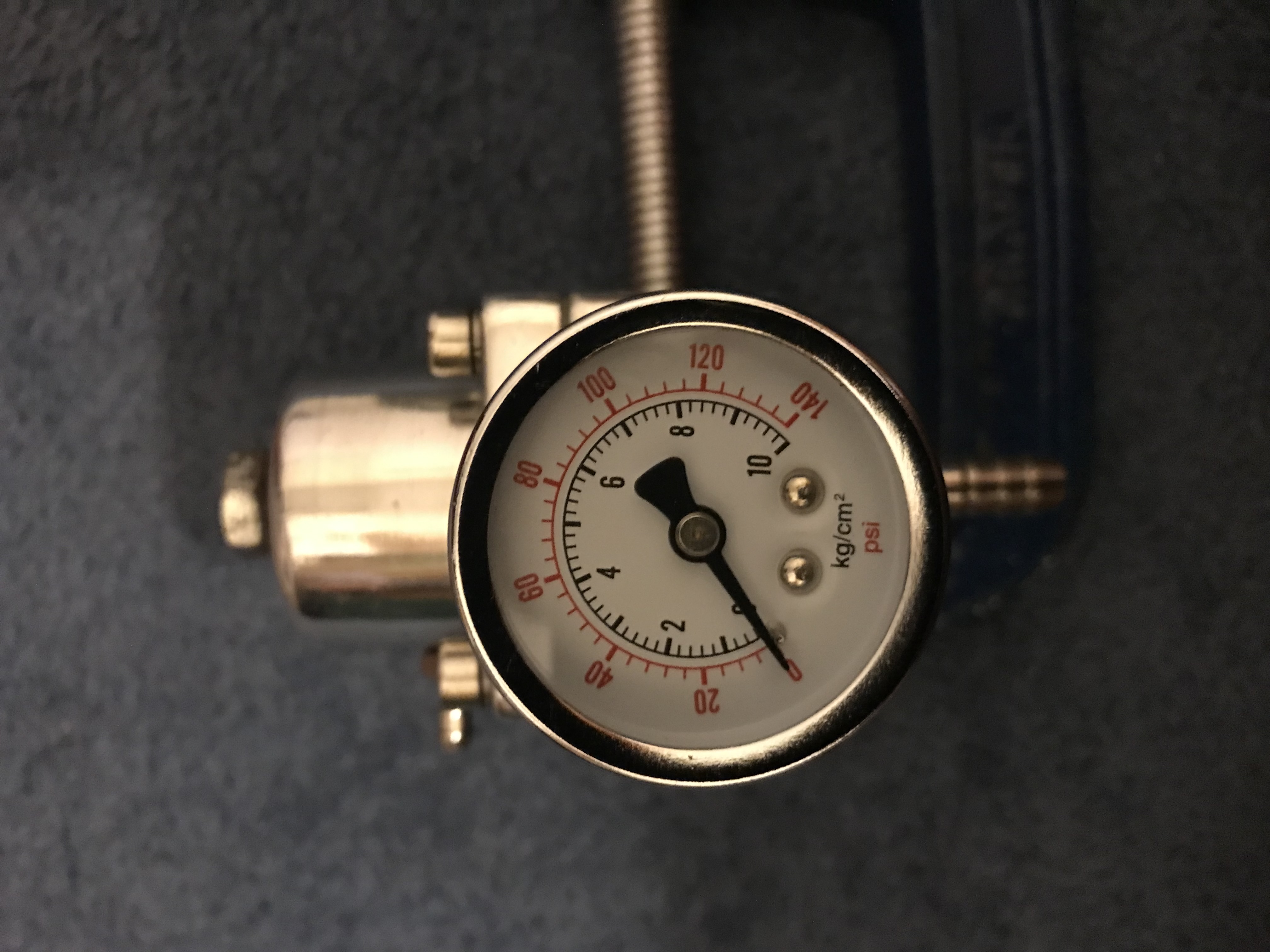

Hi mate,
Just saw your post. I bought an adjustable regulator a while back while trying to sort out issues on my Z1000H. it worked, and was adjustable, but didn't solve my problem. If you search for it on eBay you'll find it - finest kit from China, £35. It appears quite robust, and fits relatively easily. The resolution of the gauge is pretty 'hit-and-miss', but it might provide a few hours entertainment. Beyond that, 'standard' 2.5 and 3 bar regulators, as fitted to the old Lucas EFI systems are widely available, and probably from more 'reputable' suppliers.
