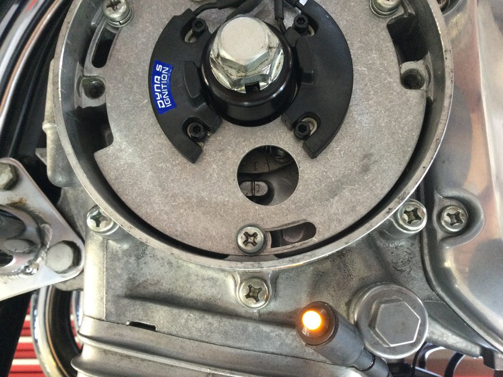

My first thoughts when removing the backplate was to check if it had any markings or stickers that would give any indications as to how it should be fitted.
The only markings that I could see where a set of numbers which had been (lightly) stamped. This mark was on the inside as fitted originally, but obviously transferred over to the outside when I flipped over the backplate.
I did have my run out to Matlock Bath - the bike ran like an absolute dream.
I was on the verge of convincing myself that it was carburettor or fuel related issues making the bike run so poorly!

I've just looked a 4 Dynas and 2 chinese copies and they are all set like the first photo in the thread.
If I put an advancer and rotor through the middle of the back plate between the pickups with the advancer showing at 1-4 F in the circular window the magnet is pointing to 1-4 pick up.
If i flip the backplate over with the advancer showing at 1-4 F in the circular window the rotor is showing at 2-3 pickup.
Surely this means the rotor was initially fitted 180 degrees out doesn't it?
The fitting instructions show it that way also.
I could be wrong
I have been before
Gus
I could be wrong
Gus

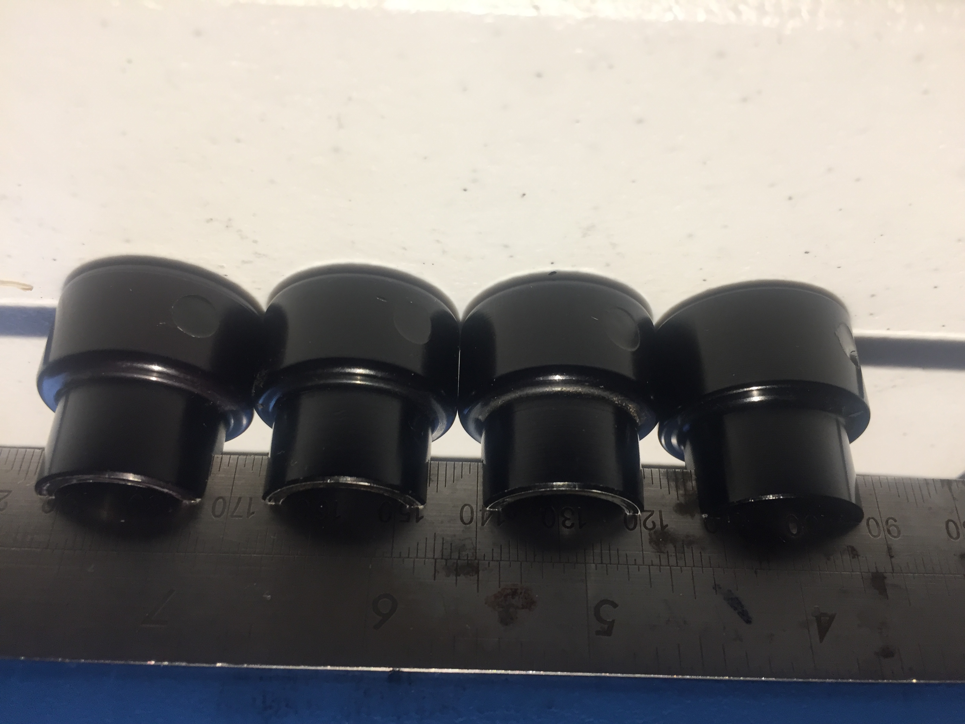

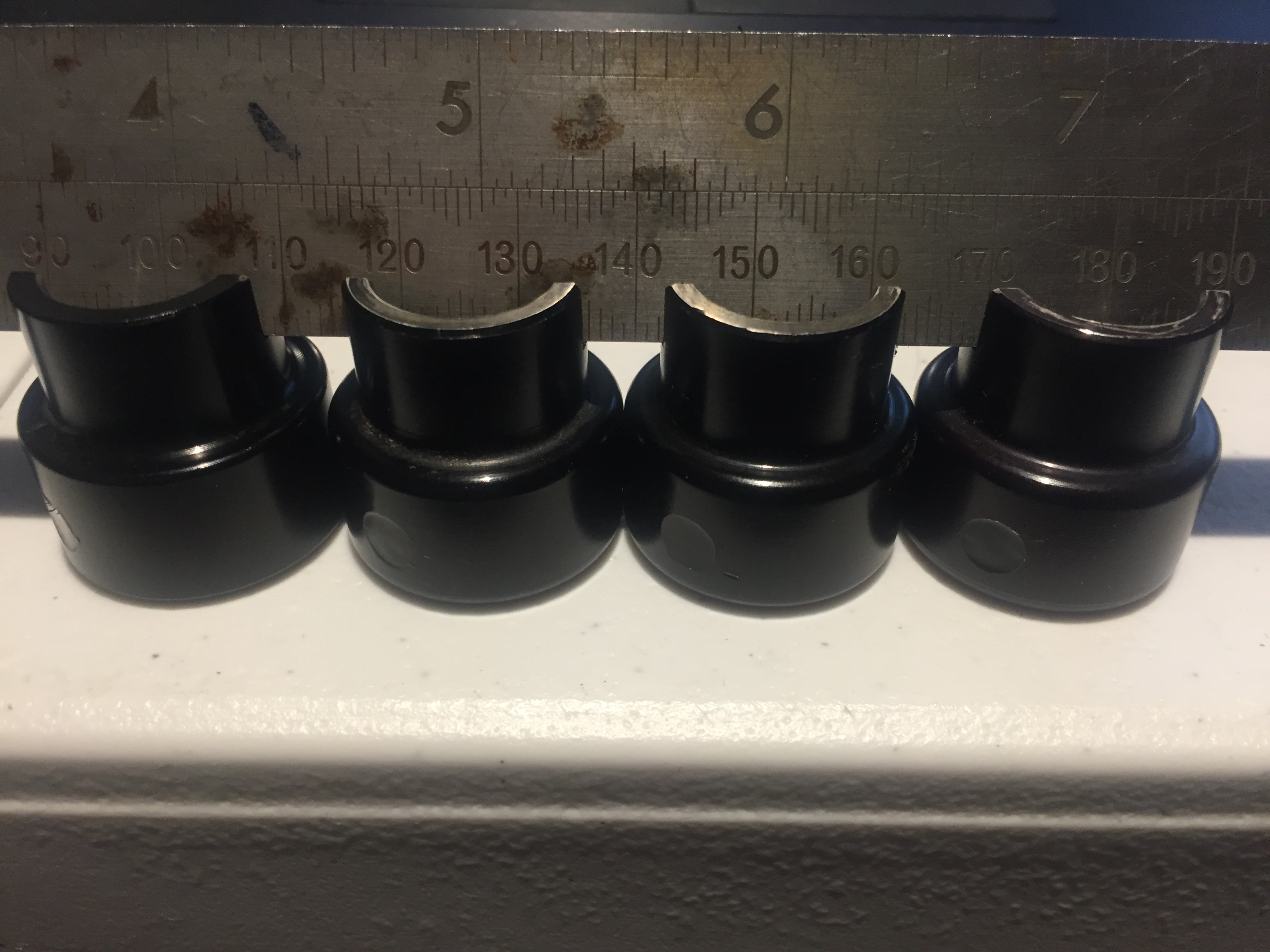

The reason I was reading the thread was because we're trying to get my mates Z1000A running.
We put a Chinesium Dyna on and it ran out of adjustment to get it to align with the full advance mark.
Inspected the rotor against 3 Dyna rotors and the angular position of the magnet is slightly different to the Dynas.
Chinesium one on the left.
Just in case anybody wants to know or is struggling.
So going to flip the backplate to try to get better or proper alignment.
Cheers Gus
Cheers Gus

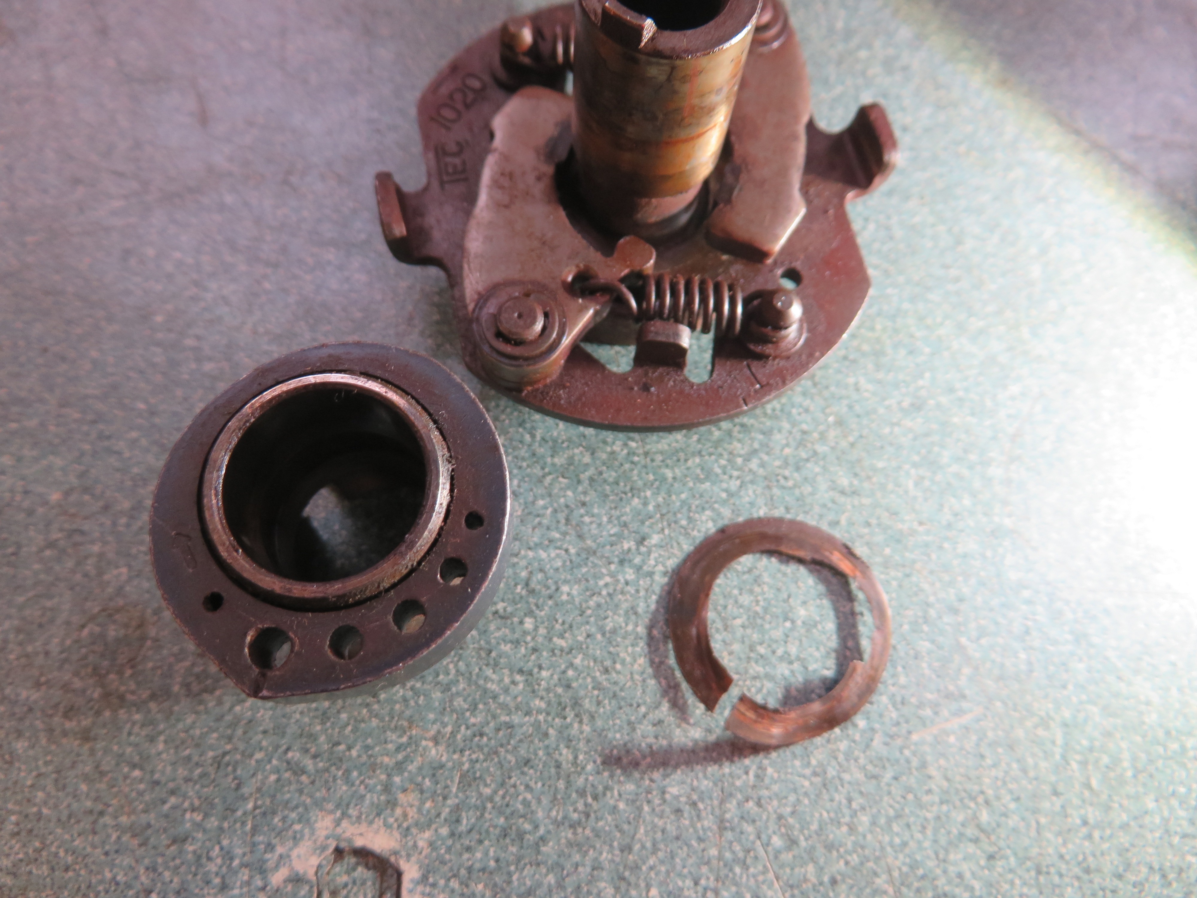

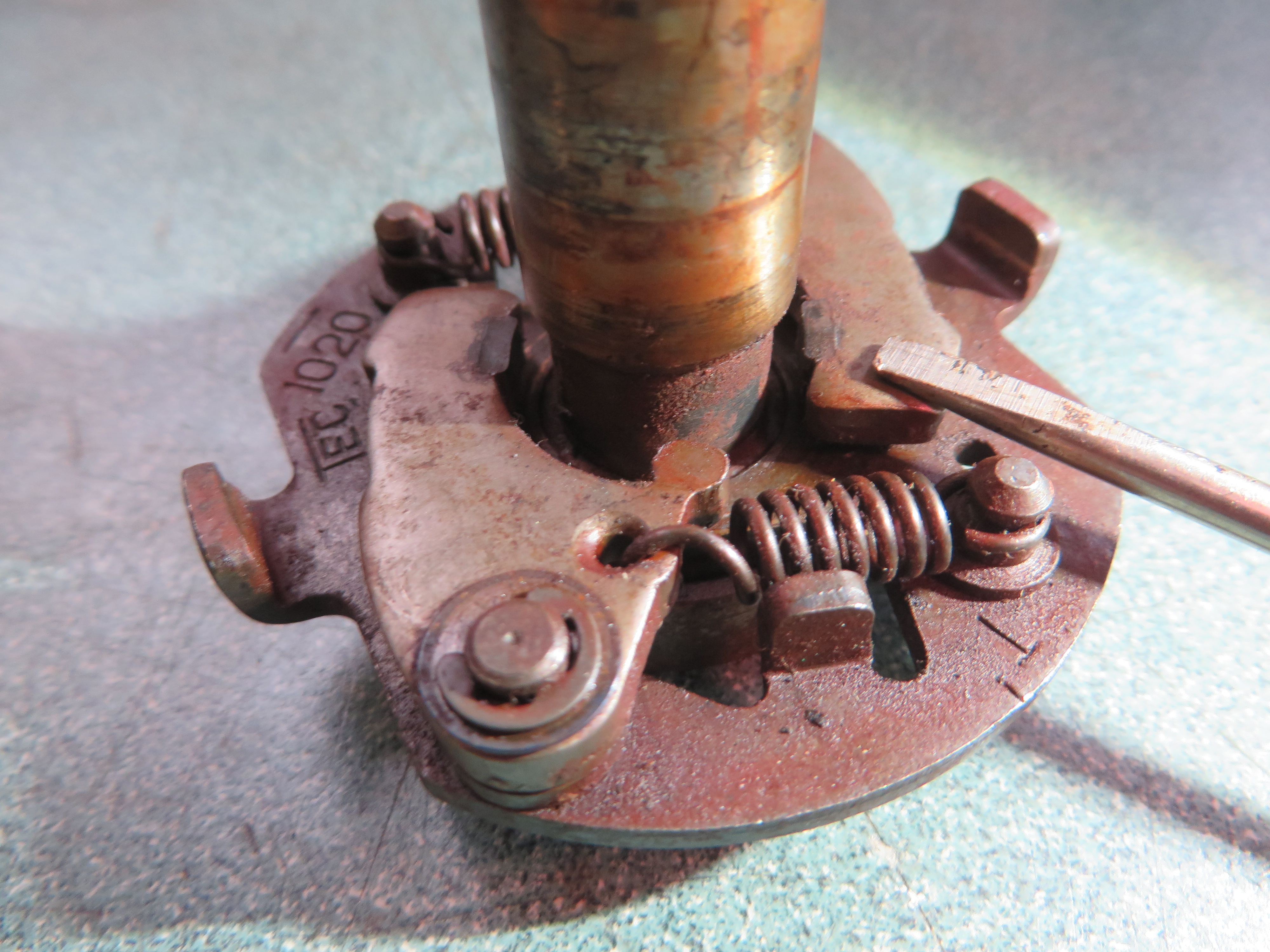

Have you still got the damper pads in place? If not, the 'zero' point will be artificially retarded !! I've seen more missing than present.
If the advance unit still has this shim in it it might be worth removing it as they can easily jam!
