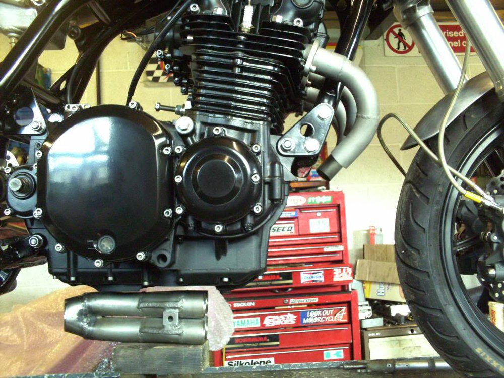

As above Simoniz/Sperex tough black.
It's the closest you can get to original finish and as good as the old PJ1 before they ruined the formula and probably the same stuff Sperex used to call Competition black case paint back in the day.
I use the Satin , let it air dry overnight and then "cure" it in the oven.
The paint can be manipulated to match the finish on the crankcases or glossier for the side covers depending on how many coats and how much heat is applied.
The paint on the pictured engine is all the same satin black which has been treated in accordance to how i wanted each finished part to look.
