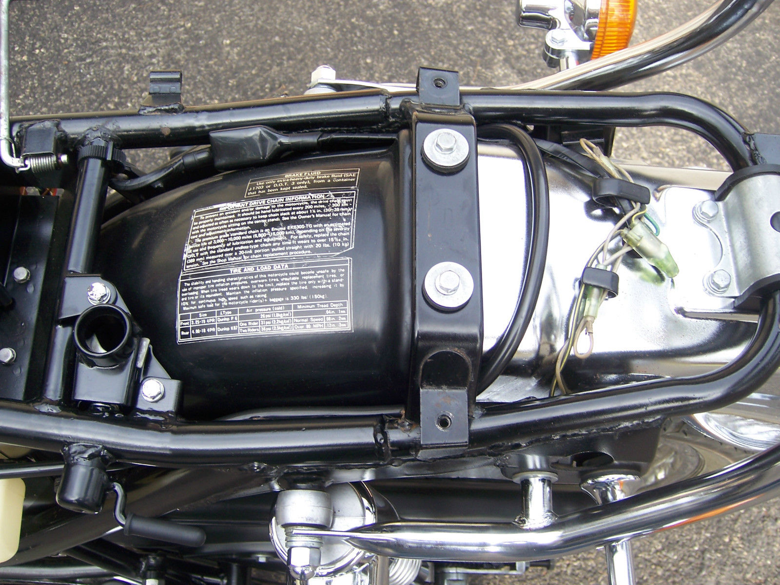

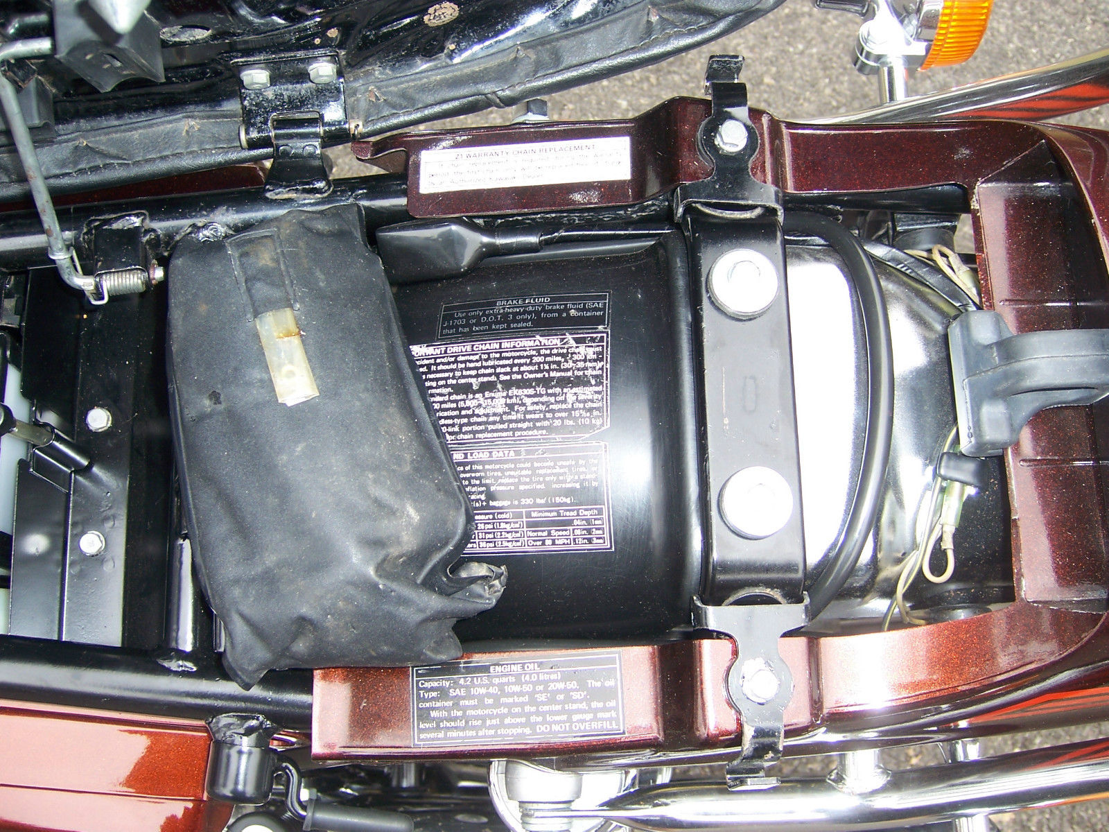

Hi All,
Can someone please tell me what position the lever for the seat locking mechanism should be in when fitting it to frame.
Thank's,
Niall.

Shut, i.e. with the lever horizontal.
Don’t tighten the fastening bolts until you can get the seat to latch first.
