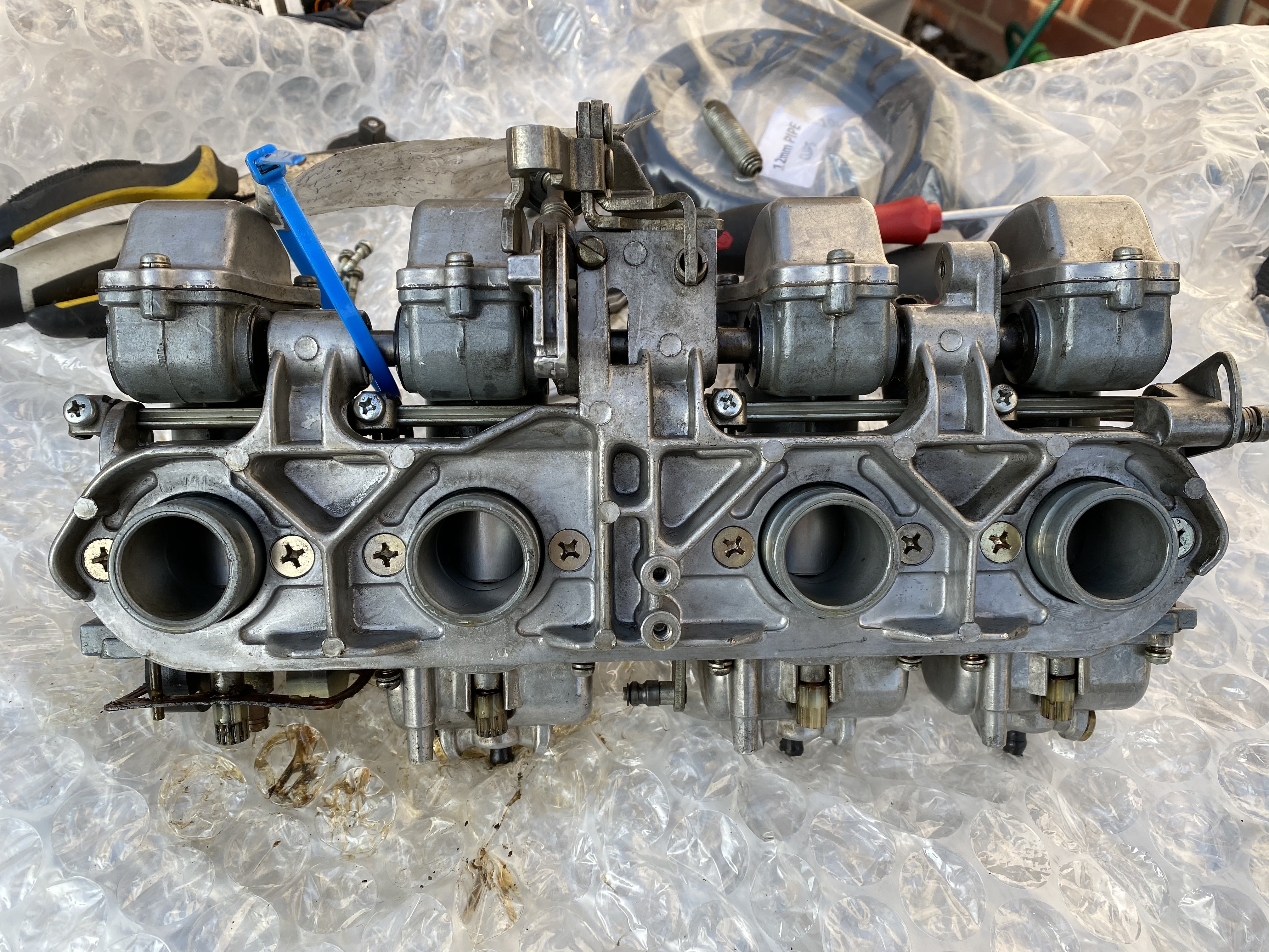

Ok, replacement carbs arrived today.
Hopefully they look ‘right’ now.
I’m not changing anything, I’ll bolt them on and see if they work as expected.
Fingers crossed.

But they are still not A4 carbs.
I see Zed people.
JWO261N
Posts: 71
Joined: 10th Mar 2021
Location: Clacton-on-Sea
Re: Desperately need help
#37 PostAuthor: JWO261N » Wed Apr 21, 2021 6:01 pm
zapo wrote:But they are still not A4 carbs.
Correct, had that conversation with another member last night.
Current thinking is that they are z1000-A2?
But the important thing is that I know they came from a running 900-A4.

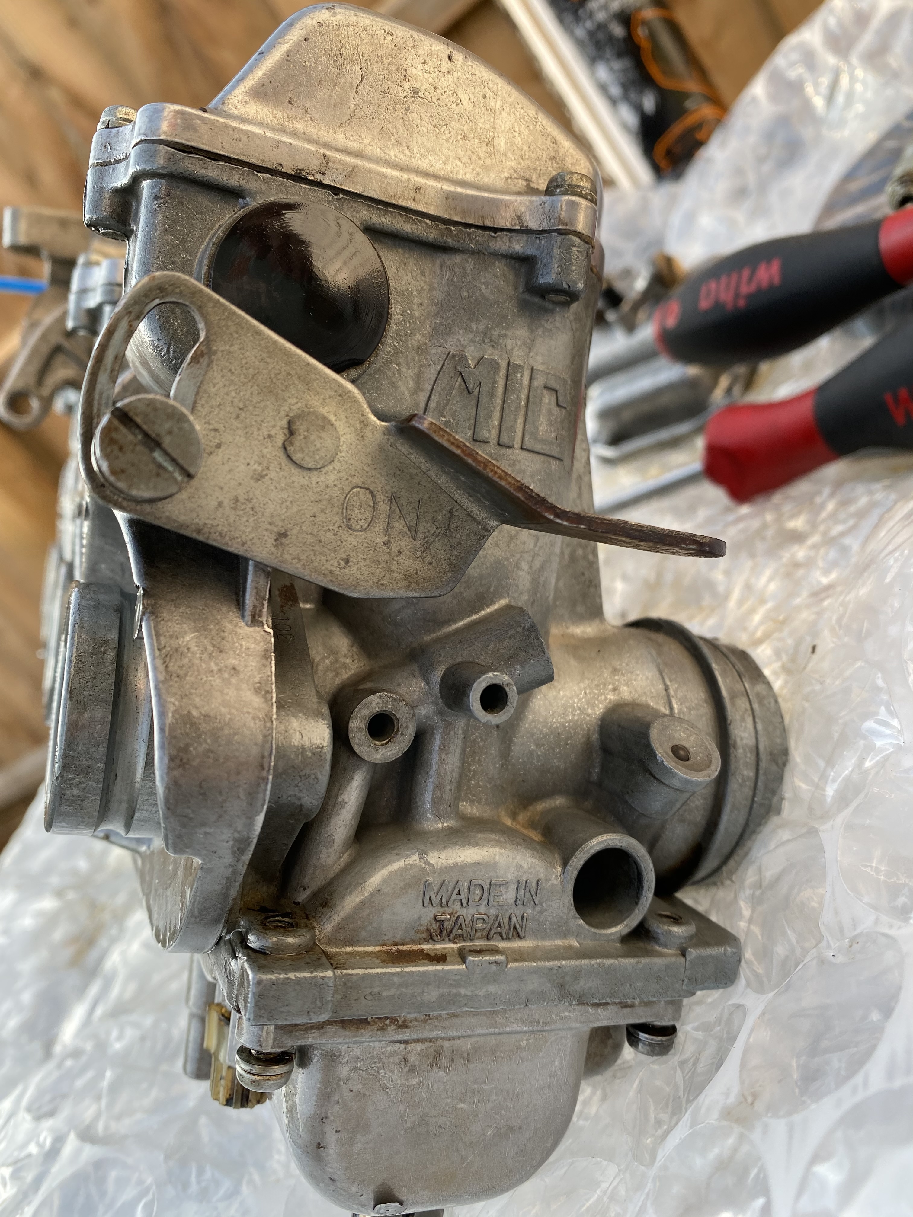

#38 PostAuthor: kev edwards » Thu Apr 22, 2021 6:20 am

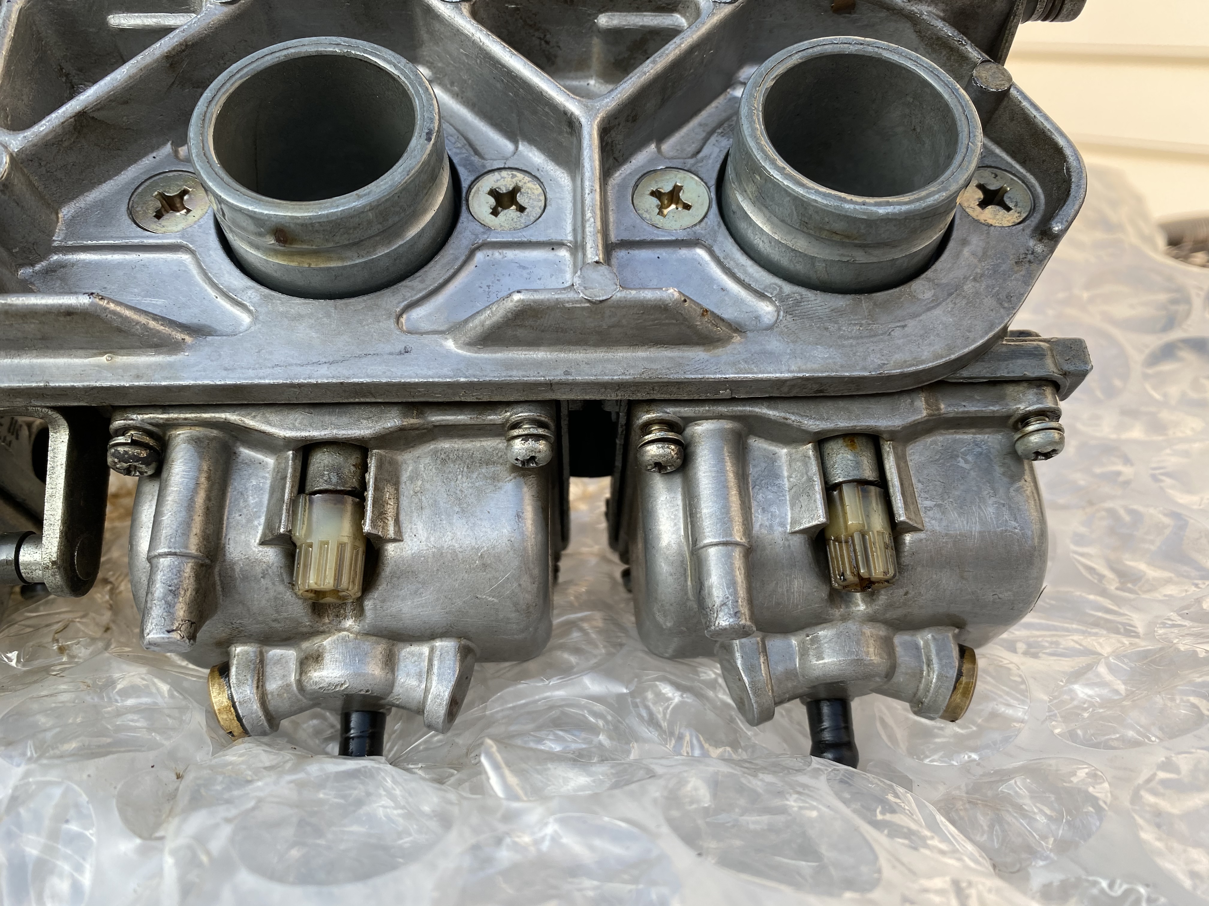

Do they have a vacuum take off spigot on carb 3 if so they are A2 type and this would need capping,, if not they could be ltd, I see they have the anti tamper plugs on the fuel screws, probably come from the States.
Carb 3 does have the vacuum take-off and it’s plugged with similar cap to those on the 4 inlet headers. As an aside, I may use that vacuum to hook my scottoiler too.
These carbs did indeed come from the US (my friend who sent them to me now lives there and they came off of his own 900-A4)
