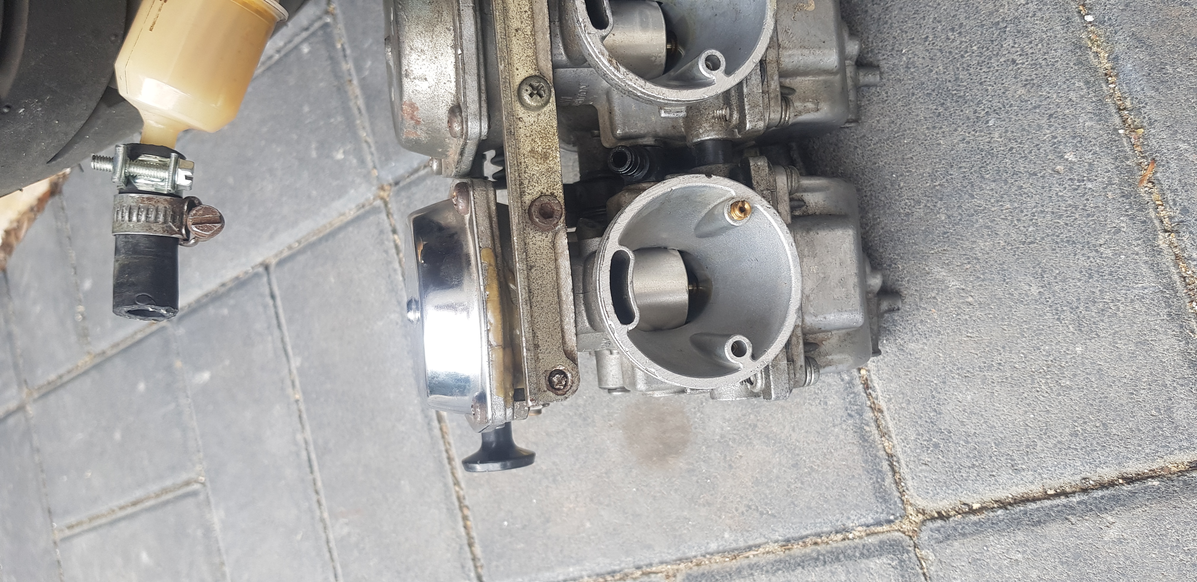

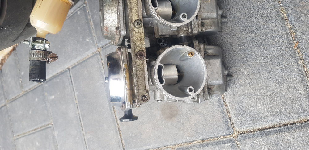

Had a better look at the carbs today and there's a solitary marking of 180 on the main jet. The pilot is 37.5. The needles are definitely chunkier than what I've seen on other carbs so perhaps they're Gpz750 unitrac carbs. There's also a jet in the mouth but without a marking on:
Is this a unitrac carb? Trying to find a starting point.

those look like z750 carbs with acj's fitted mike, (std 750 mains would be 130's, pilots #35 needle in 3rd slot ) gpz carbs are finished in black.
Re: Fitting BS34 carbs with a Z1000J Airbox into a Gpz1100B2
Thanks to 8 Valve Mark, those are Z750 carbs and from threads on Facebook with Glyn Williams, it seems that the Z750 carbsit are a nightmare to get working. Thought I'd try my 1000R carbs on the 1100 B2 and hey-ho it's now running reasonably well. I say reasonably as above 4000 revs it bogs down. It still has the pods but gives me a better starting point.
