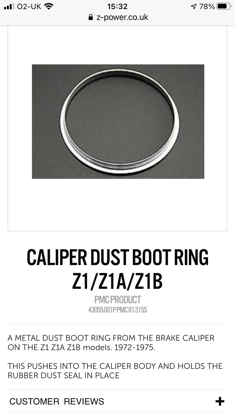

I’m replacing the pistons on an A4 at the moment and found that the ring that should retain the concertina dust boot is missing in both.
Q. Are these rings available anywhere?
I can see they are available for the Z1 range but not sure if they will fit an A4.

The part number is the same for Z1 and Z900.
