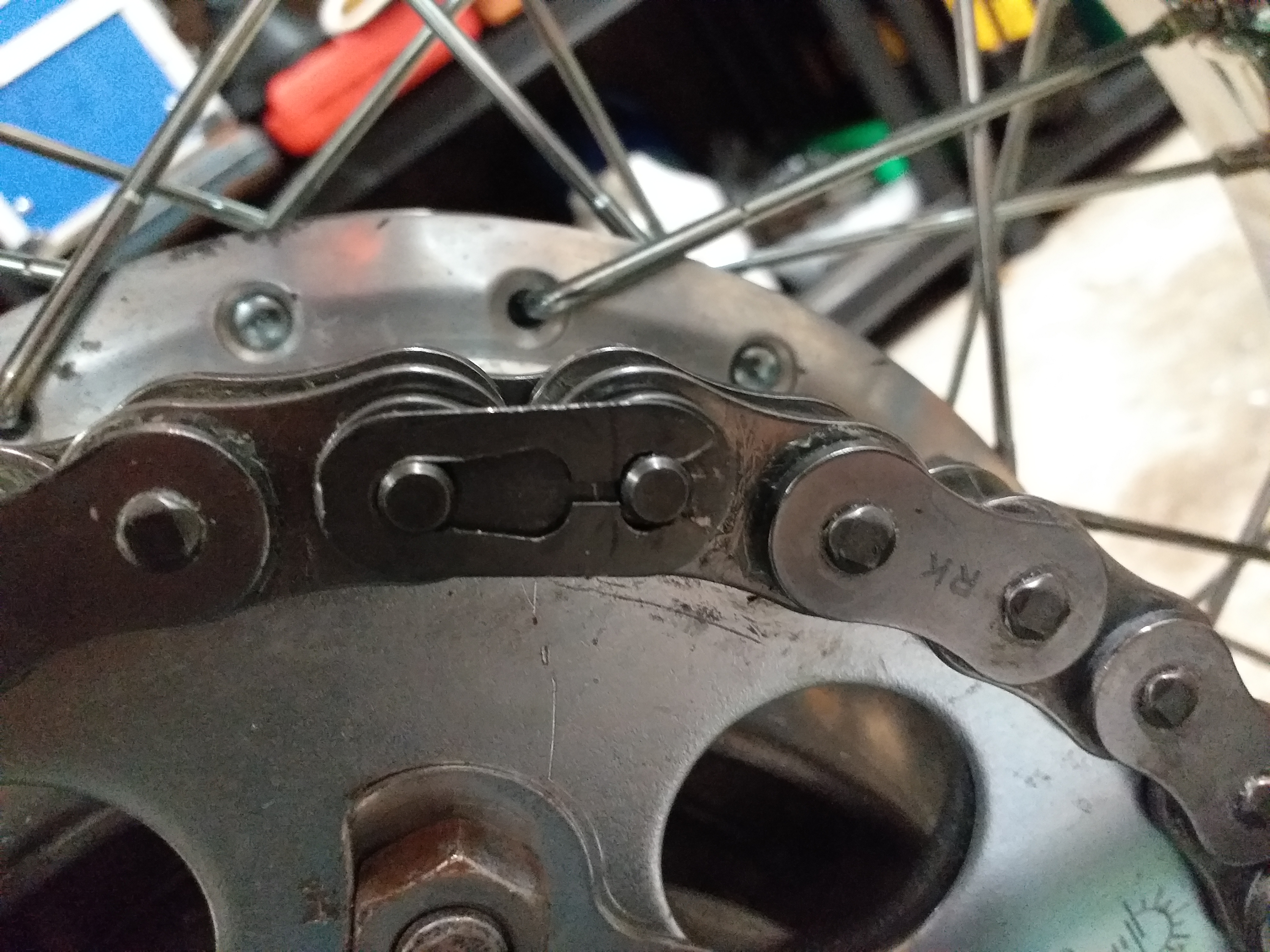

Well, Olly's back brake tip worked perfectly and the front sprocket nut is now tightened to around 100 ft/lb. Unfortunately I had fun and games with the split link as can be seen from the photo. I didn't realise that you still had to compress the side plate onto the link with the chain rivet tool and so had the same problem as previously when I tried to fit a soft rivet link. Following that disaster I went for the spring-clip split-link type thinking it would be easier. Well there's no fool like an old complete nobhead! I still had to apply so much compression to get the linkplate over the pins that I nearly pulled a muscle again (which I actually did in the first attempt last year). I did actually manage to get it to the point where it had compressed past the grooves on the pins for the spring-clip to seat. Nobhead skill Mk II then took effect as I managed to clip it on in the wrong direction! My attempts to get it off and back on again resulted in the clip bending and now refusing to seat properly as per the pic.
I have finally decided that my Oxford chain riveter is crap (although to give it it's due it does clearly say on the box it's for up to a 530 chain and I have a 630 XW-Ring). Can anyone recommend a top quality chain-rivet tool that does not need the muscles of an olympic weightlifter to use? Cost is not an issue as long as it's good value for money. I am wont to go back down the soft rivet route again if I can get the right tool for the job.
TIA guys.
