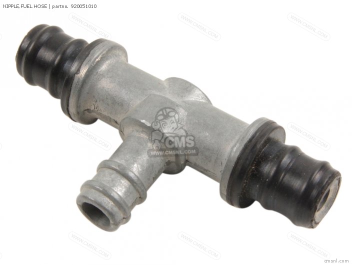

z1bman wrote:kawasaki never made them with a seperate o ring fitted it was moulded to have the same effect as an o ring someone has probably fitted suzuki gs750b fittings that have seperate o rings & are available to buy seperate & are the same size as the kawasaki
Thanks for the info. The bike I have started life as a KZ and must have been imported from the US at some point. Don't suppose you know the part numbers for the Suzi O rings or who might sell them? The CMS website shows them on the diag but the part detail section is missing for some reason. Cheerss

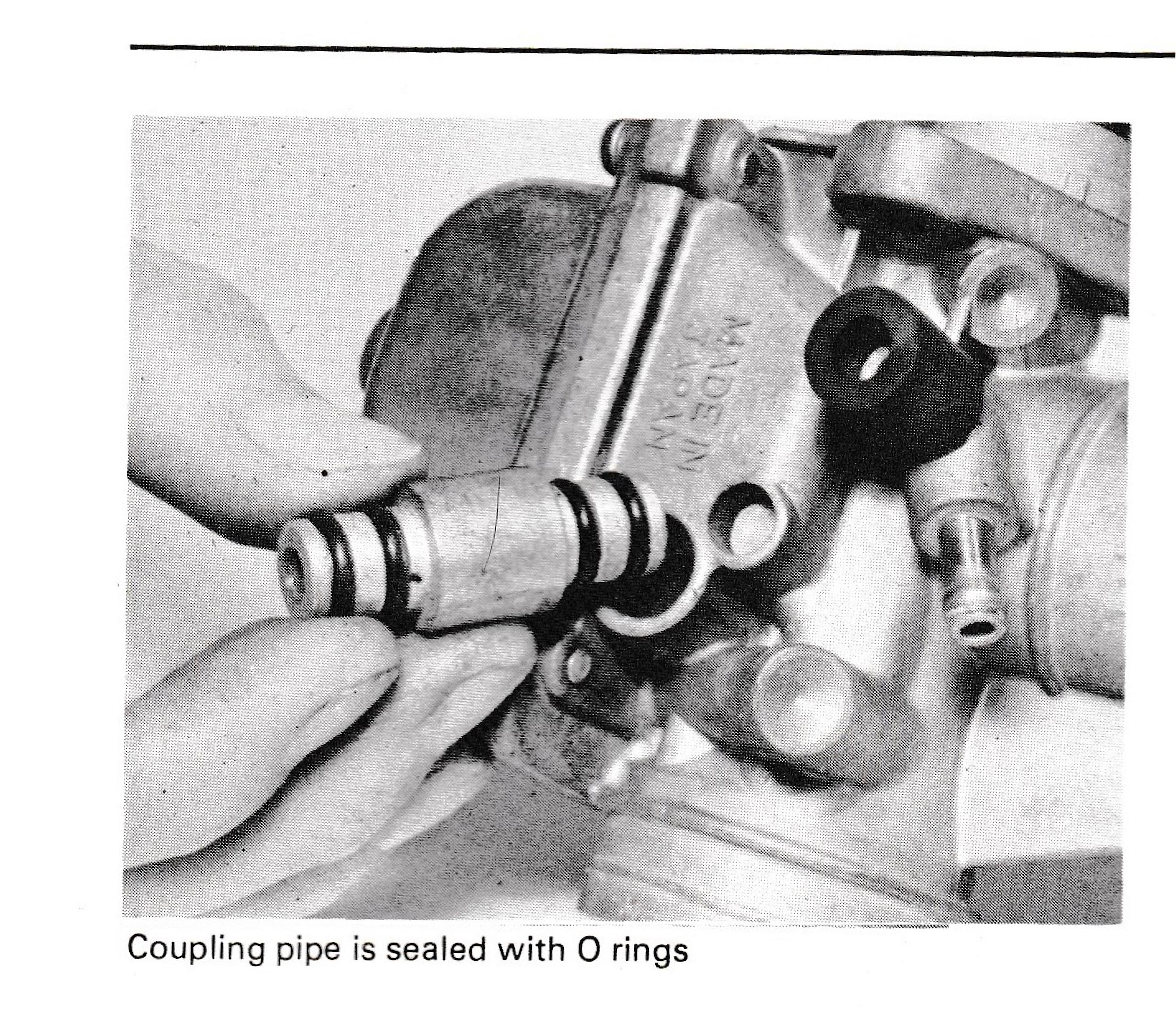

z1bman wrote:i worked at cradley for over thirty years as a mechanic & have stripped many of these carbs & have never seen them with removable o rings if they had removable o rings they would be shown in the parts diagrams or parts microfiche. contact dave marsden at z power if you want more confirmation gs 750b
Not getting anal about it just ensuring the thread has accurate info. I don't need to contact Dave, I KNOW from all the B1's I have worked on and restored. From the three B1's in this thread the owners have found all three to have O Rings.
From my 1976 Kawasaki workshop manual. As I said, B1's definatley had O rings, later models did not.
Posts: 3097
Re: Z650 fuel linkage O rings
#21 PostAuthor: warren3200gt » Fri Jan 22, 2021 2:27 pm
Cmsnl are known to get it wrong occasionally. Even the pic posted is not correct for non o ring 650 coulplings. 650 non o ring couplings didn't have ridged rubber sleeves. They were solid "plastic" of some sort with two rigdes each side to emulate o rings.
The pic I posted was from a Kawasaki manual who had the correct parts and info to hand as they were the manufacturers not third party parts suppliers.
Both my bikes have identicle to the pic I posted.

warren3200gt wrote:Cmsnl are known to get it wrong occasionally. Even the pic posted is not correct for non o ring 650 coulplings. 650 non o ring couplings didn't have ridged rubber sleeves. They were solid "plastic" of some sort with two rigdes each side to emulate o rings.
Yup Warren, the fuel linkage pieces I have with O rings are identicle to the one in the Kwak manual picture for the B1. Matt

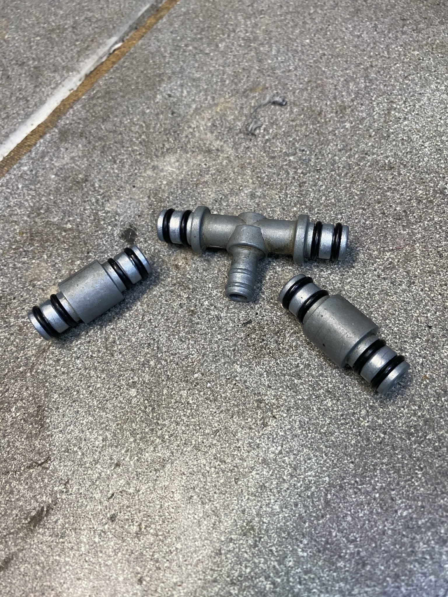

#24 PostAuthor: KeithZ1R » Fri Jan 22, 2021 3:11 pm
I took these out of a 650 B3 two years ago Paul :?:

#25 PostAuthor: warren3200gt » Fri Jan 22, 2021 3:16 pm
Keith, were they 24's or 22's can you recall? Both of mine are 24's. Just wondering if 22's are the same? I cant imagine mikuni would have changed anything other than throat size between the two sets.

#26 PostAuthor: mattc » Fri Jan 22, 2021 4:12 pm
warren3200gt wrote:Keith, were they 24's or 22's can you recall? Both of mine are 24's. Just wondering if 22's are the same? I cant imagine mikuni would have changed anything other than throat size between the two sets.
Mine are also 24's Warren.....

#27 PostAuthor: mattc » Fri Jan 22, 2021 4:14 pm
KeithZ1R wrote:I took these out of a 650 B3 two years ago Paul :?:
That's them exactly....except my O rings were quite distorted with age. Once you take carbs apart and disturb them they are bound to leak..

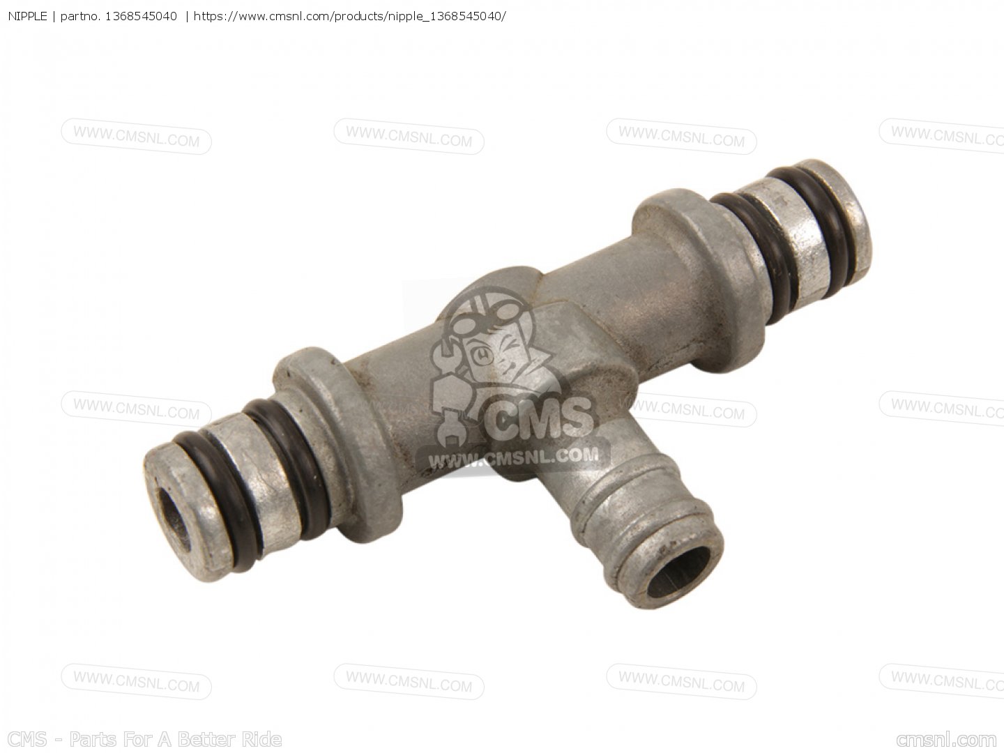

#28 PostAuthor: z1bman » Fri Jan 22, 2021 4:31 pm
this is whats fitted to the suzuki gs750 & gs1000 part no 1368545040

#29 PostAuthor: warren3200gt » Fri Jan 22, 2021 5:02 pm
Think they may have mixed their pics up? Wouldn't know as never worked on a gs.
