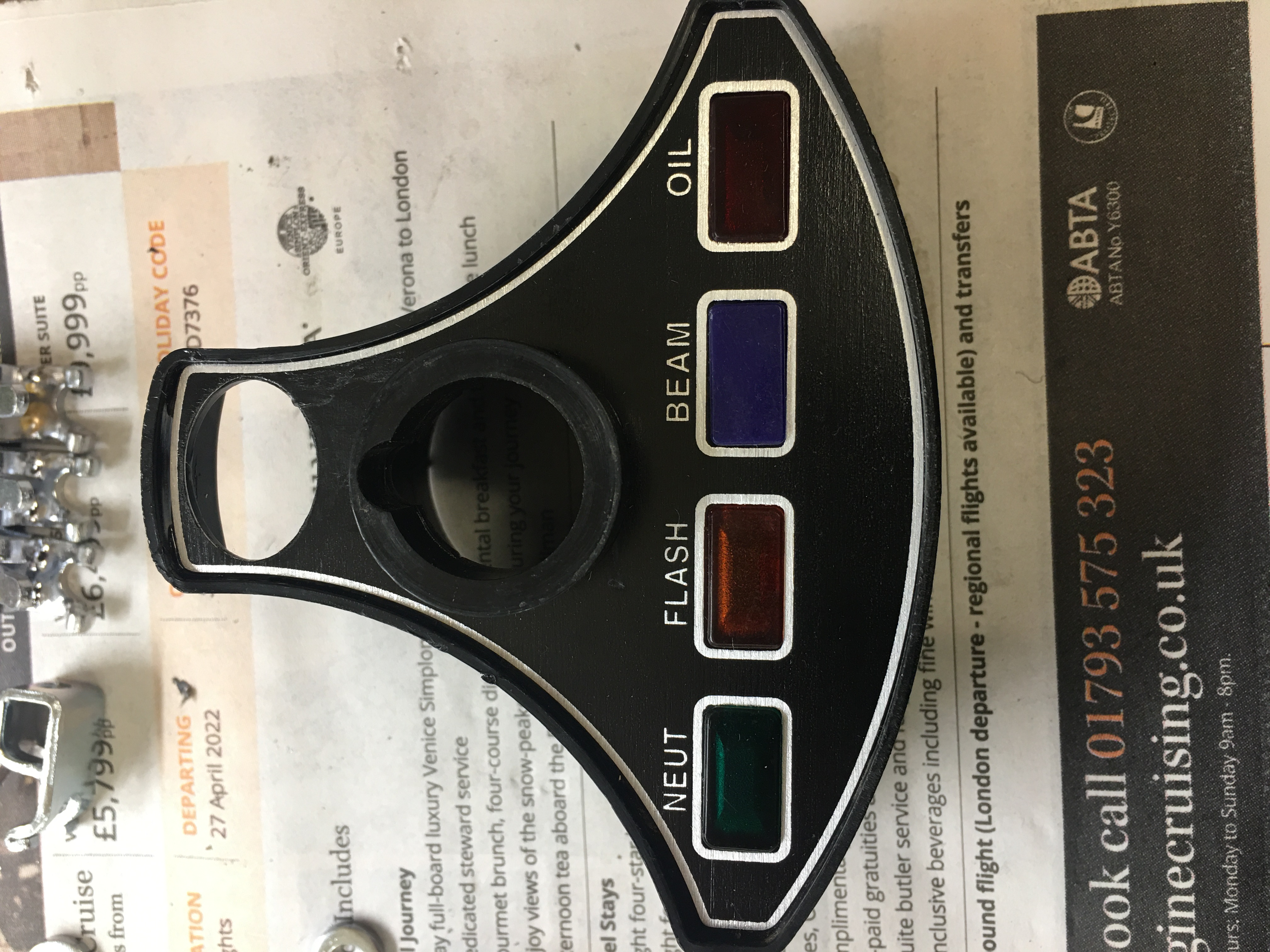

The inset panel arrived from Z-fever and it's a marked improvement on the standard repro item.

Can you give it a full review? Looks a bit hand painted. I see it picks up the brushed aluminium look
but it looks painted. Thanks

#8 PostAuthor: steve » Mon Dec 21, 2020 10:57 pm
I've just fitted one of the Z-fever panels and the quality is excellent, very difficult to tell from the originals. Would recommend

#9 PostAuthor: wilsonsjw11 » Tue Dec 22, 2020 11:44 am
Steve,
Excellent quality reproduction and no, they are not hand painted.

#10 PostAuthor: steve » Tue Dec 22, 2020 2:34 pm
Steve, removing the original was my concern too.
As you probably know, the circular plastic piece can be pushed out from the back. I then started at the top with a very small screwdriver just to prise the decal away from the plastic. Once I'd got past the oval hole, I changed to a larger but very worn screwdriver with rounded ends and just worked my way across. There's quite a bit of glue but the decal came away without too much fuss. I then used a rounded scalpel blade to gently remove all the glue and residue. The coloured lenses have little tabs which also had glue stuck to them...again, these are easily cleaned up before popping them back into position.
