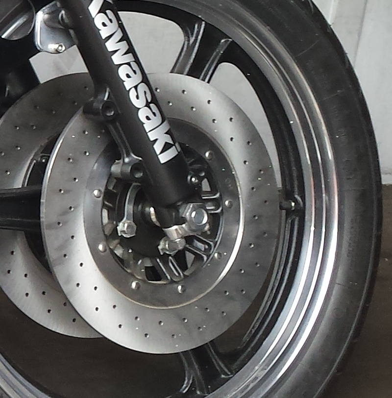

#6 PostAuthor: warren3200gt » Mon Sep 14, 2020 11:50 am
Thurston engineering in Essex did a pair of 650 discs for me. Surface ground inside and outside face without taking the middle out. Cost about £50 per disc if I remember right. Before and after braking was chalk and cheese.
