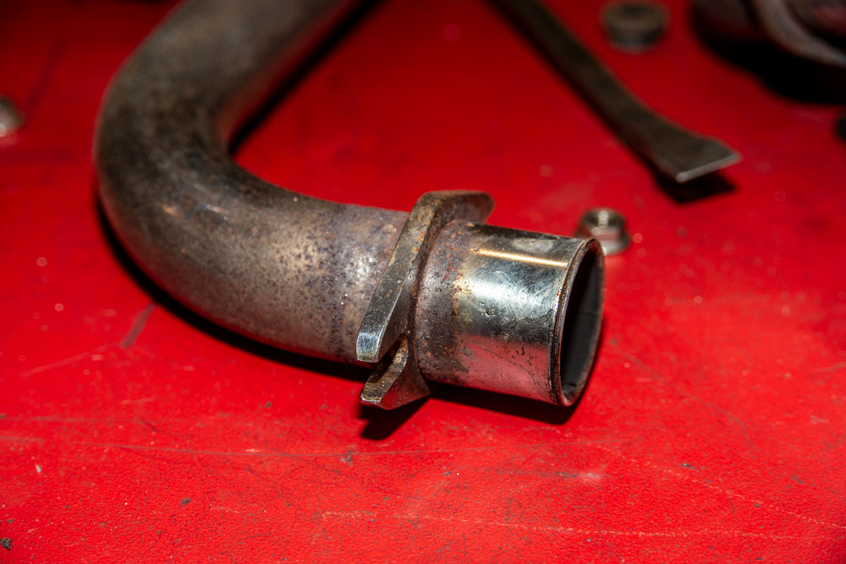

My A4 has an original 'arris and it's a decently made piece of kit. I dearly love the howl of a straight through 'arris on a Zed so want to make it like new.
Problem is that the header flanges seem to be made post chrome. I would quite like to use a set of original Zed collets and clamps, but am unsure whether the flange is wide enough.
Has anyone on here had an original works collection zorst re-chromed?

Rechroming s never as good as original

Not if they have to polish the front pipes so thin that they tear when trying to fit them .... as happened with an Alfa exhaust I had.

Go ceramic Ralphy?

#6 PostAuthor: kev edwards » Sun Sep 06, 2020 1:24 pm
