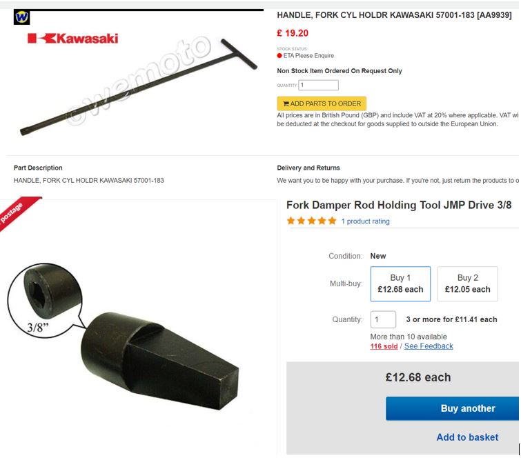

I've tried numerous methods which initially worked (impact wrench on allen key, tubes and bars of metal with formed ends) and finally a set of forks on the ELR wouldn't budge. I gave in and bought the pukka tools via Wemoto (takes a couple of weeks to order in). Used them numerous times now:
Part numbers: 57001-183 and 57001-1011
Probably could make a similar tool out of square bar, but you'll need to harden the square end so it bites the damper tube.

Mike thanks for the reply, I have one of those but there is nothing for it to hold onto, I have been told by an ex Kawasaki mechanic, that Kawasaki did on occasion use the type without the square hole, but very rarely,

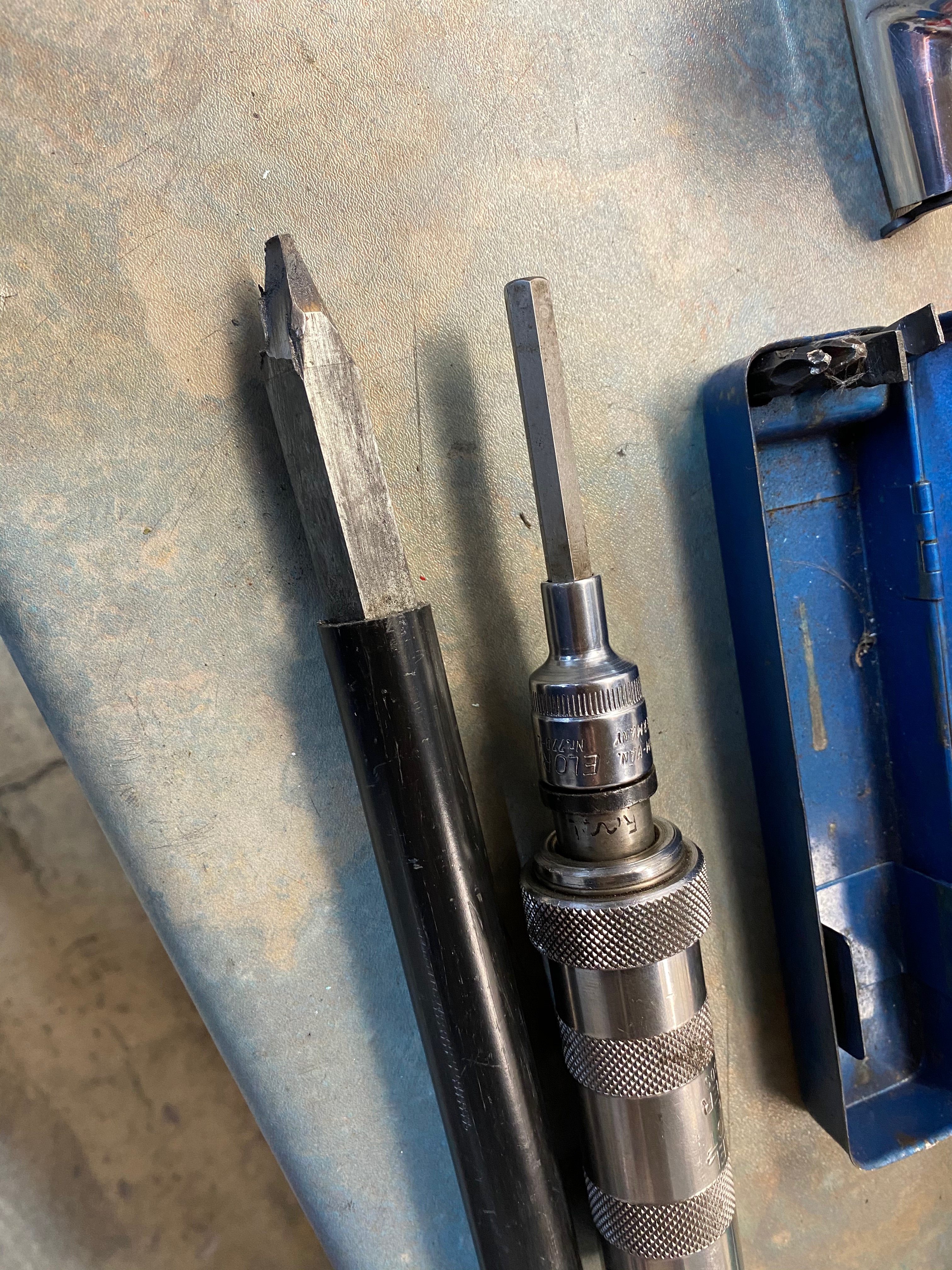

I have a piece of key steel roughly tapered in the end of some steel tube
I find that inserting into the damper, standing the fork so the tapered tool is on the floor and then give bottom allen bolt a good whacking with the impact driver seems to work.
