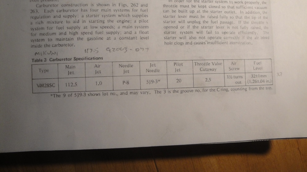

5J is the needle, 9 is the lot number. This information comes courtesy the Kawi Z-series shop manual, just below the jetting chart. If in doubt, go to jetsrus.com and purchase Mikuni needles, the new lot number is 11 (or 5J11). I would do this anyway as you know they are correct. Not to kink your cable, but Mikuni parts ALWAYS work best. Also, this website has a lot of useful information. Cheers, Rick

In answer to your original query, Here is a link to show exactly where the needles need to be measured to ensure they are in fact correct. Dial calipers would suffice, but a good micrometer would be best. Good riding, Rick

Here's the maint. manual page with the standard Z1b jets and needle nomenclature.
- Attachments
- 3b. Jetting chart.JPG (152.66 KiB) Viewed 3436 times
- 3a. Carb maint..JPG (183.72 KiB) Viewed 3436 times
- 3. shop manual.JPG (149.04 KiB) Viewed 3436 times
Re: Z1-B rebuild - carb renovation
rick-chuck wrote:Here's the maint. manual page with the standard Z1b jets and needle nomenclature.
That isn’t the spec for a Z1B. The Z1B has 1.5 cutaway, a 17.5 pilot and the needle should be on slot/ groove 2.
