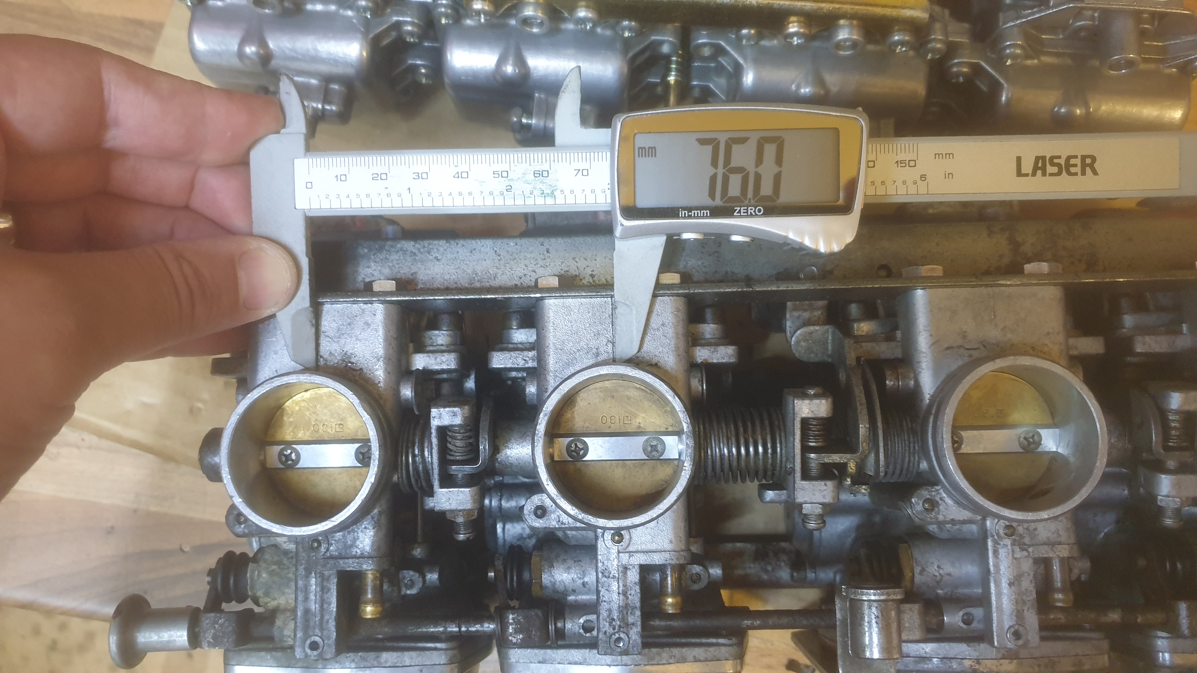

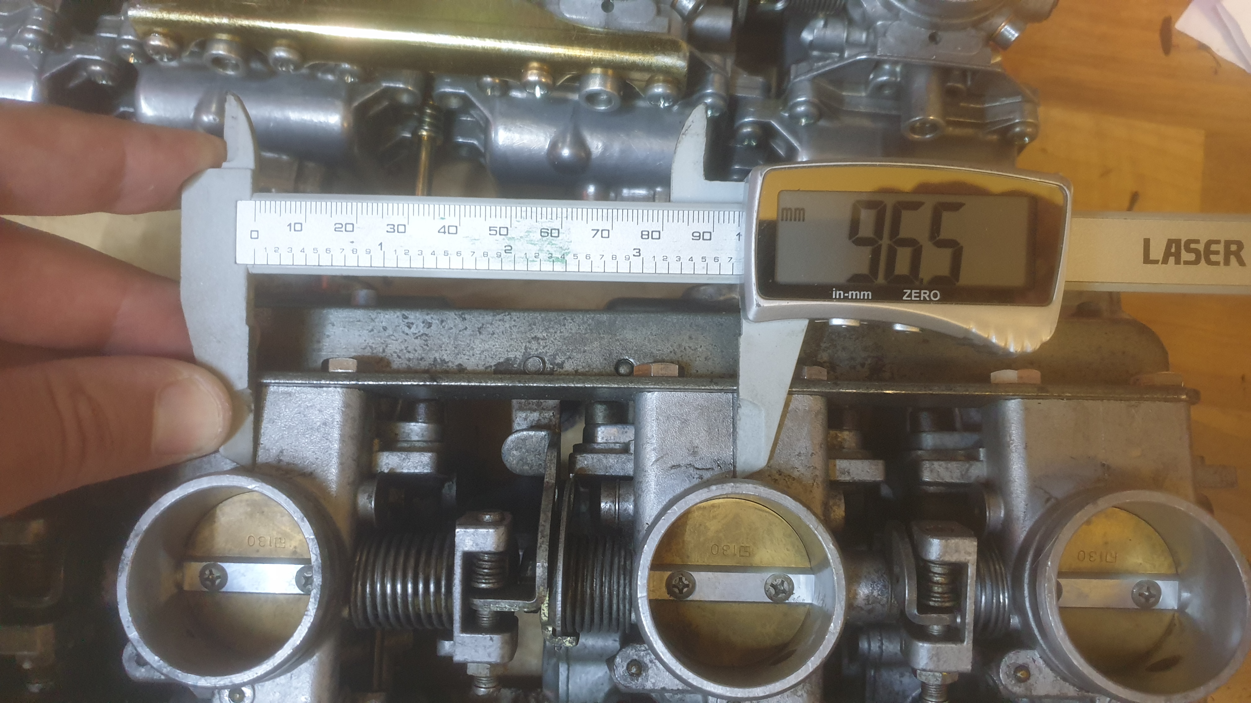

#12 PostAuthor: oldzed » Wed Jun 17, 2020 8:44 pm
Took some pictures of carb spacing on my BS34s
First picture is carb 1 to 2
next one is 2 to 3.
Excuse the grubby fingers was just finished work
member number 0664

#14 PostAuthor: Gibbotvr » Thu Jun 18, 2020 10:19 am
Thanks for the pics please see mine..
The BST34's I got went the other way down to 90.6mm so it was just too much for the inlet rubbers to deal with.
