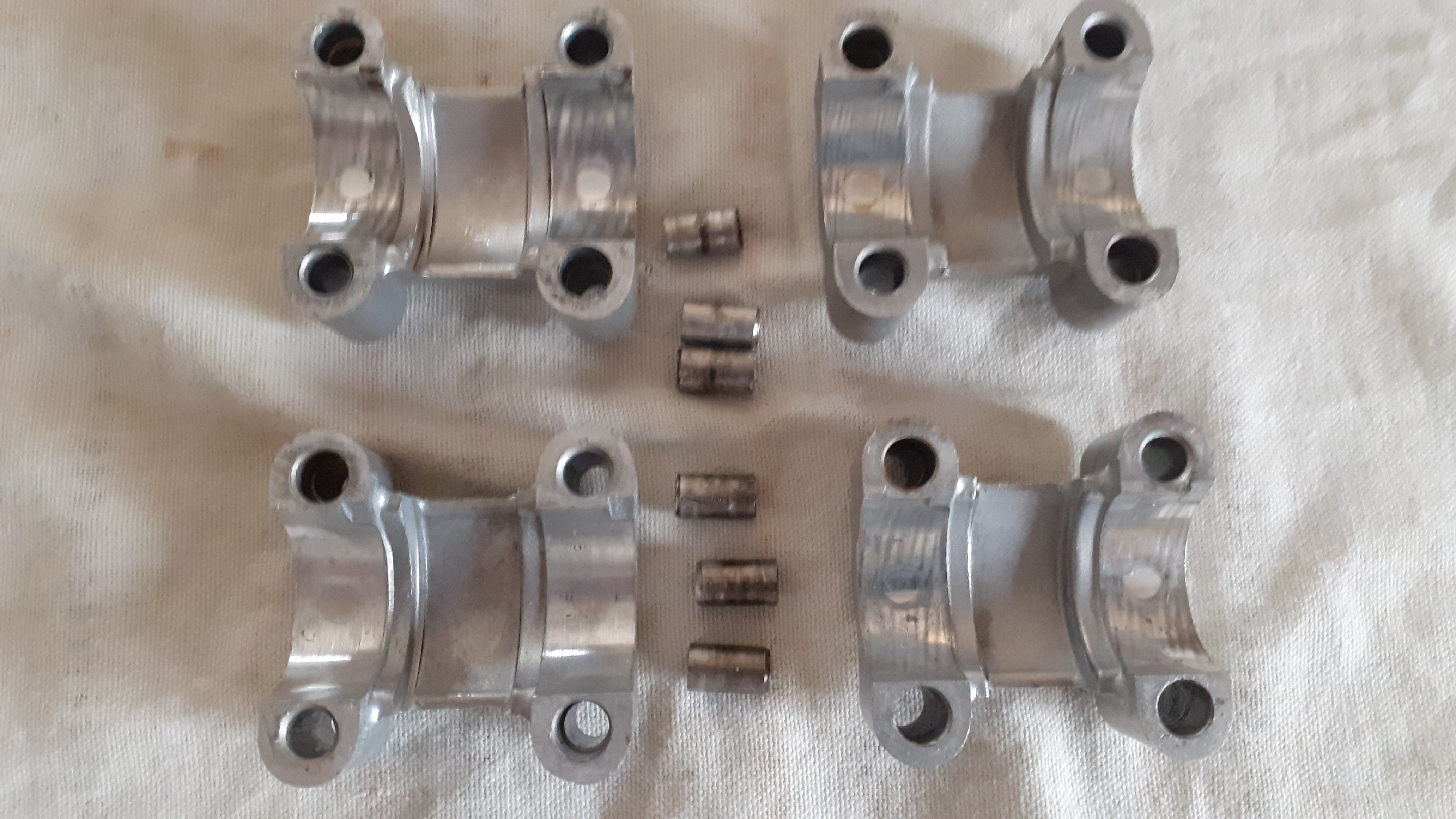

Just realised, the only head I have, has mismatched cam caps :(
Has anybody got a selection of caps they'd be willing to sell/loan me so that I can find four that work?
Alternatively, is there anyone who can make my caps work during this lockdown madness? TIA.

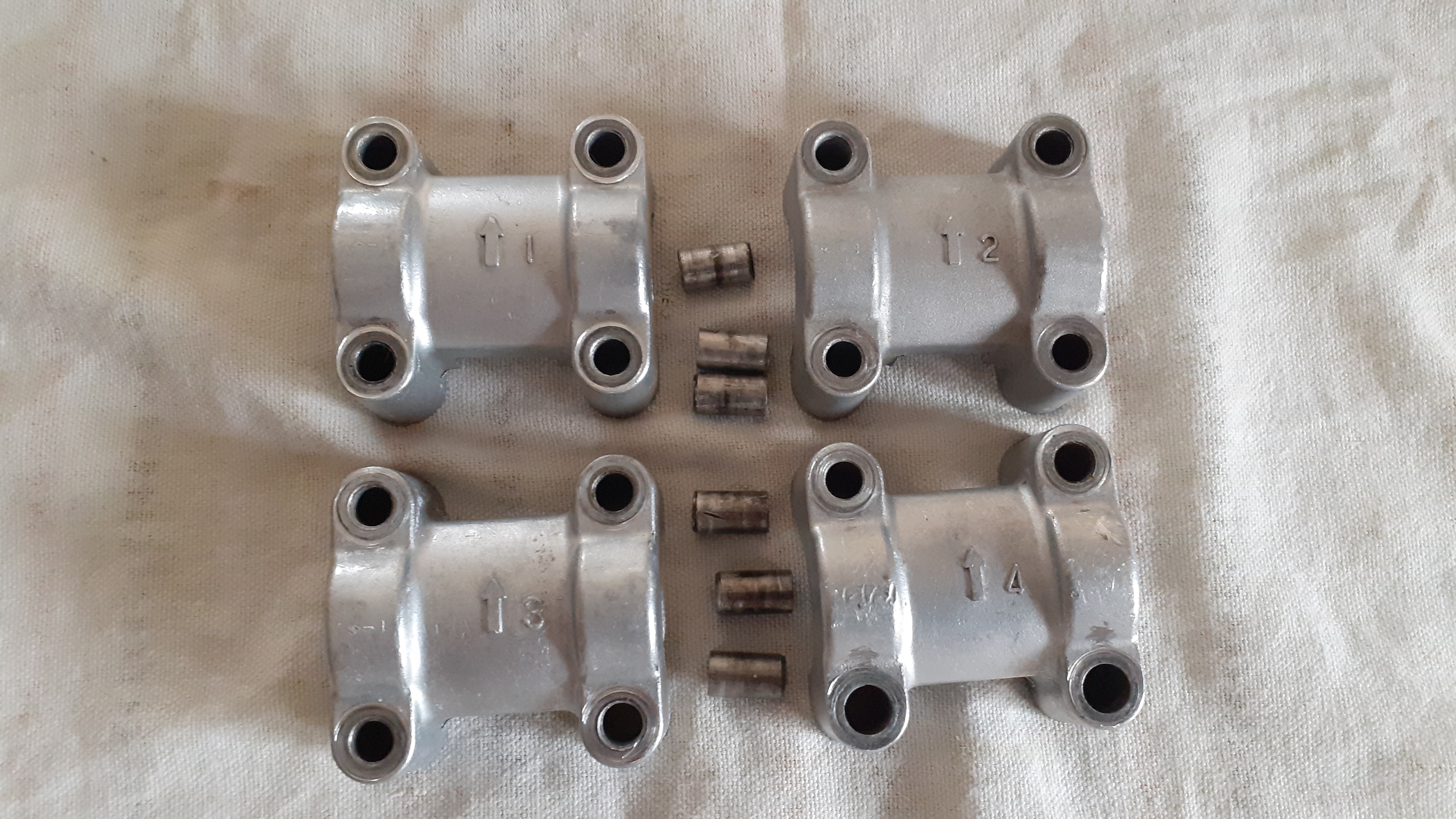

Big thanks to Kev for getting his caps to me so fast.
I've now got no.2 & 4 which seem OK but 1 & 3 still not great.
I can get them spinning pretty good with no dowels but clearly that's not ideal.
If anyone else has any 1's & 3's that I could have I'd be eternally grateful. Happily swap for the ones not working for me.
