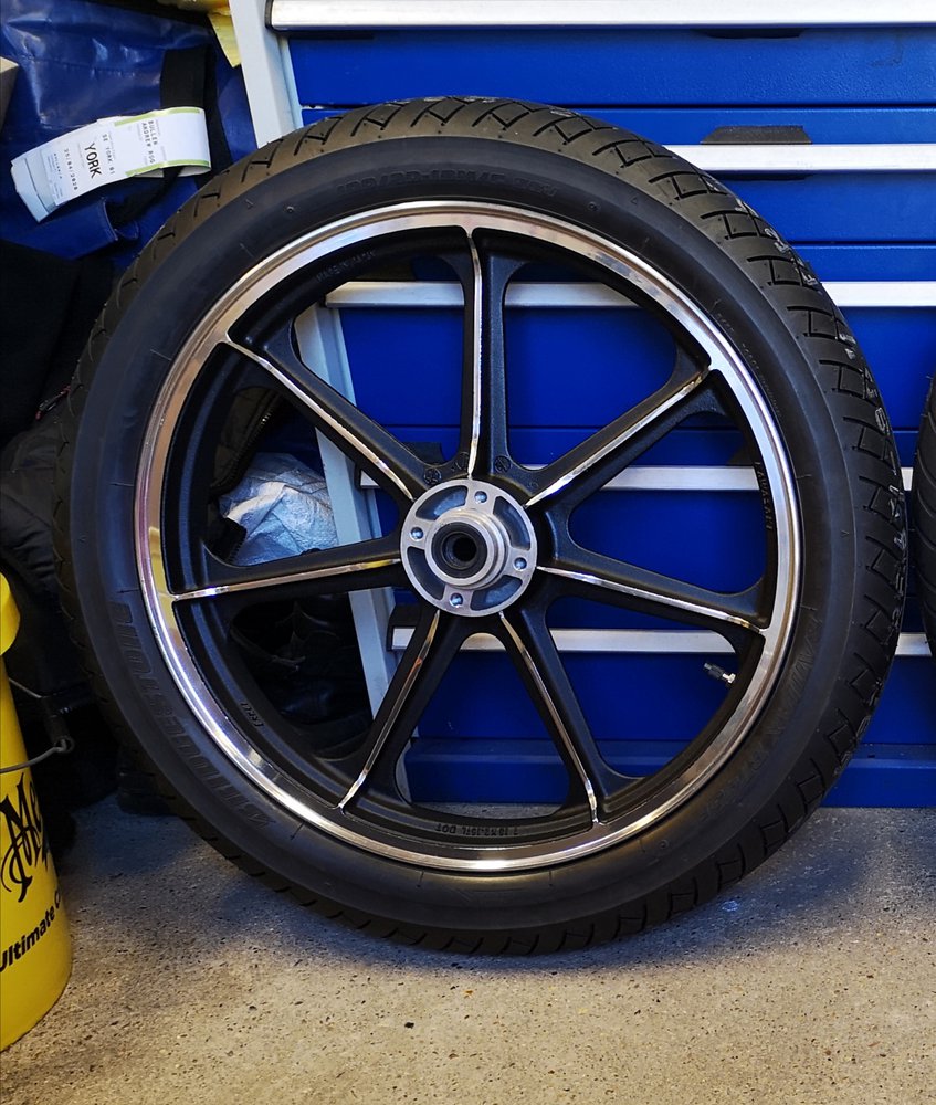

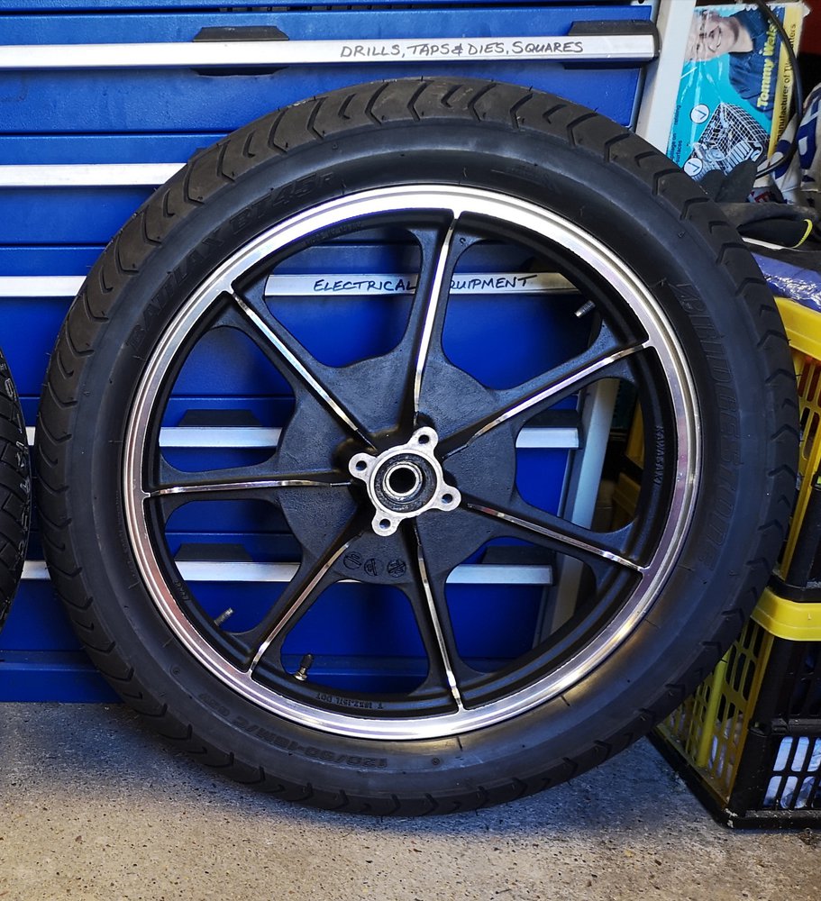

#9 PostAuthor: bulldogbobby » Thu May 07, 2020 7:41 am
Polished and Painted.
Pleased with the results - let's see how they hold up :D

bulldogbobby wrote:Polished and Painted.
Looking Good. :D :D
