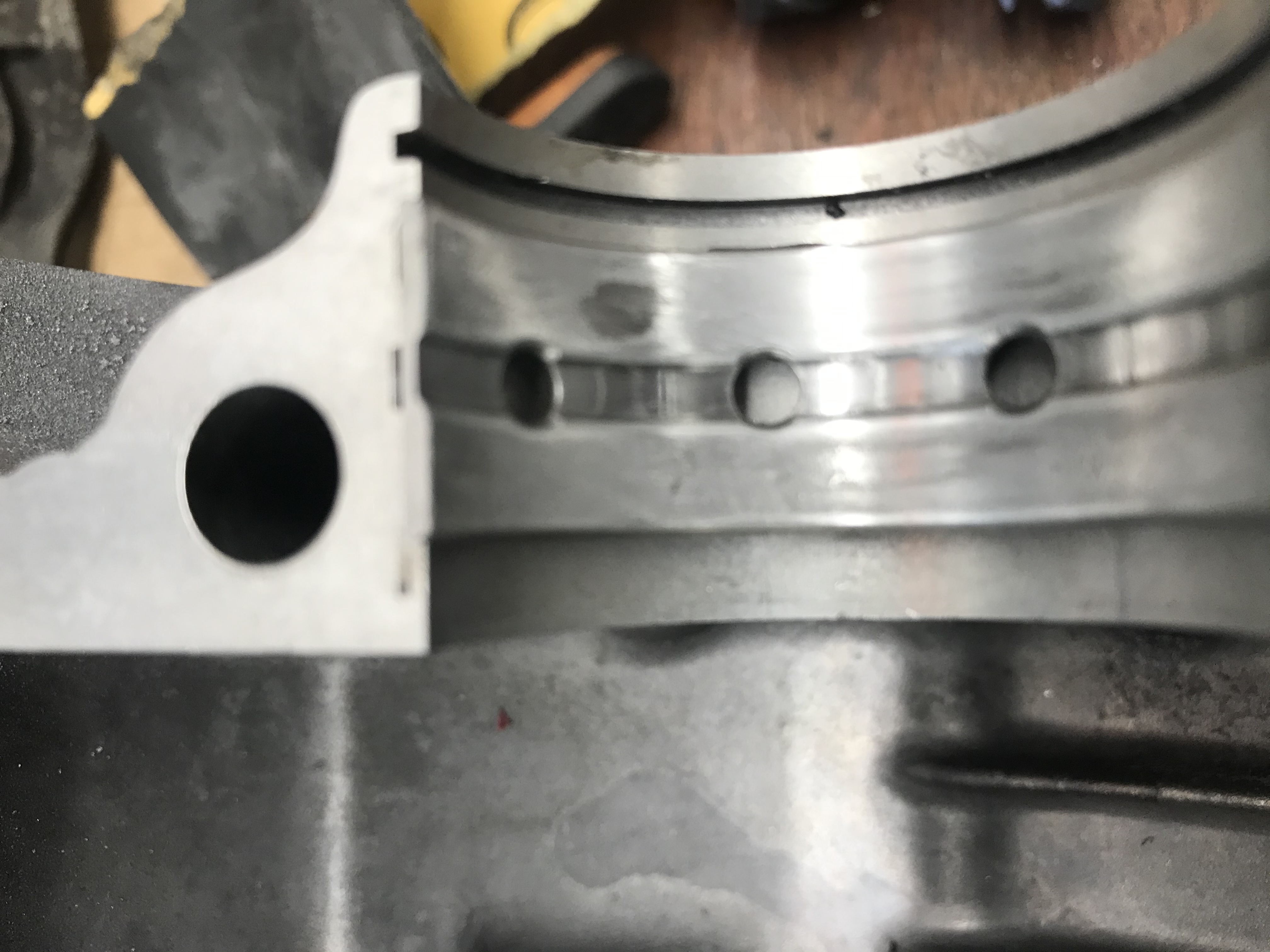

Hi Guys, back onto this engine build after some time and I’ve managed to sort everything out and started back on Crank Journal clearance. Assembled everything and platigauge checked the clearances and all well within spec. However then I notice one journal has a bit of uneven wear on it - see below..
I’m thinking best I replace them, or at least this one. The rest look ok. Question I have is if I need to replace them is there a way to determine the thickness by the stamping? I see D2C on it? Reason I ask is I will need a better measuring instrument to get to the .001 accuracy I need to determine what colour I need. Unless I’m being really stupid here which is possible so please let me know :lol:

if you are replacing them like for like there is paint on the edge of the shell check across all the main bearing shells to see if you can identify the colour & order them from the part no in the workshop manual that relates to each colour
LeeJackson
Posts: 496
Joined: 17th Oct 2015
Location: Aberdeen, Scotland
Re: Z750 Crank & Conrod Markings
#8 PostAuthor: LeeJackson » Sat Mar 28, 2020 10:07 pm
z1bman wrote:if you are replacing them like for like there is paint on the edge of the shell check across all the main bearing shells to see if you can identify the colour & order them from the part no in the workshop manual that relates to each colour
Yeah I was looking for that but seems that it’s disappeared with time unfortunately I couldn’t see any paint left on any of them.

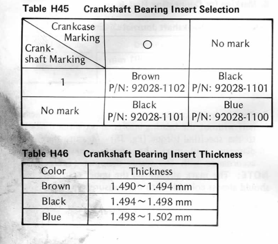

measure the shell with a vernier & not a micrometer & use this chart to determine which size shell you need
LeeJackson
Posts: 496
#10 PostAuthor: LeeJackson » Sun Mar 29, 2020 11:24 pm
Vernier isn’t accurate enough as the range between is minimal. Got a Mic now so will have a measure tomorrow though and see what like. Thanks!

Second guessing as I don’t see a minimum clearance in the manual only maximum. I replaced all shells with Blue as per my measurements and seem to be 0.063mm clearance on all.. so within service limit but what is the minimum acceptable? Thanks!
Posts: 4690
#12 PostAuthor: z1bman » Thu Apr 09, 2020 11:31 am
0.034mm is the minimum clearance for the main bearings
LeeJackson
Posts: 496
#13 PostAuthor: LeeJackson » Thu Apr 09, 2020 8:43 pm
Perfect thanks so all good. Another day to kill rebuilding bottom end then this weekend.
