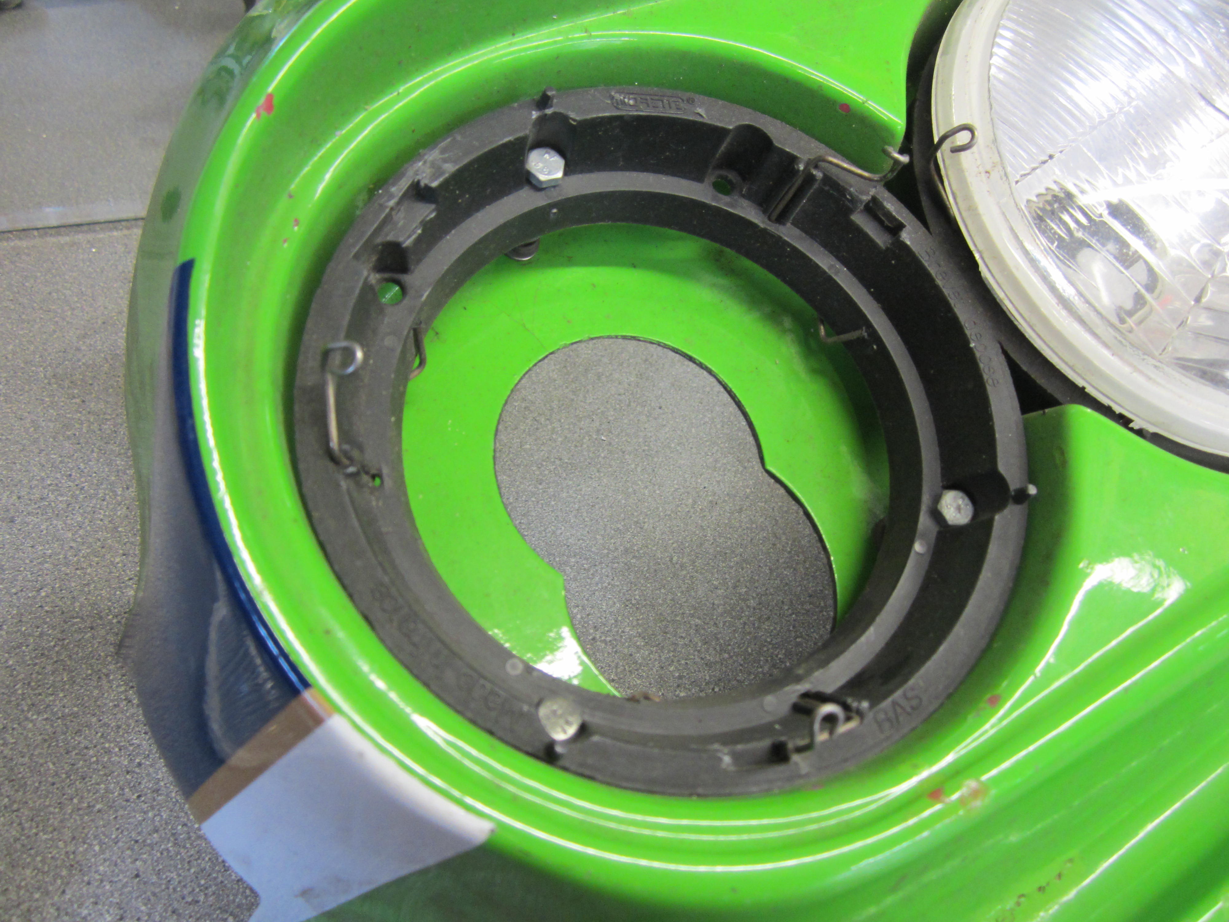

I think i`ve got an old one of these fairings in the loft , I`ll try and dig it out when later .
As far as i remember the light units clip into a black plastic mounting ring and the adjusting screws then mount to the fairing .
I`l have a look to see if i still have it and take some pics.
Mick

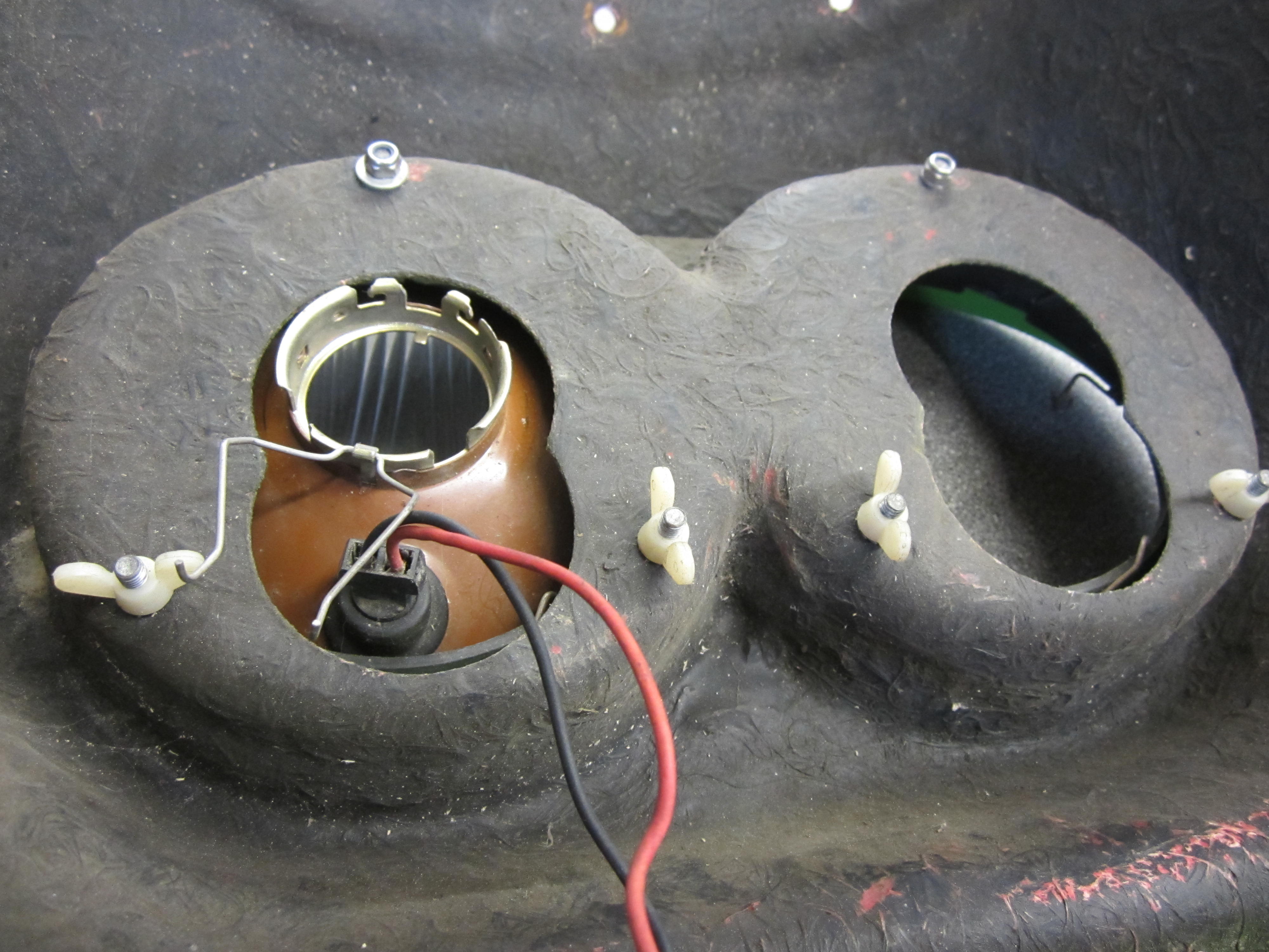

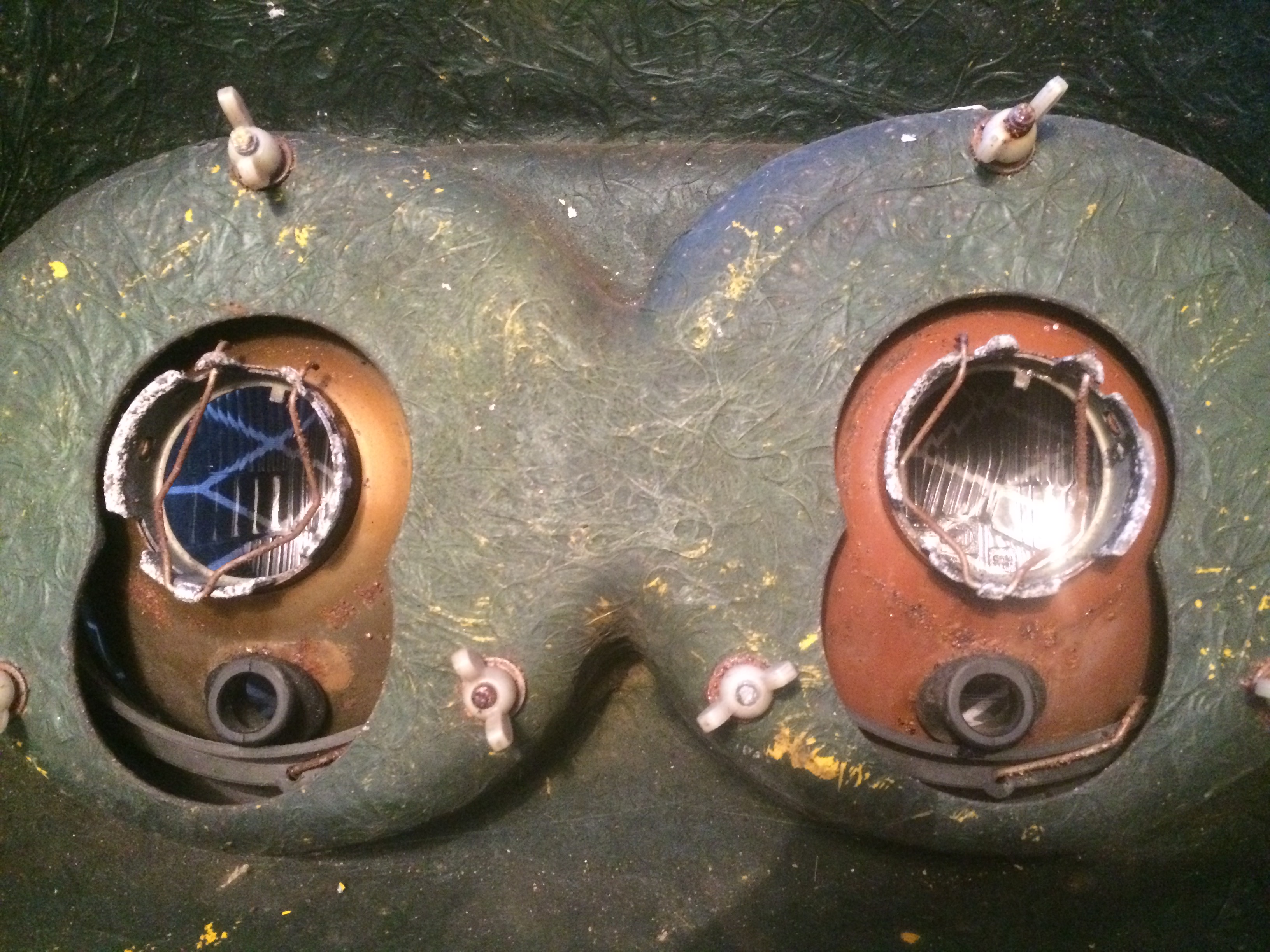

Re: Twin headlight fairing lights
#18 PostAuthor: sockpuppet » Wed Mar 27, 2019 10:19 am
download/file.php?mode=view&id=11450
download/file.php?mode=view&id=11451
The lights clip in with the three spring loops , light adjust via the wing nuts at the back.
Regards
Mick

Sock puppet, i sincerely thank you for taking the time to get those images for me. They have revealed all the secrets that i needed answering. I owe you lots of beers if we ever meet up!!! I can now purchase them, made by Moret, French company:These are the ones:

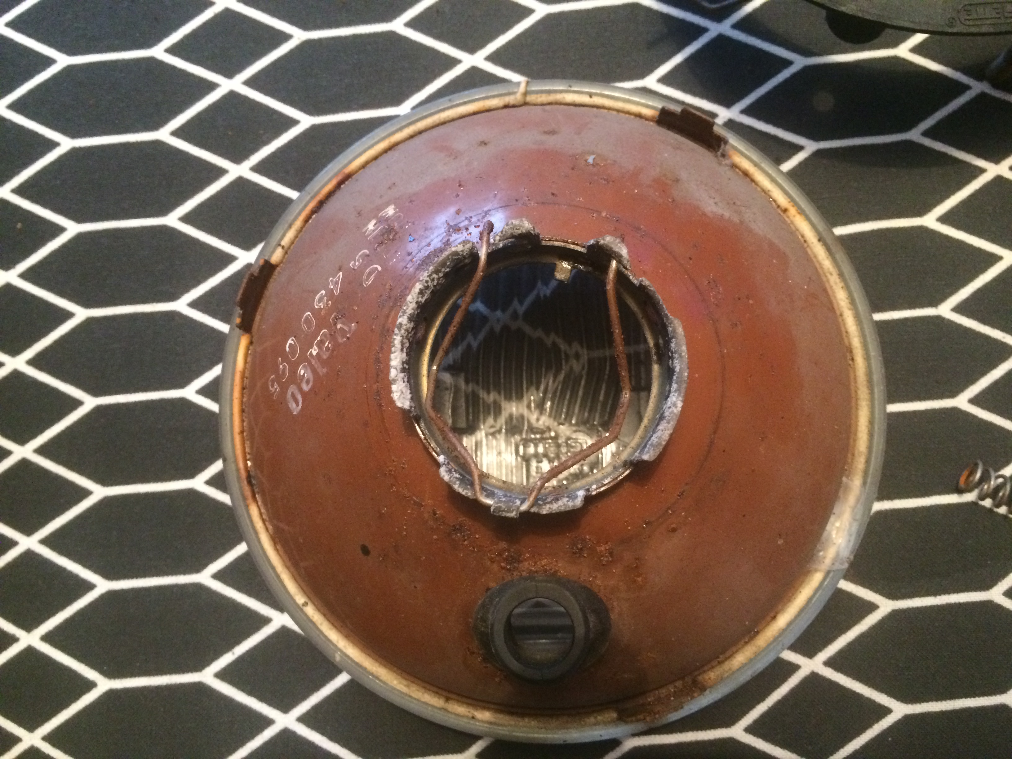

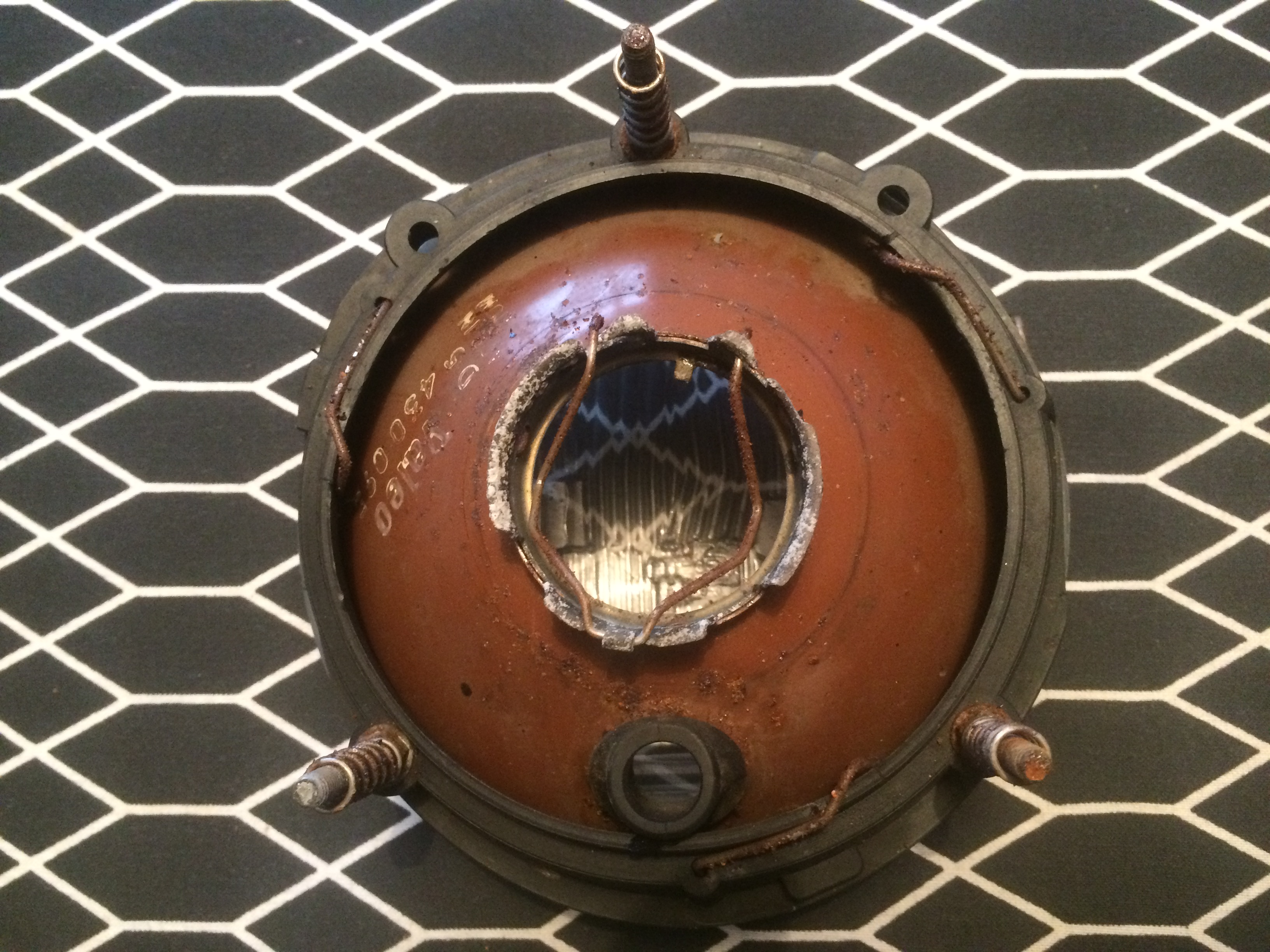

Mick (sock puppet) would you please take a few images of the back of the Cibie headlight. That will show how they connect to the Morette ring. The Cibie's from Demon Tweeks are not Cibie's but Hella's instead, even though they are advertising them as Cibie's :roll: and they don't fit and the side light is offset :roll: . Sourcing the right Cibie's would be so much easier if i knew what they looked like from the back.

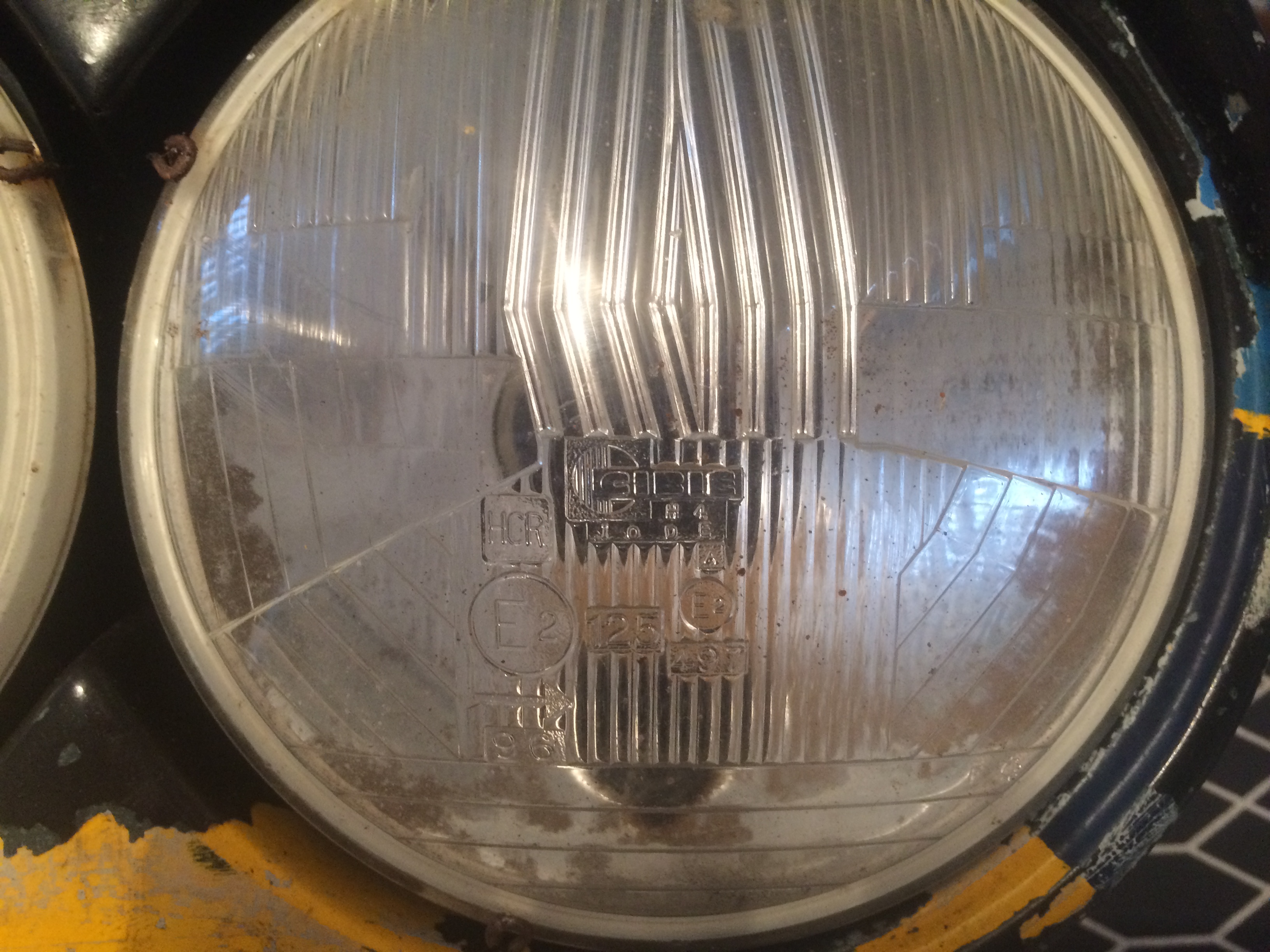

Chrisu, if you have any images of the rear of your Cibie's then that would help too, please.
#25 PostAuthor: Gus » Fri Apr 05, 2019 6:12 pm
Hi Scott
Hope these help

#26 PostAuthor: scott » Fri Apr 05, 2019 6:22 pm
Thanks very much Gus, really appreciated.
Unbelievably, Morette called me today and said they could provide exactly what I need, both holders and headlights. :bng :bng :bng :bng :bng
