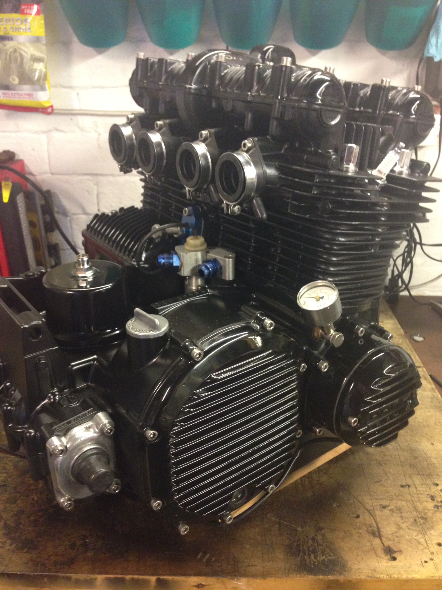

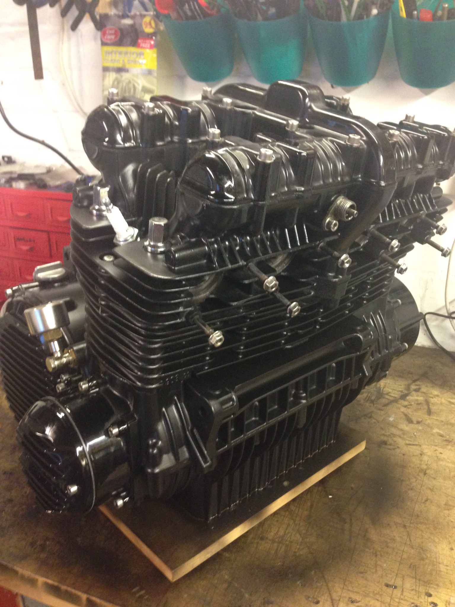

#18 PostAuthor: Padders » Sun Mar 17, 2019 4:32 pm
I have always used Simoniz tough black as Rob says the more coats you use the shinier you can make it. Engine in the photo was painted with this paint and the cases powdercoated.

#19 PostAuthor: dougie1 » Mon Mar 18, 2019 9:05 am
Looks proper tidy.

#20 PostAuthor: Adrian90s » Mon Mar 18, 2019 7:23 pm
Thanks for that Padders, gives me a bit more confidence
