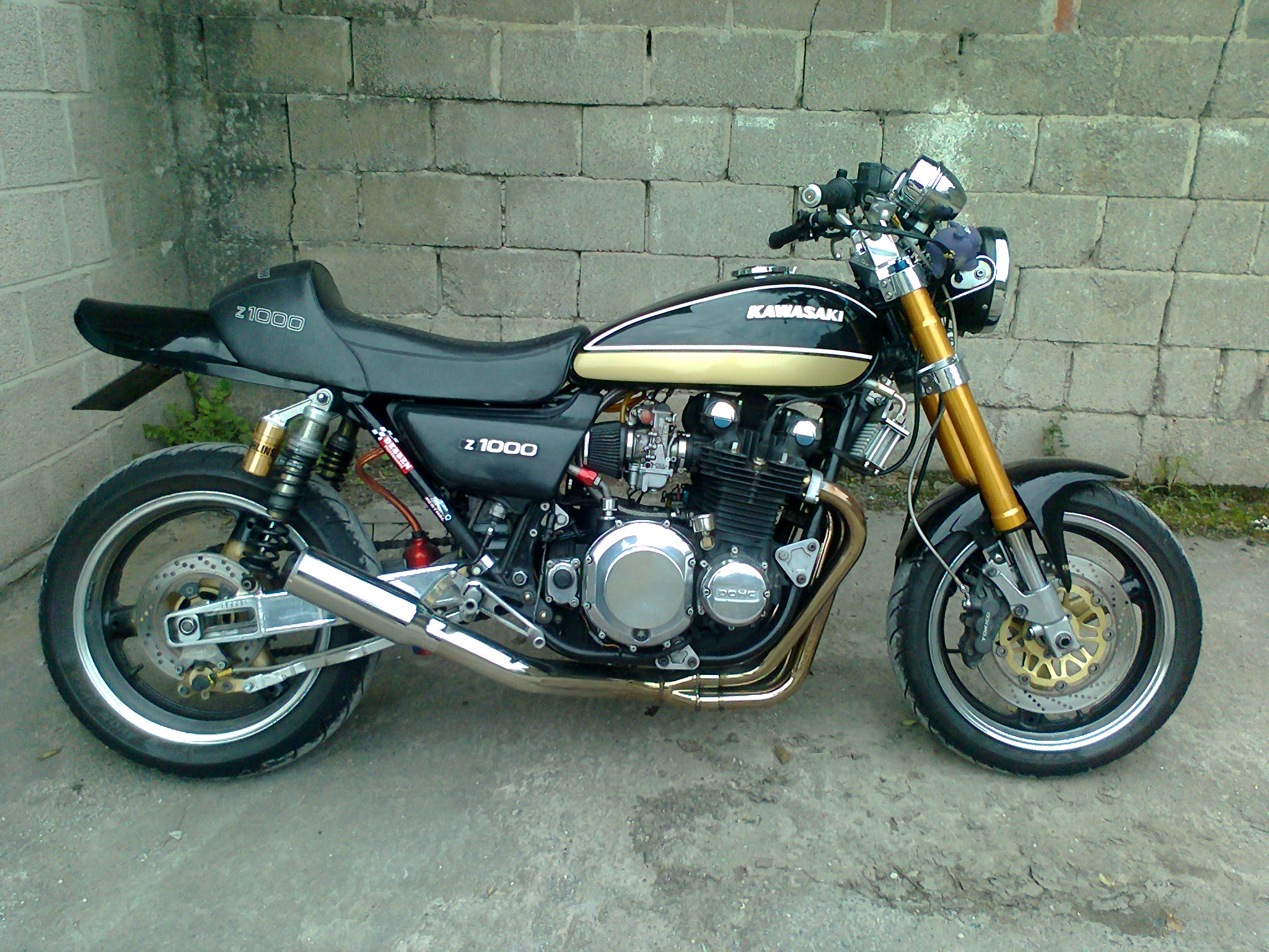

My old Z1000 was 1075 Wiseco - 10,25:1 comp, flowed headm std cams! RS36 carbs and ran great with measured 90bhp.
Slot some 395 cams in you'll be near 100bhp - I ran 11.5/120mph 1/4's easy enough & did 1000's mile on it with no problems!
Loved that old beasty

Pigford wrote:1075 is besterest option all round me thinks.
That's gorgeous
