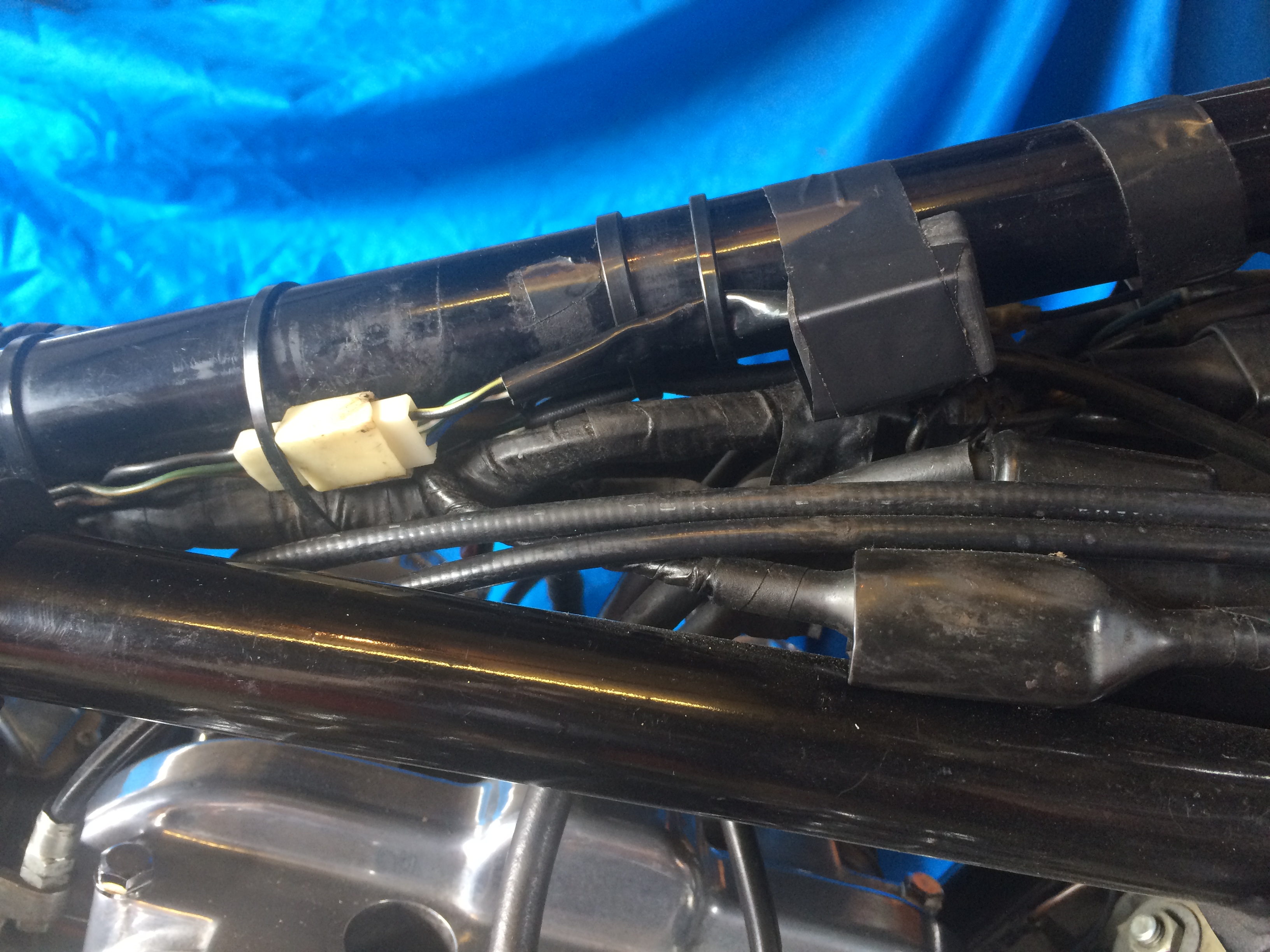

Well, the NOS Z400 brake light switch relay (28019-002) arrived this morning and I've just fitted it and it works fine; comes on with front and back brake and also flashes with the bulb removed so I'm a happy bunny and I've just ordered another one as a spare! :D
The fitting is a bit Heath Robinson until I sort out a bracket:
Andrew

The bracket hangs under the RH coil mounting bolt on mine & gets in the way when you take the cam cover off. Let me know if you'd like a picture of the bracket?

cancunia wrote:The bracket hangs under the RH coil mounting bolt on mine & gets in the way when you take the cam cover off. Let me know if you'd like a picture of the bracket?
Thanks, that would be useful as I was wondering where/how it fitted.
