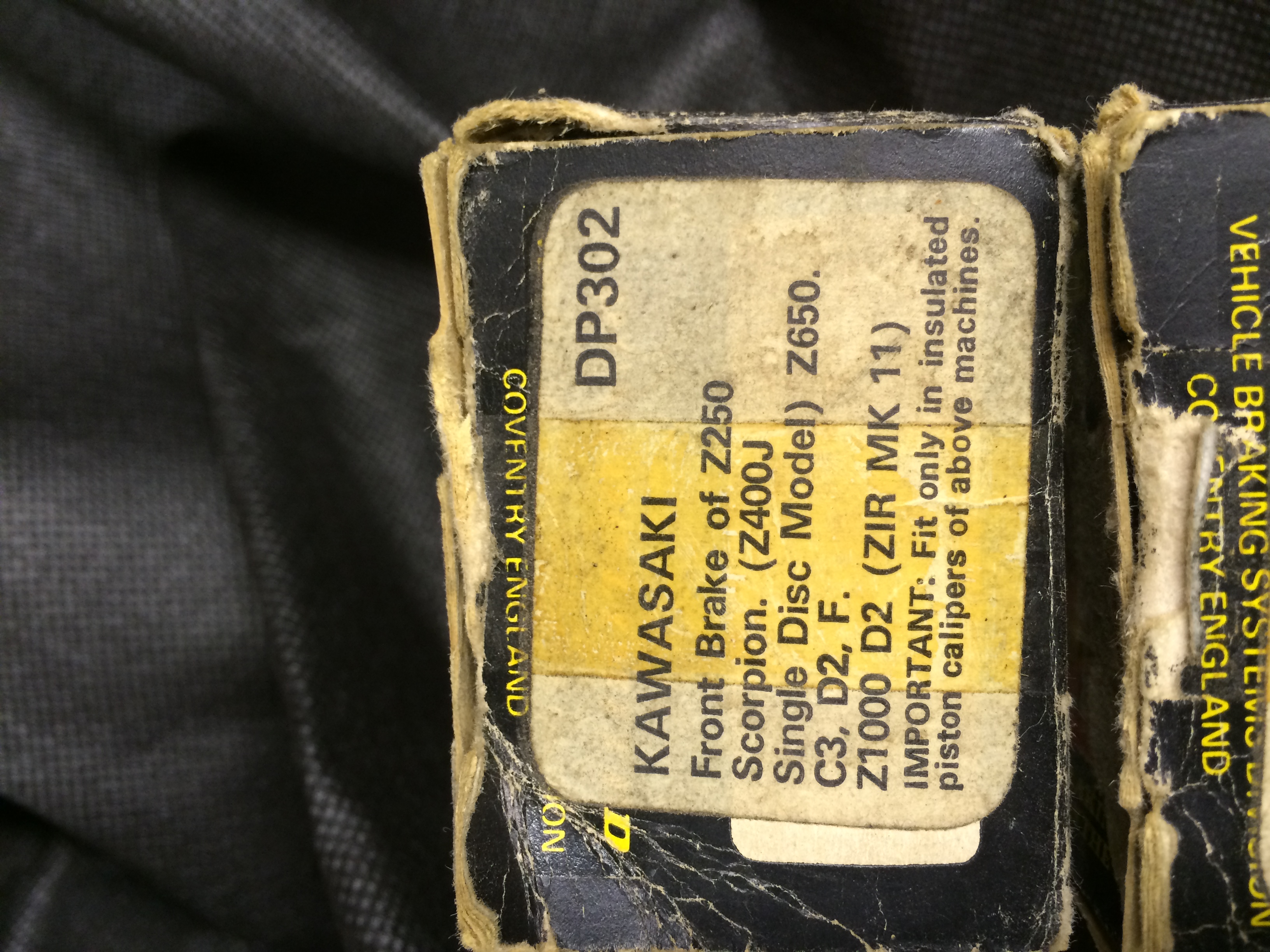

Re: Brake Pad Thickness
Excellent information, thanks. The first 550 had the same front end as the 400j but only for 1 year (the A1). The Z-Power listing looks like this:-
http://www.z-power.co.uk/z400500550/front-disc-pads-fa33
It shows the 550 in this list as well as Z650, Z1000A etc. This listing mentions the thickness and suggests either 73 or 33 'for a thicker pad':-
https://www.z1enterprises.com/brake-pads-ebc-fa73-kz900-1000-kz650-750-front.html
I wouldn't care about the thickness but the size of the surface area is different on my old pads. Here's a full cross reference listing both EBC 73 and 33 and all the bikes they supposedly fit:
http://www.rawpowermotorcycles.co.uk/armstrong-gg-performance-brake-pads-fa033-fa073-c2x14538522
I've now found a further set with chamfered edges that look the same as the ones in the factory manual. That's 3 sets for 1 caliper!
Yes, the disk size would explain the thickness difference. The surface area, I think, is down to manufacturers. The pad I put in there after the rebuild was an Armstrong and these have a steel backing plate on the outer pad as well as the usual plate with screw thread for the inner pad.
This style also seems to be used by Kyoto. I've no issue with that but the friction area is smaller (there is a 1-2mm inset from the backing plate to the friction material all round). This now means grinding the disc or waiting for the ridge to cut a ledge in the new pads.
