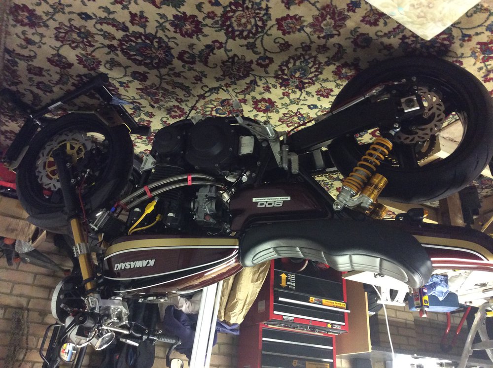

I've got a P&M race bike with original to 1980 69.5mm yoshimura pistons and cams. I believe the bottom end is 1000 and the barrels are 900 bored to 1001cc.

Pics of your engine would be good to determine what you have.
