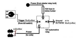

#4 PostAuthor: Strebe » Mon Mar 19, 2018 12:41 am
If you google “ wired George coil mod” you should find a site that will give you instructions. If you copy and paste the link below, it should work too.
https://www.wgcarbs.com/index.php/using ... s/89-coils

#6 PostAuthor: ZedHead » Mon Mar 19, 2018 7:28 am
Me Dave :D
As said wired George mod. I will try to put some engrish instructions on my website.

#7 PostAuthor: KeithZ1R » Mon Mar 19, 2018 7:29 am
when you buy a relay and this one will do it
http://www.vehicle-wiring-products.eu/p ... with-diode
the diode whilst not mega important is an extra security blanket if you have electronic triggering
