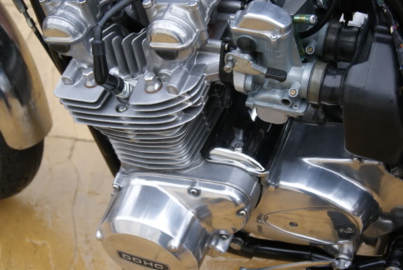

Don’t want to have highly polished alloy but would like to take some of the darkness out of the engine.. close to factory fresh as possible
Re: What you been using to clean engine alloy..
#2 PostAuthor: Garry.L » Sun Feb 18, 2018 6:32 pm
Elbow grease....
I cleaned up this A4 lump, but didn't wan't to go too Bling (not like me :roll: ) as the bike was very original and unrestored...
Depends on how much Patina you wan't to leave (if any) I used Putoline Chain Degreaser and a Scotchpad wrapped around a screwdriver to clean the block/fins, but as said it takes time and effort.

That’s the look I am after , time patience not an issue ... enjoy that sort of shizzle

Maroon Scotchbrite pad and brake cleaner. I have read that Steve Smethurst suggests carb cleaner for aftercare degreasing but i am lead to believe that brake cleaner is kinder to rubber seals. Either way, just spray on and wipe off before it dries.

Had a go with the scourer and some degreaser... hard going my hands are a mess but I am chuffed with the results... clean and not to bling, hopefully factory ish
