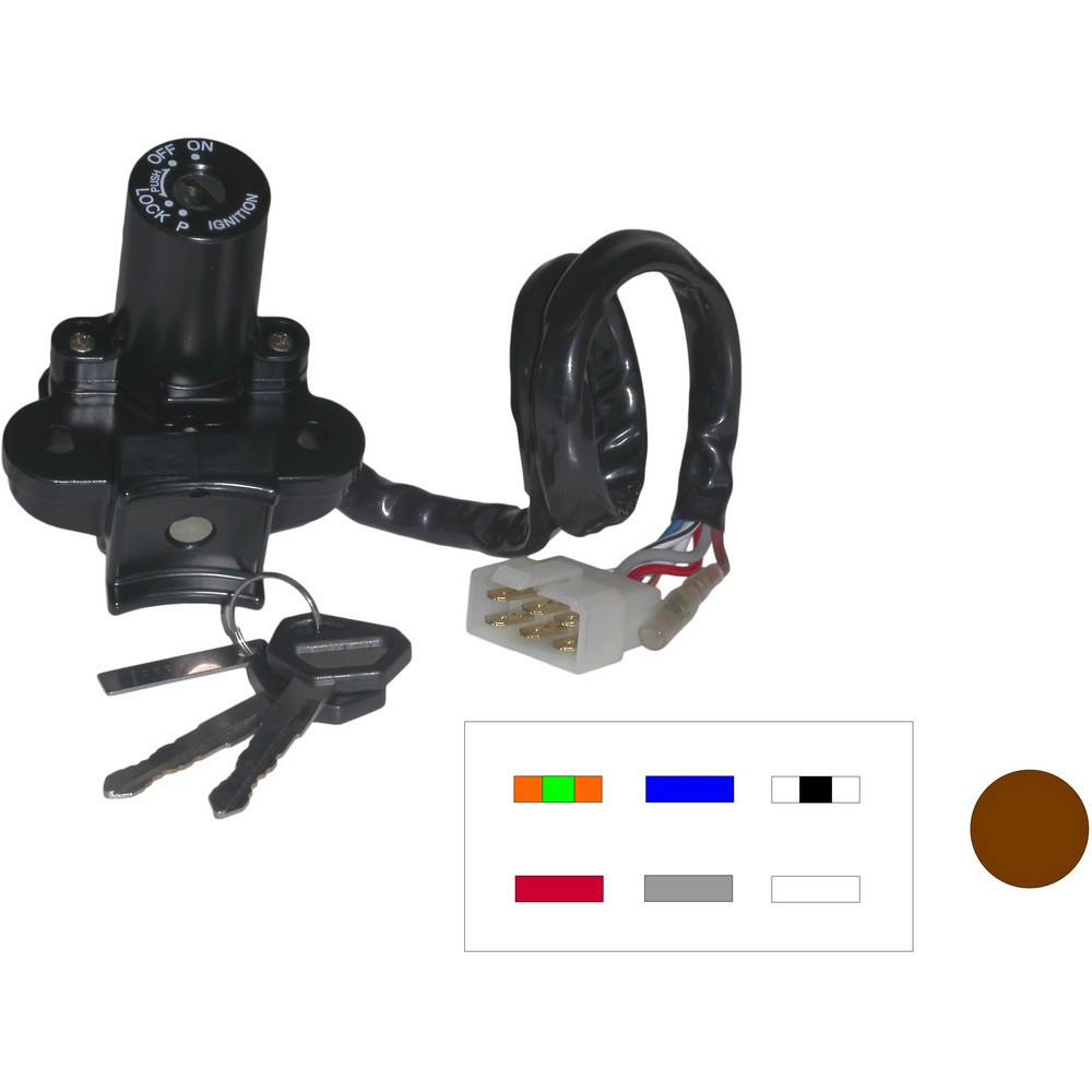

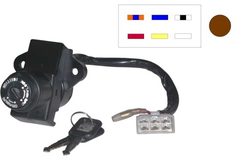

does yours look like this? or has it got the longer lock stem ?
www.ebay.co.uk/itm/Kawasaki-Z1000-J-Pol ... 007239123&
rickm
Posts: 473
Joined: 8th Aug 2017
Location: Kent
Re: No spark on 1000J – Fitting Dyna S, advice needed
#19 PostAuthor: rickm » Mon Jan 29, 2018 5:19 pm
z1bman wrote:does yours look like this? or has it got the longer lock stem ?
http://www.ebay.co.uk/itm/Kawasaki-Z100 ... 007239123&
Mine has the longer stem with the steering lock bolt that comes out vertically from the bottom.
It has a similar wiring set-up as that pictured in post #16 above.

This looks to have the longer stem.

#23 PostAuthor: z1bman » Mon Jan 29, 2018 5:41 pm
i would say its this type with the steering locking pin in the vertical position ?
https://www.ebay.co.uk/itm/Z%C3%BCndsch ... 1438.l2649

#24 PostAuthor: rickm » Mon Jan 29, 2018 6:25 pm
z1bman wrote:i would say its this type with the steering locking pin in the vertical position ?
Yep, that's it, but I refuse to pay that much for one !

#28 PostAuthor: rickm » Mon Jan 29, 2018 7:53 pm
Seems like mine is not salvageable. It's clearly been butchered in the past, and is never going to go back into any sort of reliable working order.
z1bman wrote:https://www.ebay.co.uk/itm/81-KAWASAKI-KZ1000-KZ-1000-K-OEM-IGNITION-SWITCH-ELECTRICAL/382344434504?ssPageName=STRK%3AMEBIDX%3AIT&_trksid=p2060353.m1438.l2649
This is the bit :up
Might give it a go.
