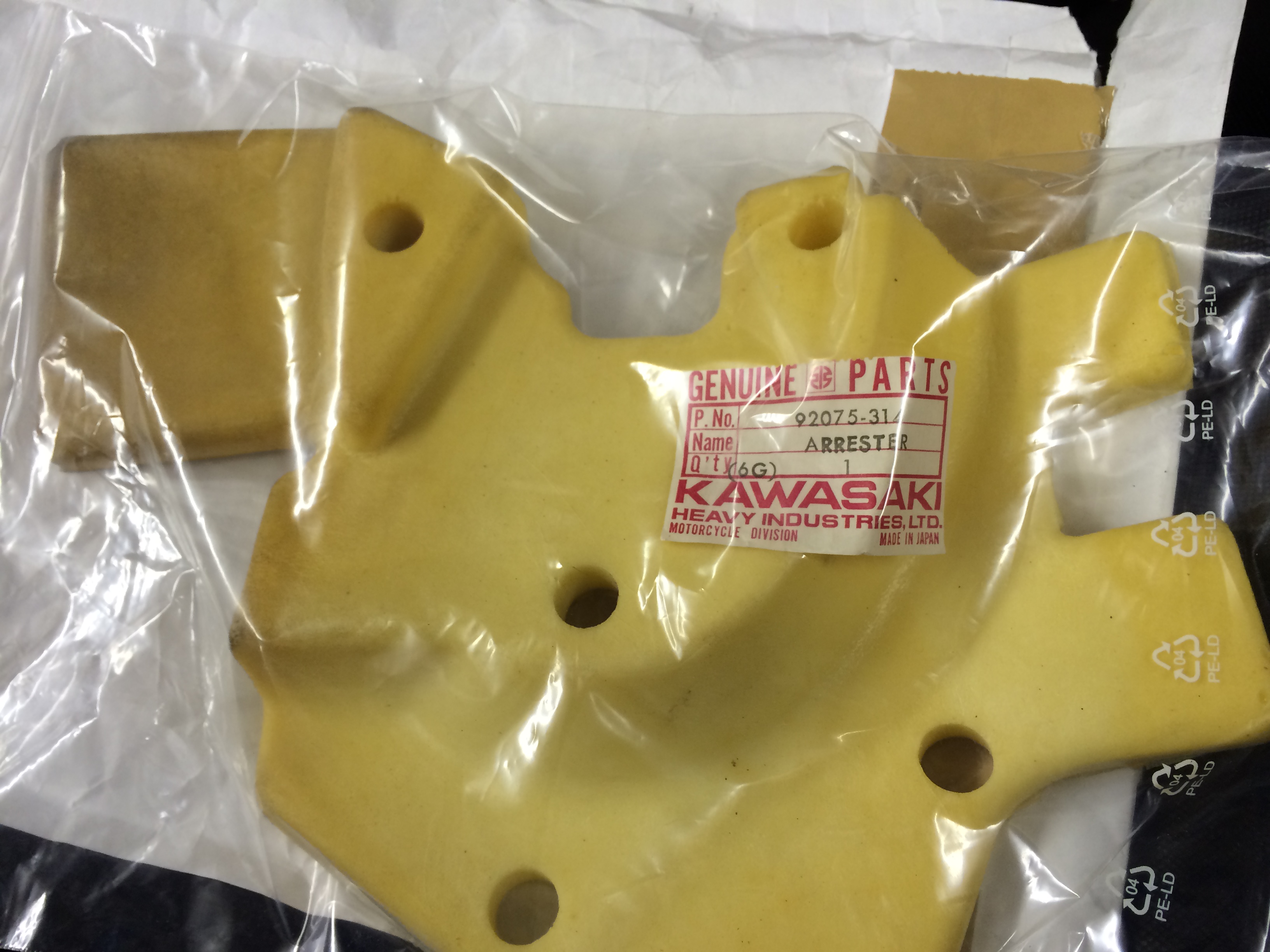

no it has a foam damper which is held in place by a steel cover & not the same as z1/ z900

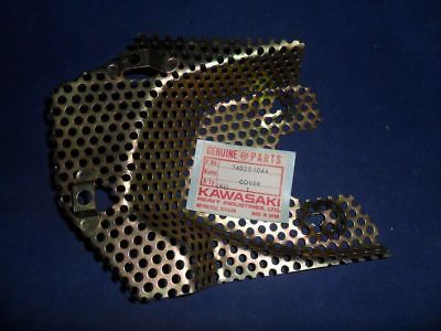

z1bman wrote:no it has a foam damper which is held in place by a steel cover & not the same as z1/ z900
you should have a sound arrester cover and damper
https://www.ebay.co.uk/itm/NOS-Kawasaki ... 1438.l2649

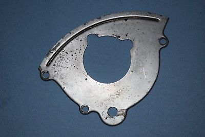

#5 PostAuthor: zed1015 » Fri Feb 02, 2018 3:13 pm
You mean this.
All my Z1R's had them.
If you haven't got one i'd fit one as it keeps all the crap from the chain spreading all over the clutch mech etc.
Posts: 4690
Re: Z1R Sprocket Cover
#6 PostAuthor: z1bman » Fri Feb 02, 2018 3:32 pm
zed1015 wrote:You mean this.
that part 14024-008 is only fitted to the z1 / a/ b / z900
compo z1r
Posts: 1179
Joined: 25th Sep 2008
Location: SQUIRES NORTH YORKS
#7 PostAuthor: compo z1r » Fri Feb 02, 2018 3:47 pm
s-l500 arrester cover.jpg (19.97 KiB) Viewed 4387 times
z1r

Mine has the foam and the perforated metal cover in good nick but doesn't have the thin metal guard. I can't see one on he parts diagram either. Pretty sure this has never had one fitted as everything else seems to be on here which is normally ditched.
