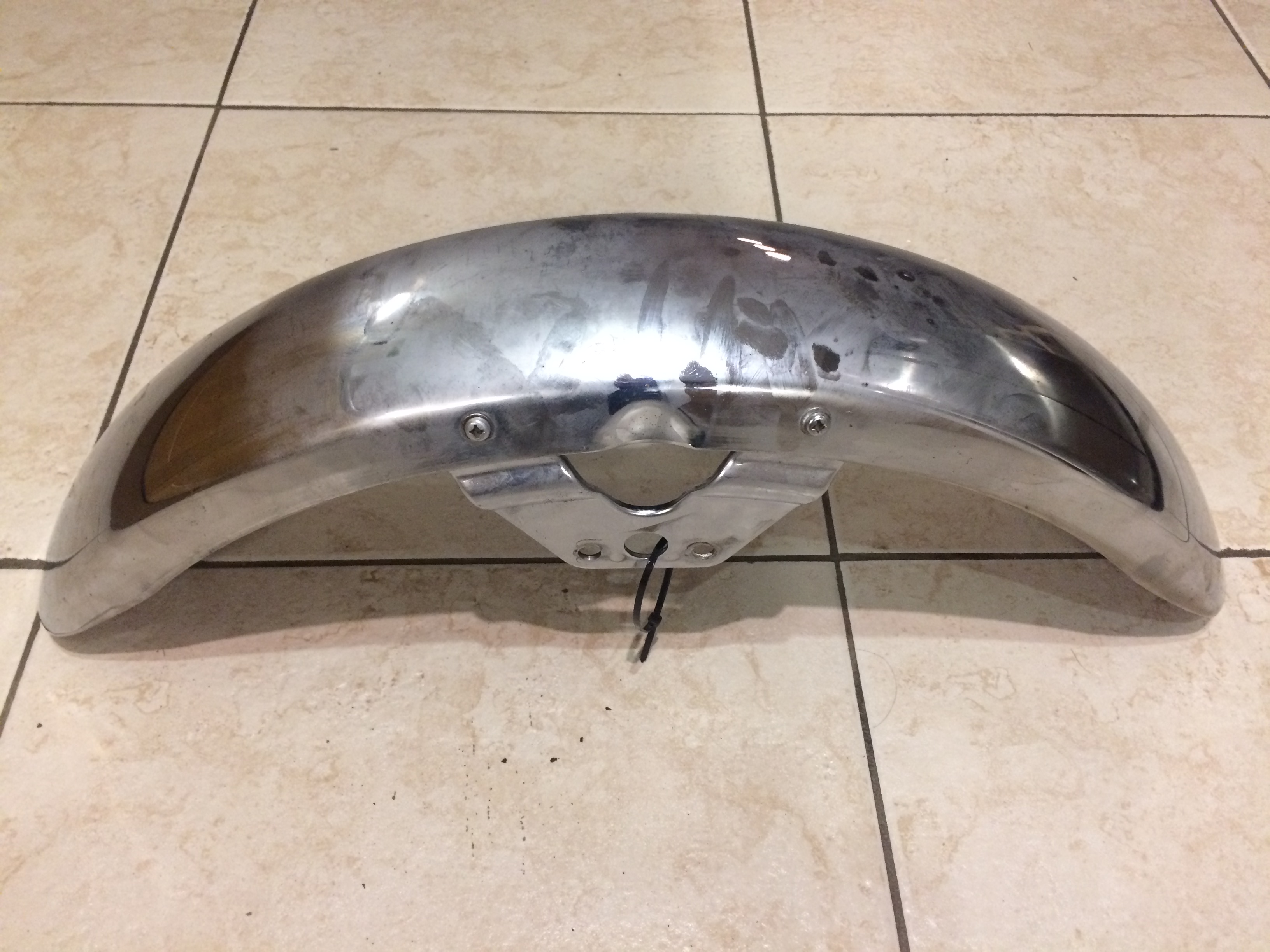

Can anyone help me identify this front mudguard that came fitted to my KZ1000A1? It fits well and seems to be good quality but I'm beginning to doubt if its even a Z1000 part as the others I've see don't seem to have the two screws each side holding the bracket to the guard like this?

#2 PostAuthor: z1bman » Fri Jan 26, 2018 8:23 pm
it looks like a kh 500 fender

#3 PostAuthor: hartyb » Fri Jan 26, 2018 8:26 pm
I will be interested in any ones thoughts as I have one that may well be the same that was fitted with a 19" wheel on the Z1R with wrong clothes, My guess with that one was it may possible be Z650 if so still worth a few penny's

#4 PostAuthor: z1bman » Fri Jan 26, 2018 8:40 pm
z650 mounting bracket is riveted on. kh 500 is held on with screws.

#6 PostAuthor: Blackseven » Fri Jan 26, 2018 8:58 pm
Thanks very much - great info! Hopefully I can get a few quid for it towards the cost of the correct part.

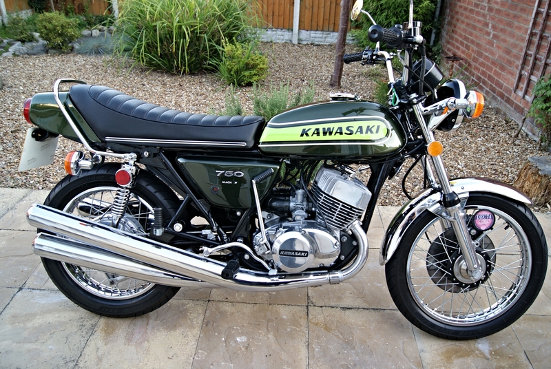

#7 PostAuthor: Garry.L » Fri Jan 26, 2018 9:33 pm
..... or H2.
My old H2B.
Posts: 4690
Re: Mudguard Identification
#8 PostAuthor: z1bman » Fri Jan 26, 2018 10:08 pm
[quote="Garry.L"]..... or H2.
My old H2B.
h2023_zps2522b453.jpg[/quote
kh500 & h2 fenders are the same part
