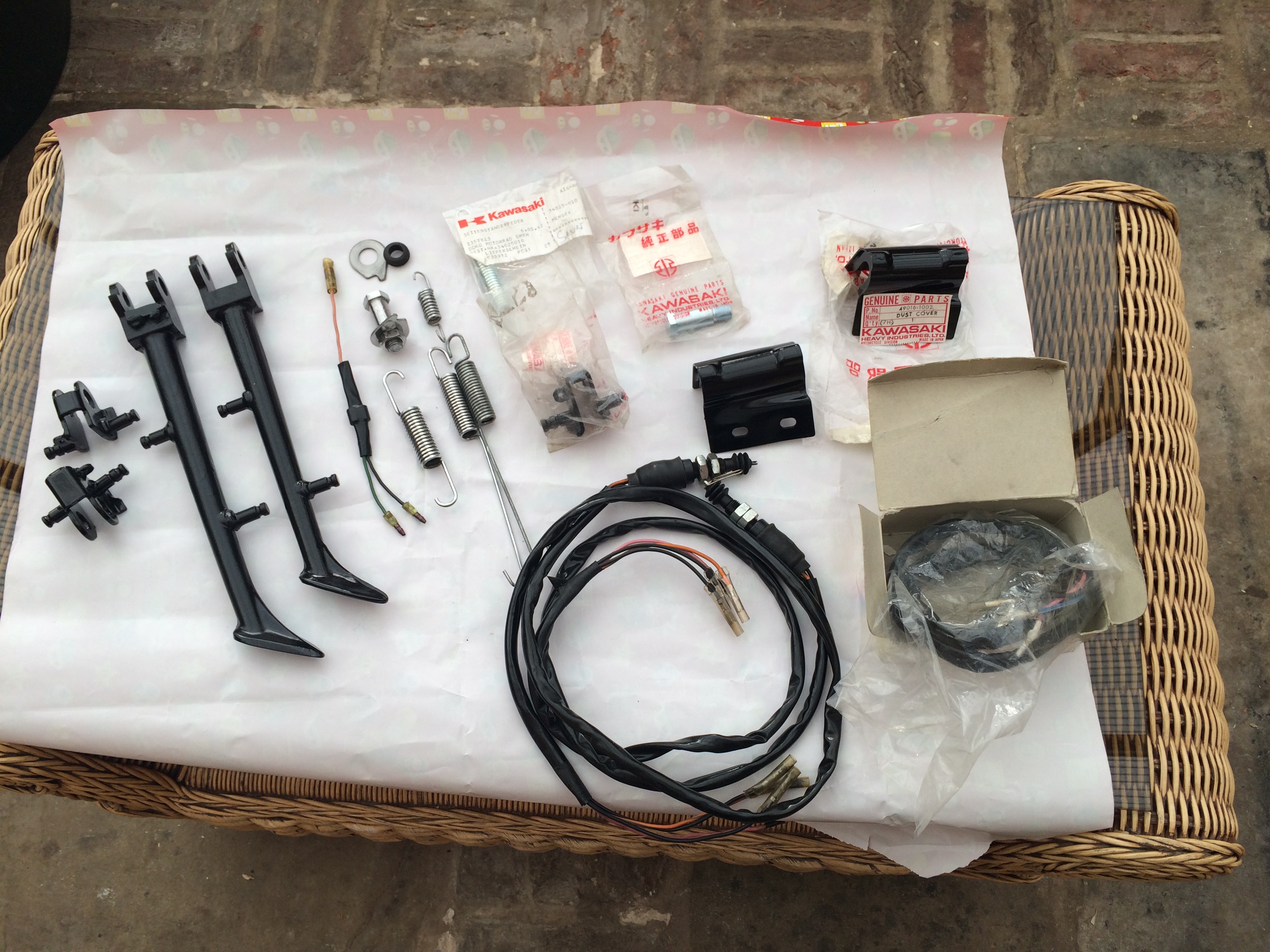

Is all the extra parts in 3rd pic the dreaded side stand switch bits?

Is all the extra parts in 3rd pic the dreaded side stand switch bits?[/quote]
yes it is ross and there's a few other bits missing from that photo and the like
