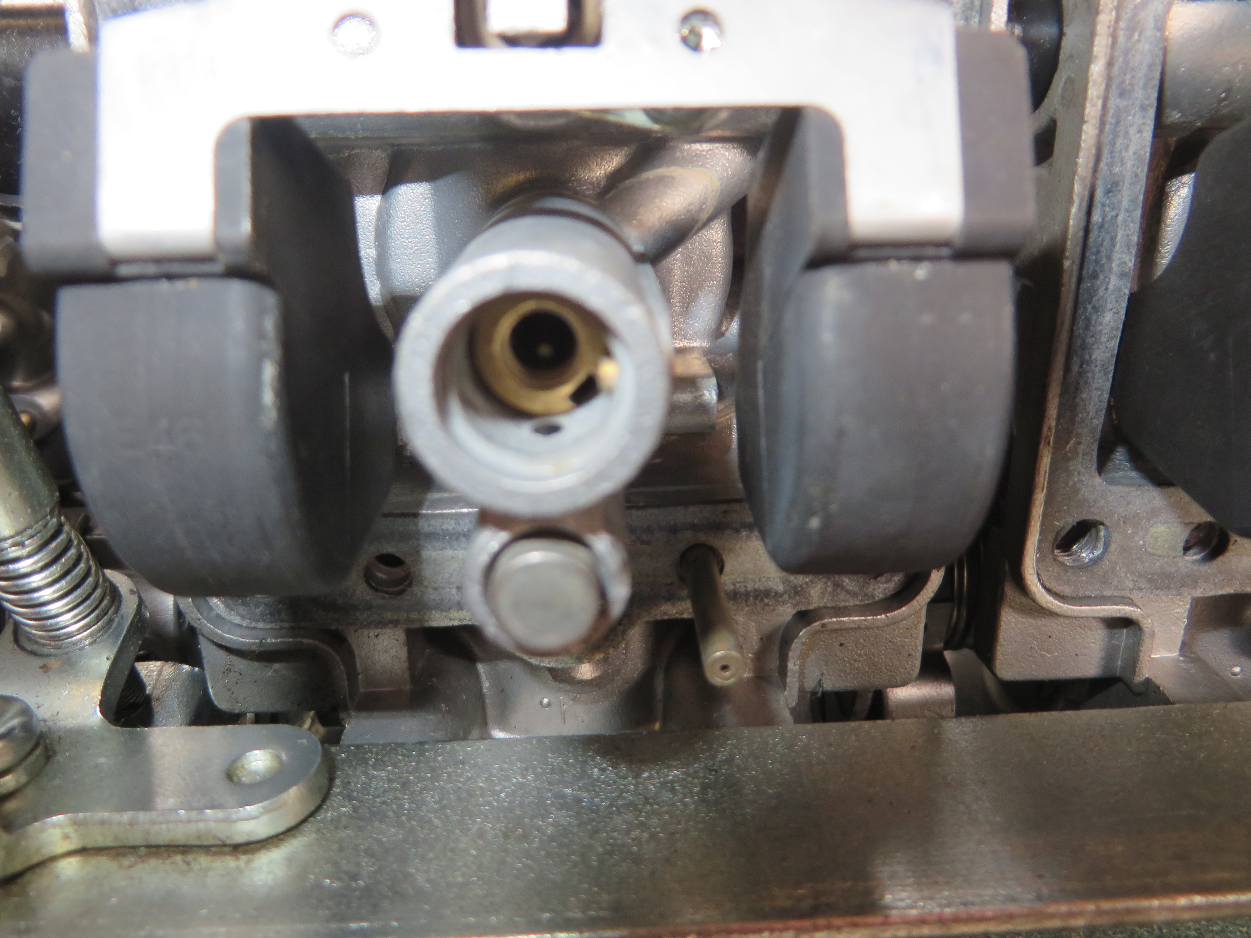

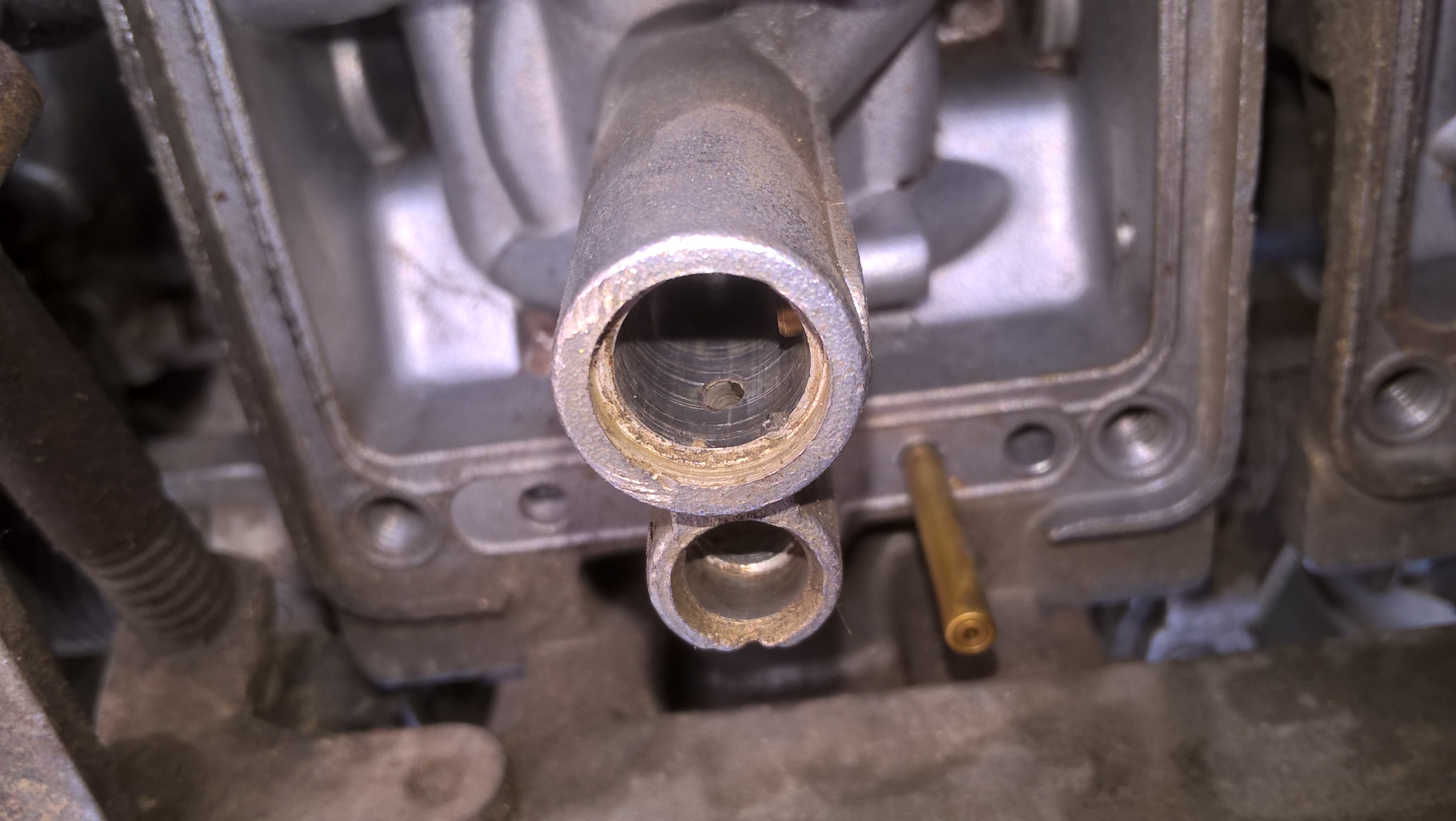

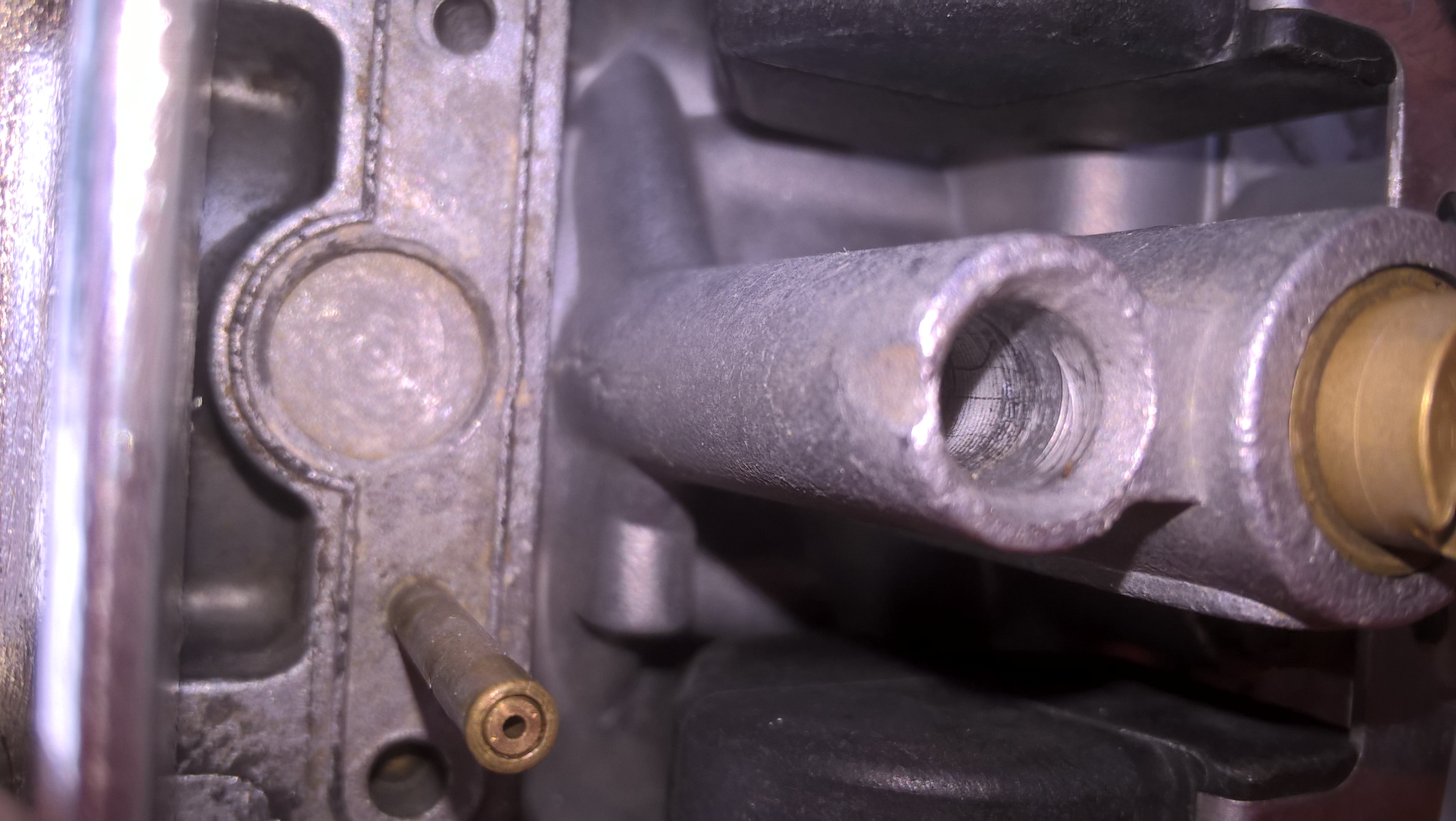

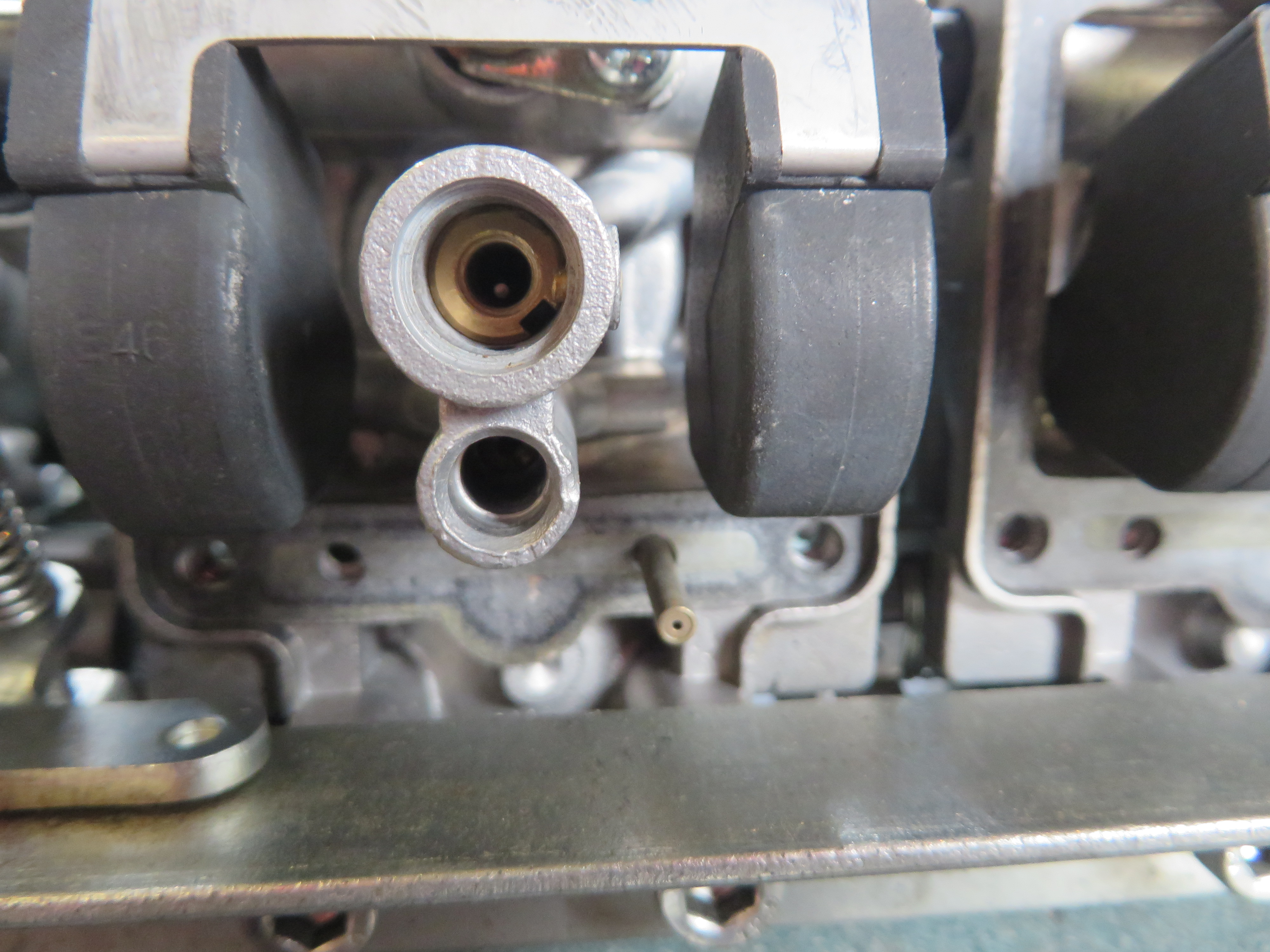

I have added two photos of the two different sets of Carbs that I have got.
As you can see one has a connecting hole and caps, the other doesn't have a connecting hole and didn't have any caps.
Is it as suggested that one might be for the 1100R2? If it is maybe a previous owner upgraded them.
Any advice would be appreciated.
Stu
Carb with the connecting hole
Carb without the connecting hole

#19 PostAuthor: Al » Mon Apr 17, 2017 1:20 pm
Here are some 1000J carbs for comparison. Going to be vaguely similar but there are many variants of the CV including those used by other manufacturers.
With plug and also have the holes as you would expect.

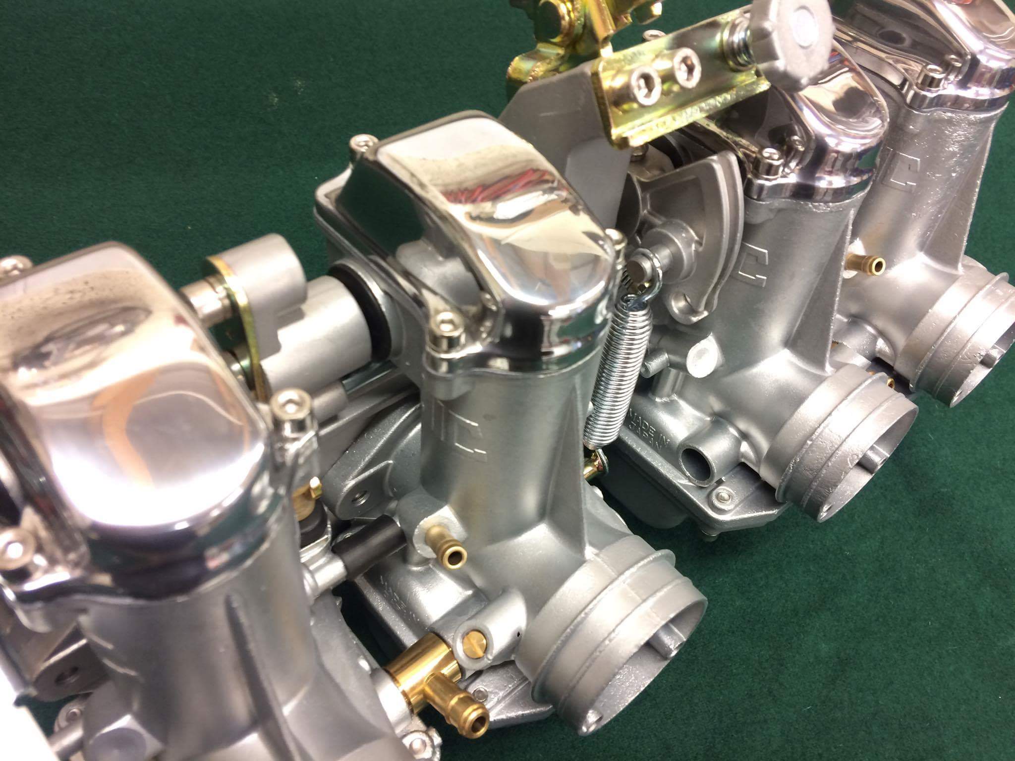

If your still having issues and would like the carbs referbed to as new standard. Ben Day at vapourworx is your man. He has acess to all the new bits needed including the very rare needles and emulsion tubes for the bs34.
Cost wise you wiuld be looking at approx £630.00
Heres a before and after pic of my z900 carbs he done for me.
Contact details can be found in trusted traders.
